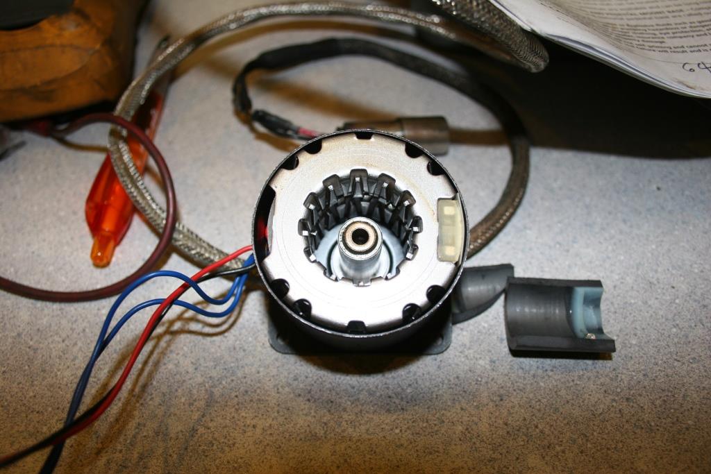

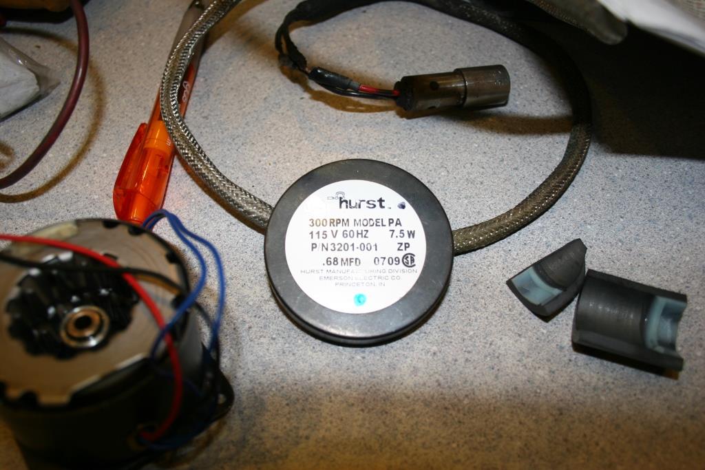

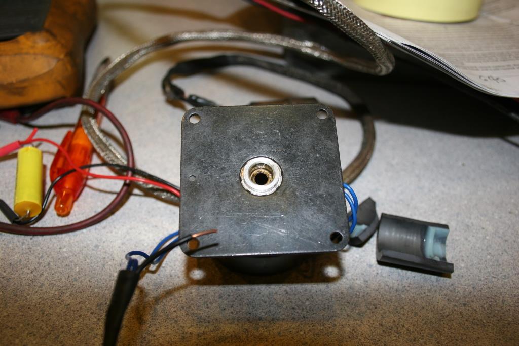

Here's some images of the "cracked" Hurst motor. Interesting....

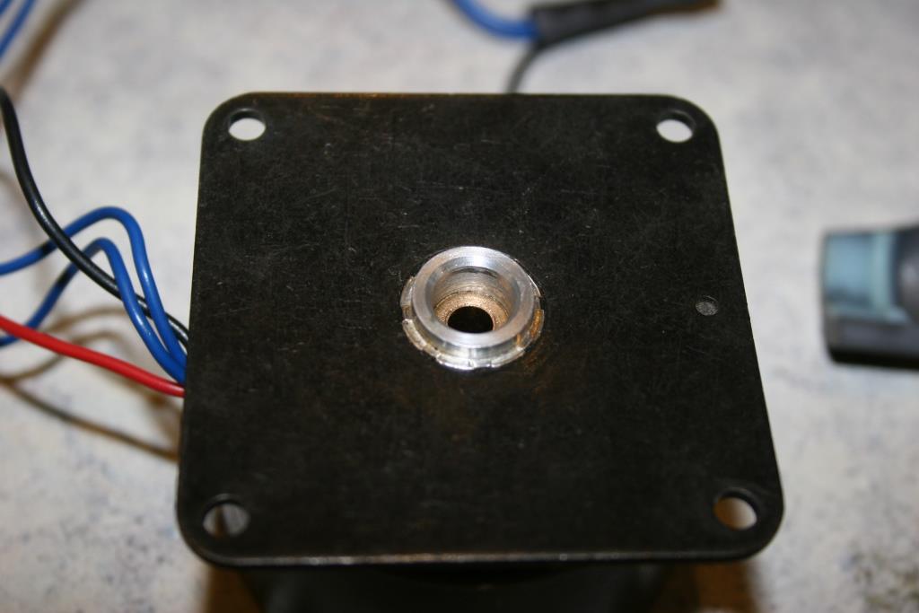

The motor shaft is supported only on one end by a single bronze bushing. My rough estimate is 1" (25mm) long. IMHO this long bushing supports the shaft well since it covers most of the length of the shaft and with the magnet on one end and the driven end at the other end it might be plenty of support. I would also assume that the bronze bushing is fine with proper lubrication. As long as it doesn't dry out, it should be fine and it would appear that too much lubricant would not be much of a problem as there are no brushes etc. in the motor to care. It might be an interesting experiment to fill up the motor with lubricant and see how it runs.???? We could call it hydo dynamic phase dampening or some such audiophile nonsense.

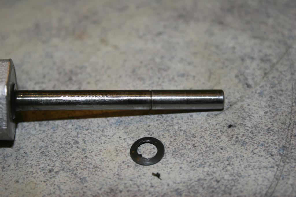

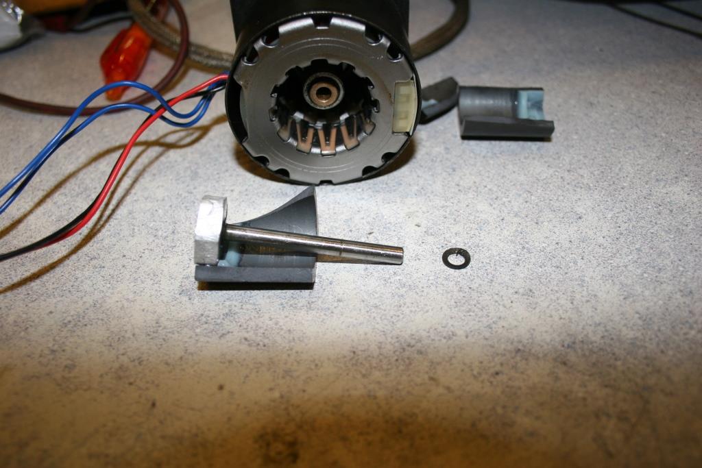

The shaft is retained in the motor by a one way washer, or spring washer. You can see in the image that the shaft has a groove machined into it to hold the washer. It is very difficult to remove the washer. We just hammered the shaft out of the motor which broke the magnet. The washer itself is not accessible since it sits down into a pocket or shoulder in bushing assembly so the only way to remove it is to destroy it, IMHO.
The retaining washer is the source of the audible noise that I have heard and others have reported about these motors. The washer will work as a thrust bearing on the end of bronze bushing and or rub against the inside of the bushing retainer pocket. I'm not sure how big a problem this really is.
Overall I'm impressed with the construction of the motor for what it is. The bushing arrangement is nicer than I expected, notwithstanding the thrust washer. I think the most obvious idea for improvement might be to improve the thrust washer design. For audio I would think the strong steel clip could be replaced by plastic or other material to retain the shaft for thrust.
I am also interested in the RA series of motors which have a larger shaft and the option for bushings or ball bearings and single ended to two ended shafts. Stefano has mentioned that he prefers smaller, lower torque, 24 V motors, but the larger motors might have better bushings or provide easier "hot rodding" of the bushings. If the perfect sine wave and phase generators improve the small motors, maybe they would solve the issue of the larger motor noise and cogging? enabling the use of quieter shafts and bushings.
Or, there is nothing wrong with these nice little motors??
Jamie

Arch,
Good question. I took a closer look at the retaining washer and the opposite end thrust washers and they both appear to be non-metallic. I can't tell what material. Maybe plastic. They are graphite in color.
I don't understand now why it is so hard to get the retaining washer to slip out of it's groove when removing the shaft, but metal circlip retainers have amazing pull out strength.
So, right side up and bottom side up running should be similiar in terms of the washer materials running against the ends of the bronze bushing, but in the case of bottom side up the washer has backing support by the end magnet plug and a bit looser fit around the shaft.
Right side up running would appear to have a lubrication advantage though.

Arch,
The spacing between the two washers is fairly tight. The retaining washer is held by the machined groove and the other washer against the magnet plug. So, It's a bit difficult to change the arrangement.
Again though, I'm not sure there's really a problem considering both washers appear to be a plastic or friction reducing material. Could even be graphite impregnated. Since it's relatively difficult to disassemble, re-assemble, etc., I would tend to think that there's a good chance of doing worse than the factory assembly and a lot of work to do something better. IMHO.

Is the washer that makes the noise I hear? How did you remove the shaft? Is the washer that holds the shaft in place? If so, is that maybe something that can be improved?
Or do I need to disassembled the motor more to get to other parts?
-9F here in Waukesha....woooo....it's flipping cold in WI!!!!![]()
I saw a squirrel raiding my bird feeder this morning...I'm guessing his nuts were frozen.
I believe it is the washer that makes the noise, but the washer is non-metallic. So, it could be caused by the longitudinal play of the shaft oscillating back and forth. I would need to play with a running motor now that I've broken one to see inside. I could also put it back together and look for longitudinal play in the shaft. I'll try that and report back.
