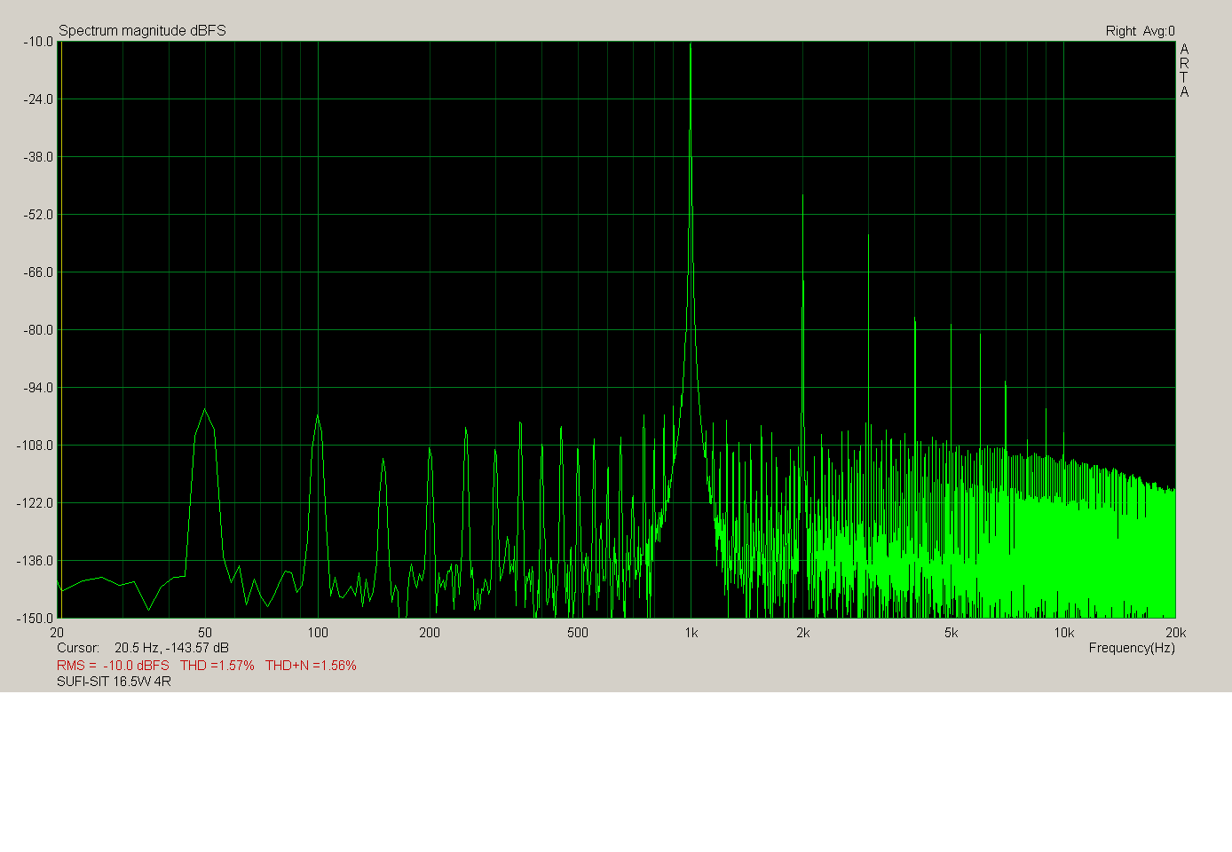

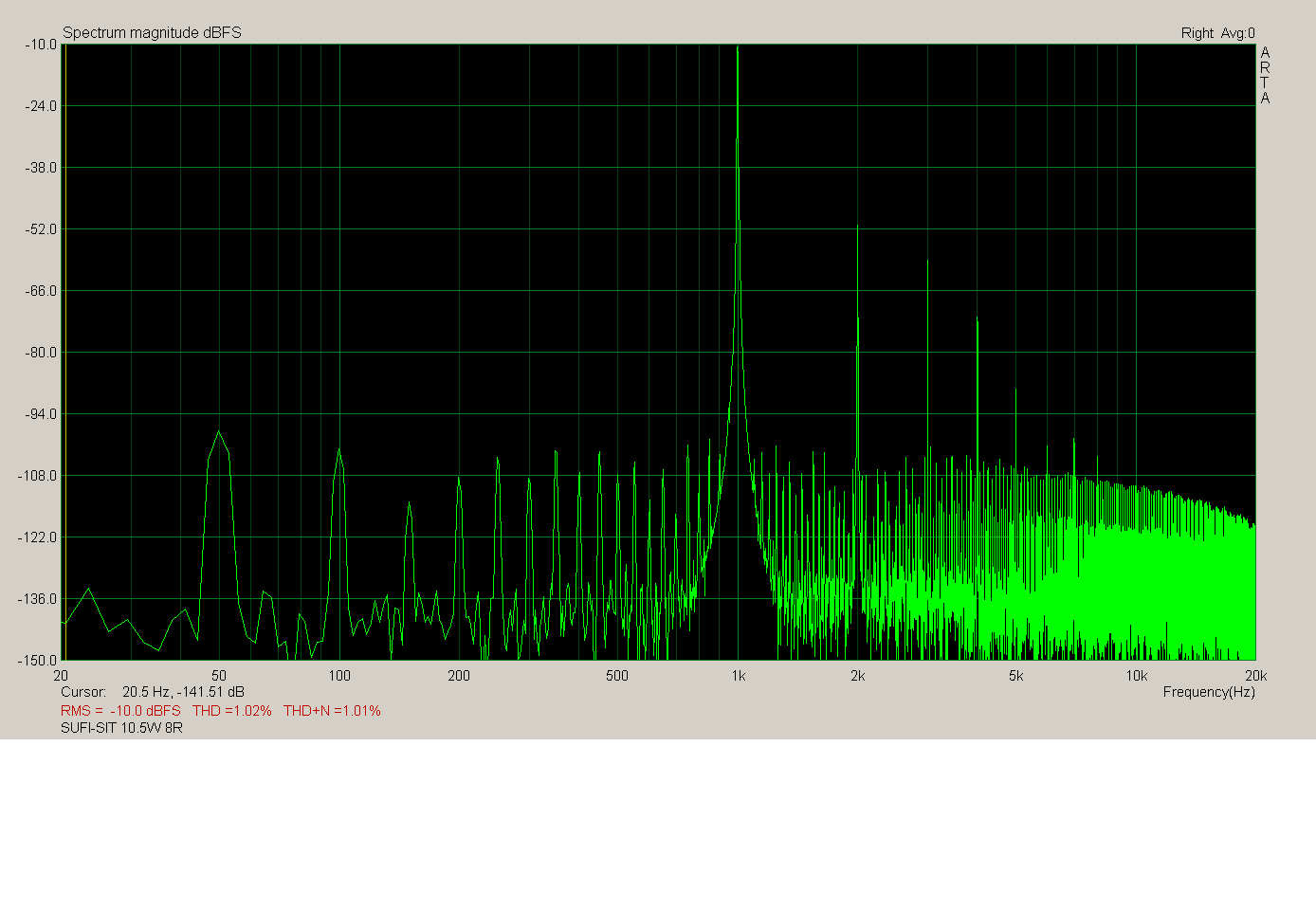

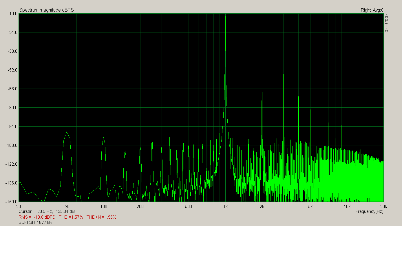

looking at graphs in SIT-3 user manual , and comparing them with THD values I got for SissySIT , I'm observing few things :
-funny , due to nature of PapaSIT , THD in 4R load is lower than THD in 8R load , while this is not the case with THF
-also funny - regarding THD , SissySIT is on par with SIT-3
few things more , to think of :
-should I measure THD spectra ( and whatnot) of ZM's DEFiSIT specimen , and what conclusions , dumb as I am , I can get from that ;
-should I try THF51-S in SEF amp cradle , so SIT being slightly tamed with some source resistance ...... I'm not scared of work involved , but grumpy of necessary critical listening later , to decide which one is better ......... hate critical listening ......... I like normal -greenaroundmyhead music enjoyment

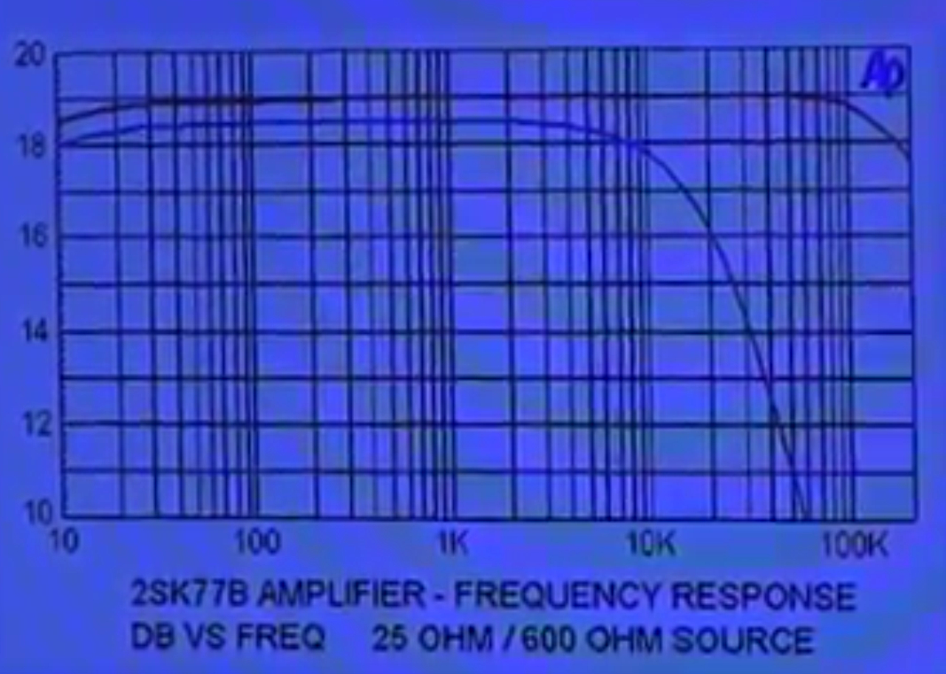

All " wild horses " 300 to 1K watt´s Tokin SIT's or hockey pucks IXYS mosfets input junction capacitance is high
, amplifier input needs buffer with 25 Ohm impedance output if not high frequency response roll off very quickly.
Cinemag, Jensen or Edcor transformers frequency response have his limits as well
Mr Pass talk about this solution presented similar 2SK77B Digital-Domain SIT, video starting 00:20:37
