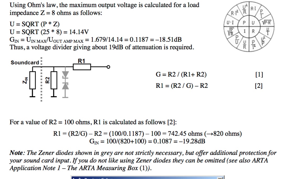

I can recommend for Windows
freeware: Visual Analyser with its visual analyses
of course the famous ARTA, a bit more complicated
or 30days trial: Multi-Instrument, a powerful multi-function virtual instrument software - Virtins Technology
It is always some work to get accommodated to a program like this.
You must dampen the signal going from speaker output and his 8 Ohm resistor load.
with a small resistor network.
reason, normal sound cards have their input limit at 2V and even measuring 1W at 8 Ohm demands 2.83V at an 8 Ohm load.
You find many hints for damping when you google "thd measurements sound card"
I add a picture from the ARTA manual.
R1 is 820R
R2 is 100R
so you get around 20dB damping.
