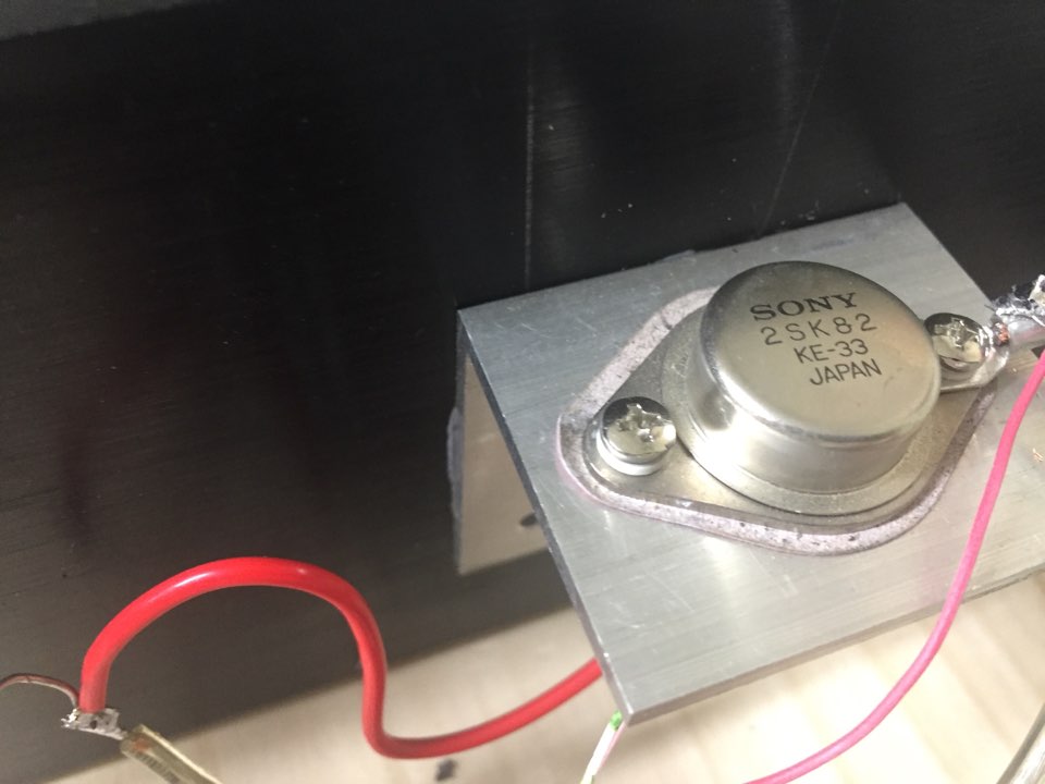

I do not know how to tell about the stability, but yesterday it was turned on for straight 3 hours or more. For total 45W dissipation per side, the temperature was high but it was reasonable (how do I know?) for the heat sink size. I was afraid of blowing up the 2SK82 and I touched the heatsinks from time to time. So I have peace in my mind. With no bias the current stops and this is good I think.

Hi sorento,
Do you have 2Sk82 KE-33? I used this one and they worked fine for two channels. I also replaced IRFPO9240 from a bag and they worked as it is with the same Source resistors. Not perfect, but works as.. imagined. 🙂
I also have some 2SK180 and when you find some solution with this please share the results. 🙂

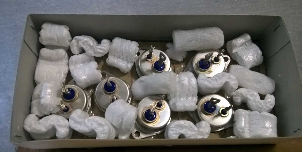

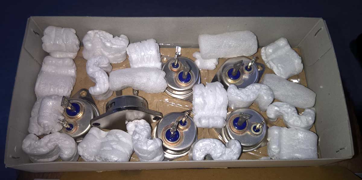

new arrivals - THF51-S , from watanabe.....-san
first batch of six , for buddy No.1
later expecting in a month or so to get the second batch of six , for buddy No.2
probably another day needed for finishing tidying up of my workshop , then slowly on testing them ....... first solo , then on T-Bed , in circuit

Today I checked my friend's 2SK82 KE-33 and confirmed that it's possible again with IRFP9240. 🙂 0.6 ohms Source resistor for both channels, up to 1.65A, Vds 16V, 29V supply.
But I want to hear that THF51 in DEFiSIT someday, in higher voltage and current! I also sent some THF51s and others to a gentleman in Germany for his fun..
