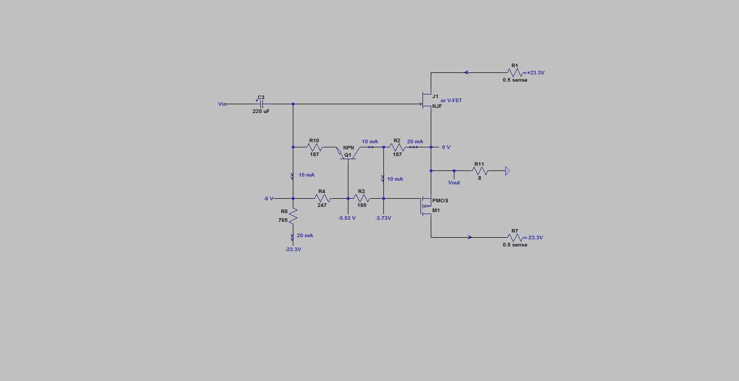

I am unsure if the attached schematic helps this discussion. I used one like it while experimenting with DEF. I do not recall reporting it; possibly because I thought it was not simple. In this example, it pertains to the condition when a large absolute difference between the Vgs of a certain R085 [or better yet SIT=2SK82] and that of IRFP9140 existed. In this schematic the example Vgs for NJF/SIT = -8V, and that of IRF9140 = -3.7 V
NPN in a common base configuration allows the input AC signal to reach the gate of the P-MOSFET in phase with it and especially not hindered [otherwise] by a large [biasing] resistor in series with its input capacitance [upsets its high frequency response].
I am unsure about possible positive/negative feedback due to this. The output signal is routed to the base of NPN/gate of P-MOSFET. It thus re-appears at the emitter of NPN in phase with the input AC signal to possibly bootstrap it. Can give NPN a bit of gain!.
The above approach is applicable to the pair 2SJ28 [SIT] and IRFP140; but with a PNP etc.

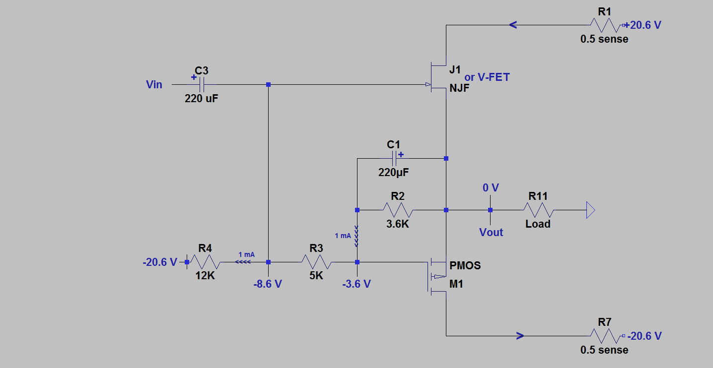

Thanks generg and Zen Mod for your replies. The attached is a concept schematic to use when a large absolute difference exists between the Vgs of a power N-JFET or V-Fet [for example 2SK82] and that of a power P-MOSFET in DEF and DEFiSIT.
The example shows a typical difference of 5 Vdc. It can readily be a larger difference in a DEFiSIT which uses a low idle current [e.g. 0.2A]; for example in a headphone application or a follower for a low power OpAmp. It follows that the value of the example [R3 =5K] will be larger.
N-JFET or SIT is a follower in its own right. Capacitor [ C1=220uF] at its source node uses the resultant in-phase output signal [Vout] to route it directly to the gate of P-MOSFET. Thus [Vin] as the new replica [Vout] essentially bypasses the high-valued resistors of the biasing string of DEFiSIT and DEF.
The aforementioned high-value biasing resistors maybe implicated [a legit or not reasoning] in degrading the high frequency performance of P-MOSFET. In the absence of the output coupling capacitor [C1], either the 5K or higher and the 3.6K are in series with its inherent input capacitance. One may argue for the potential to affect or degrade the slew rate of P-MOSFET.

yup , we already know for that solution , and simillar
frankly , can't remember - is it from your threads , or Papa's writings somewhere , or combined
C1 is there for good reason ,doing exactly what needs to be done
in any case , one needs to take care of resulting Rin of OS stage , to not burden preceding stage too much
