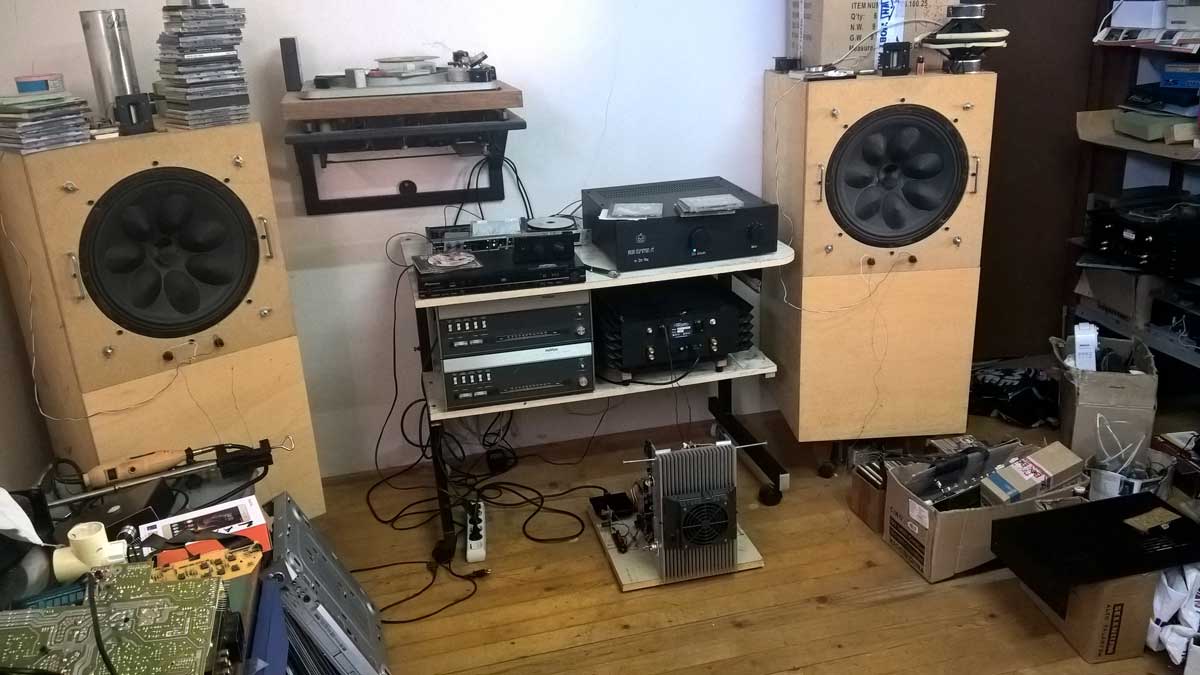

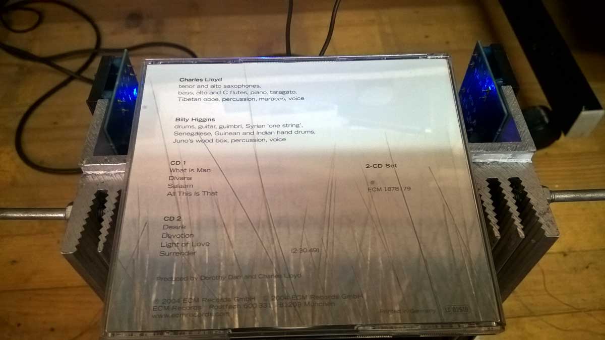

back to subject - SissySIT is damn good amp ....... had pleasure to listen to at least half of dozen albums today afternoon , and everything sounded just right .... while term Spooky more than certainly is adequate, in proper moments.
I even switched to some radio-drama , which I'm often listening
yeah , many things are right , while some are even more right
frankly , I have auditive memory developed as Butterfly 🙂
most probably because in last few decades I was always more in hedonistic realm of listening , than in critical side of it ; I remember first evening at Pa's , on the Coast ..... while listening his small living room system , I fell in sleep at least trice ... most important virtue of sound system was there - nothing bothered me 🙂

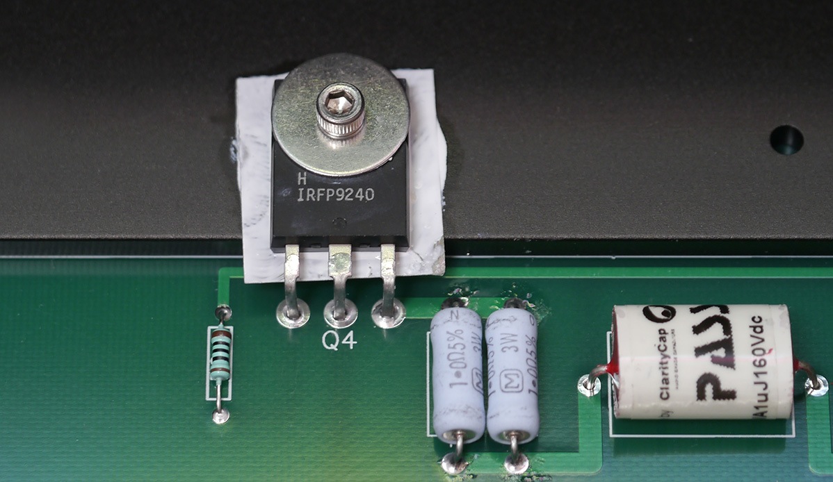

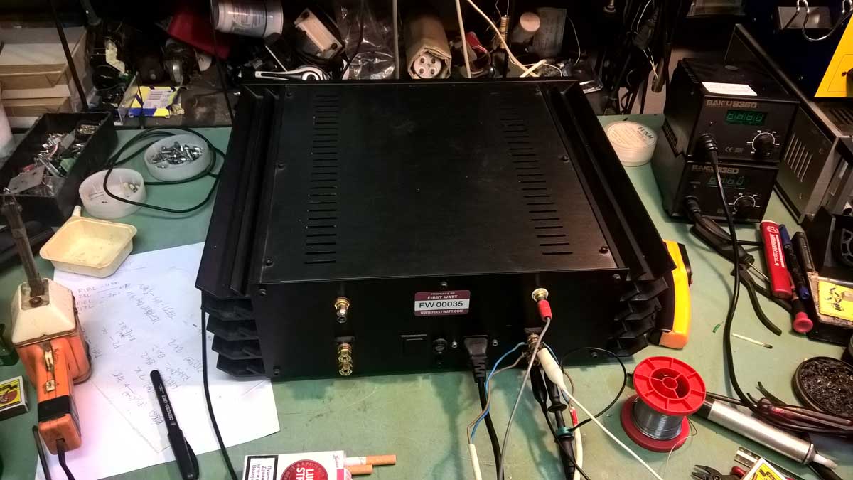

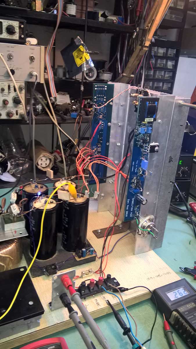

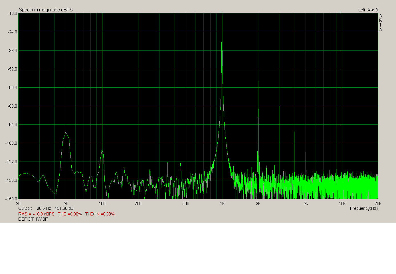

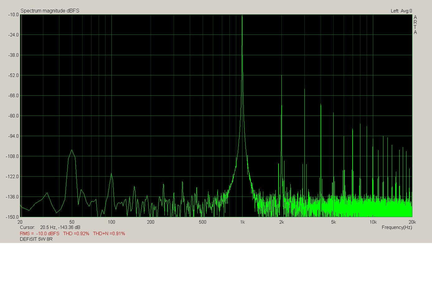

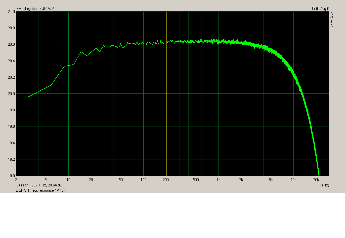

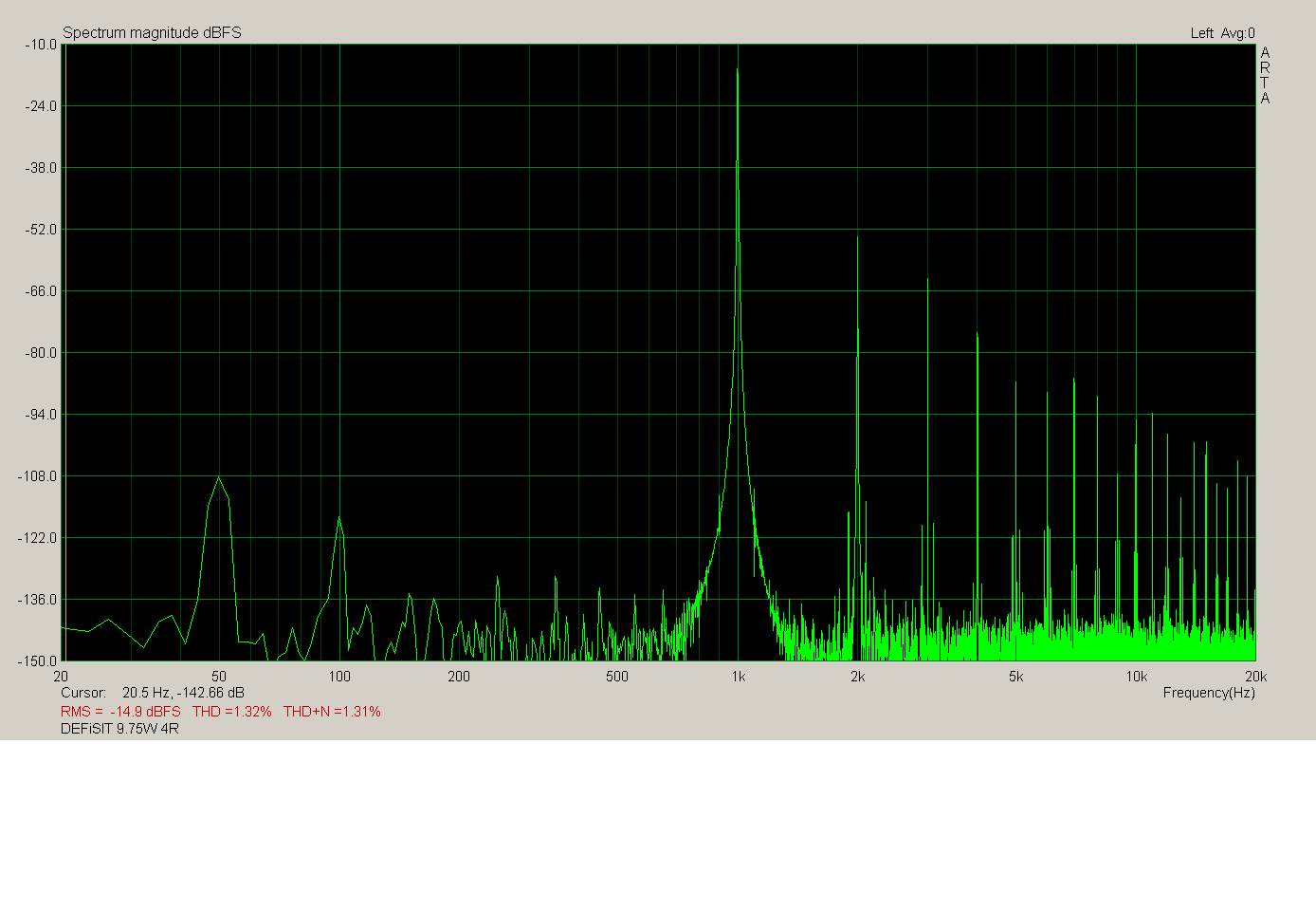

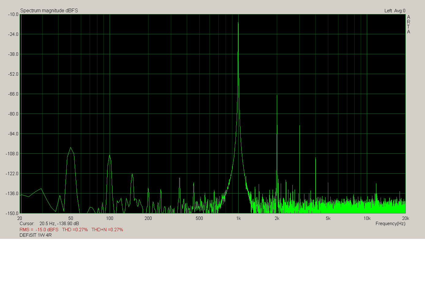

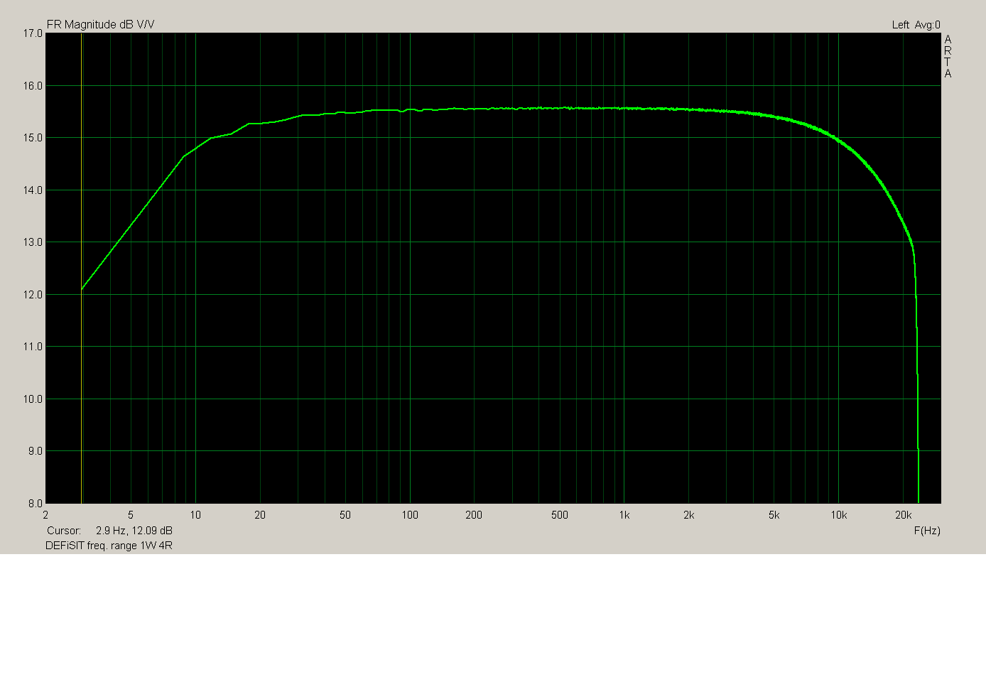

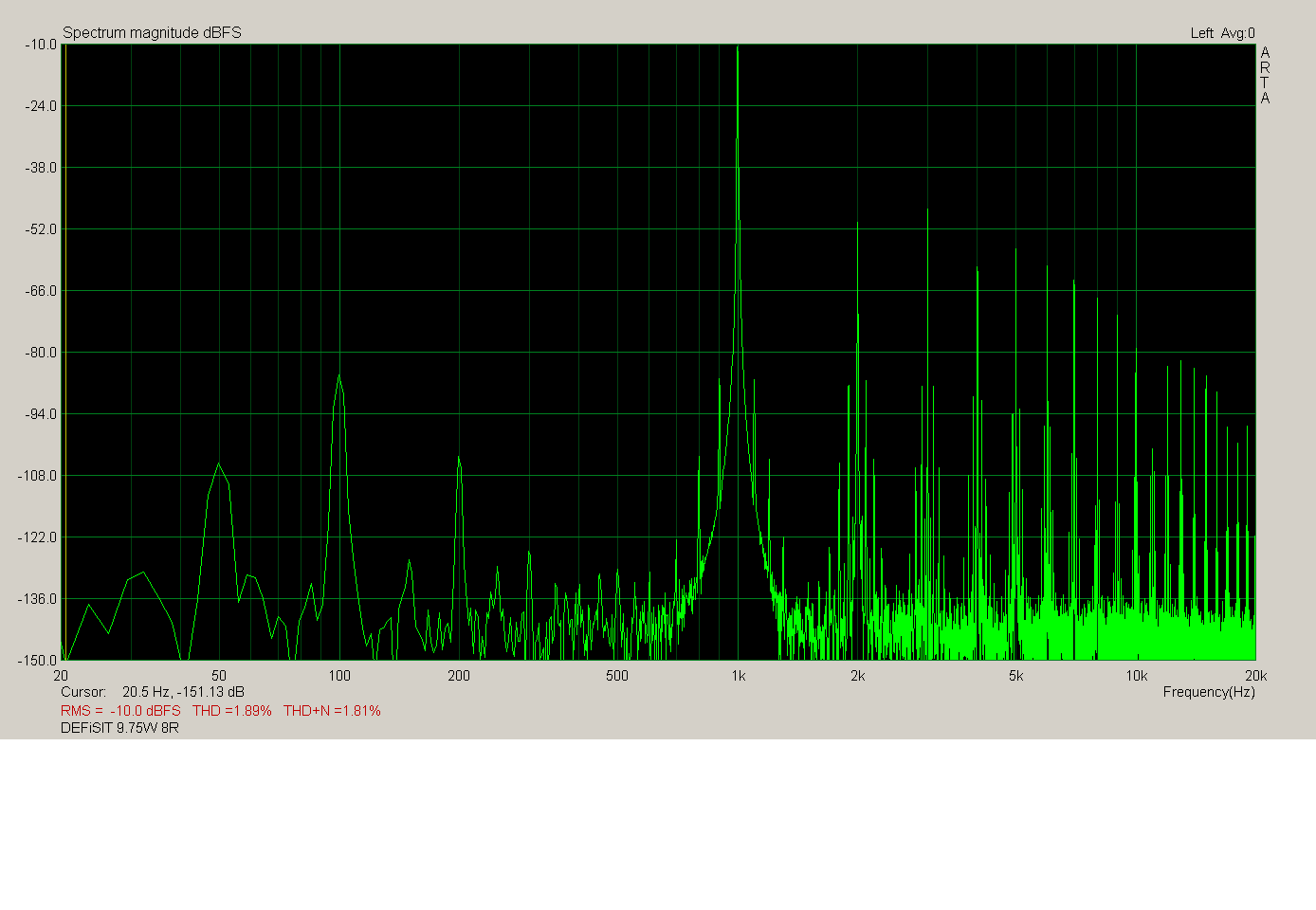

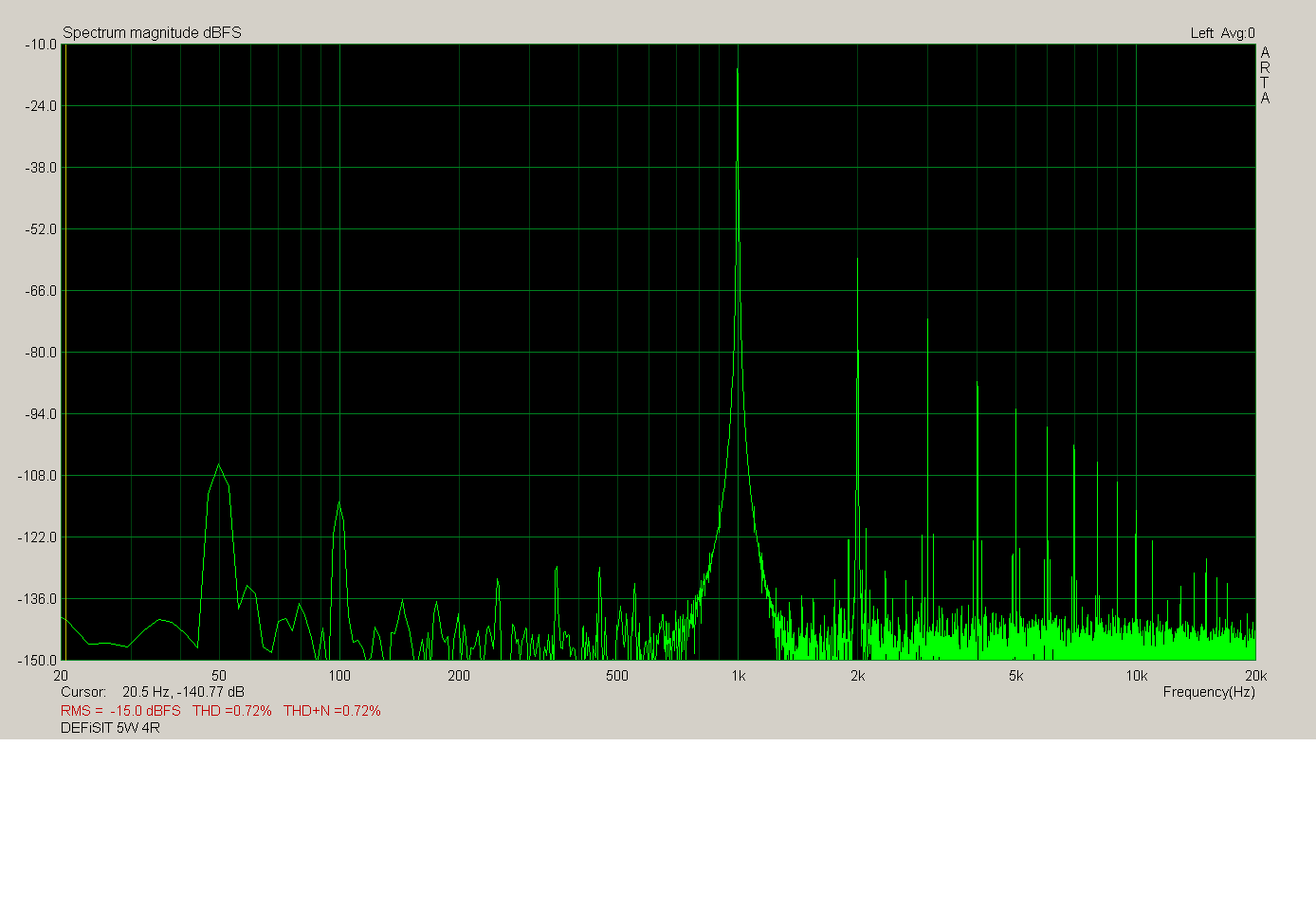

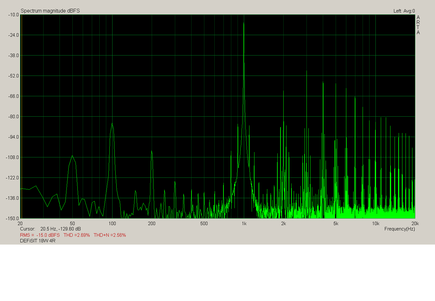

results as I expected ...... note - clipping at 9W75/8R and 18W/4R
Interesting performance congratulations ZM!
Papa use Harris brand mosfet's in DEFiSIT | SIT-3.
Your are IR Vishay ?
I'm still young Papa , so when I grow up , I'll be grown up enough to use Harris mosfets and other thingies , as Pa
in these tests I used plain vannila (so Vishay) IRFP9240
soon to use Infineon IRFP9140 , but not expecting grande différence

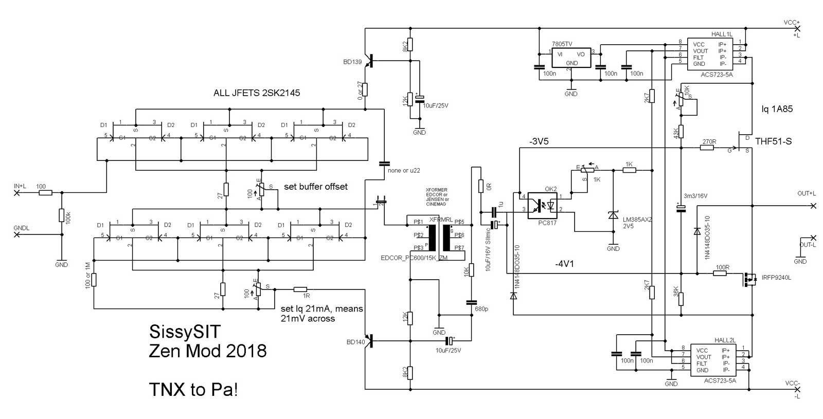

here is the schematic , SissySIT as made :

I see that bipoar power supply is used and without in/out cap... !! 😱
Do not use the word spooky.. 😀😀 It makes me dumb..
Congratulations Mighty ZM!!!!
you can put caps if you wish , on both ends
just do not mix their values
