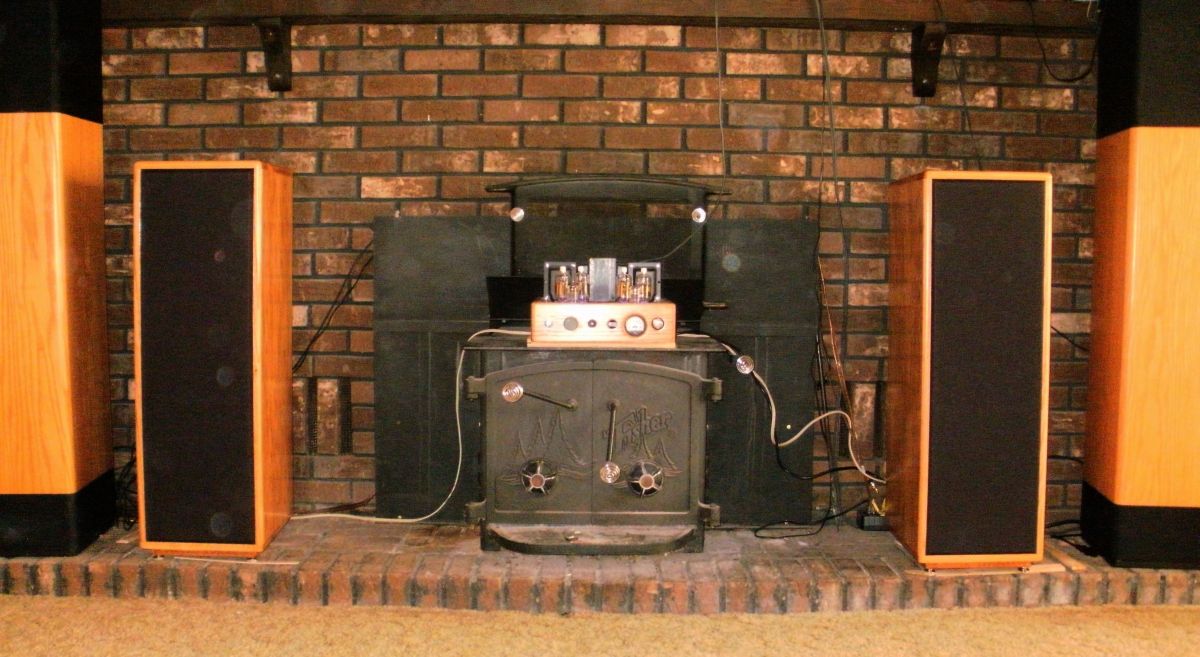

As previously written, it is a Class A2 power amplifier based on 211 transmitter tube, with 300B driver tube and Emission Labs 20A input tube. So we have three active stages, all anode driven, no transistors (as previously questioned) anywhere of course. It is a zero feedback design (locally or globally) with nominal power output at 35 Watts per channel.
The output transformer has been designed to provide best sound and best measurements and it is the only part in this amp with balanced compromises. After all, it couldn't be otherwise. If you are forced to squeeze so much clean and undistorted power out of a 211 tube, you have to balance out some compromises that mother nature imposes. I could get slightly more power out of this monster (aca smaller tube load), I could get slighly better high freq response (aca fewer primary turns), I could get slightly better sound, but the balance of all those three are now reflected through the end result.
Specially for the driver tube, only 300B is able to drive 211 tube to its maximum potential as the output tube goes heavily in Class A2 mode of operation.
The level of the performance of this amplifier qualifies as extraordinary in all aspects, compared to any SET amp around. I know this first hand because I am both the designer of the amp and the coil winder of all iron pieces inside. IMHO it is the best demonstration of the pure undistorded SET sound when only music performance matters. There is no need to stay anymore on performance description because all visitors here are already exposed to good SET sound. Unfortunately, like in all good SET amps, the amplifier's cost is absolutely insane and out of this world. It might sound absolutely crazy to the inexperienced, but things cannot be done differently. Good SET sound, away from usual compromises and well known issues, is extremely expensive.

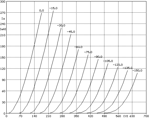

Next comes the 300B, again with inductive load. Please compare the attached curves, taken by Audiomatica, and used with their kind permission:
Audiomatica Srl

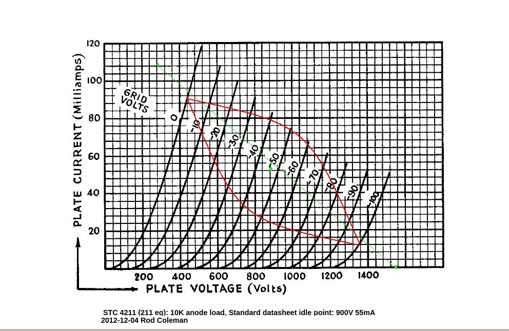

The most impressive performance of all is from the end-stage, using the 211.
This is among the most linear devices available, with performance maintained over a swing of 1000V or more at the anode. We still have no semiconductor device to offer this kind of overall performance. To show something of how good it is, please see the attached curves for the STC version. An quasi-elliptical load is shown, to represent the reactive nature of the loudspeaker load. Data sheet values were used in plotting the load, maybe Peter has a better optimisation.
Substituting a triode-connected KT88 into the end-stage (even if operating voltages/currents were re-optimised) would result in gross distortion.

The data sheet for the 211 specifies "typical condition" 2nd harmonic distortion of 5% driving the plates at 1250V. And that is the only operating point detail the builder has stated for anything in the circuit.
All of the "exrordinary performance" claims revolve around the flat frequency response. Is that all we need?
211 datasheet states 5% 2nd harmonic at 20W output for a single tube; the few crude measurements I took on my amps at low power (1w or less) showed unmeasurable 2nd harmonic in my silly scope (8bit)
