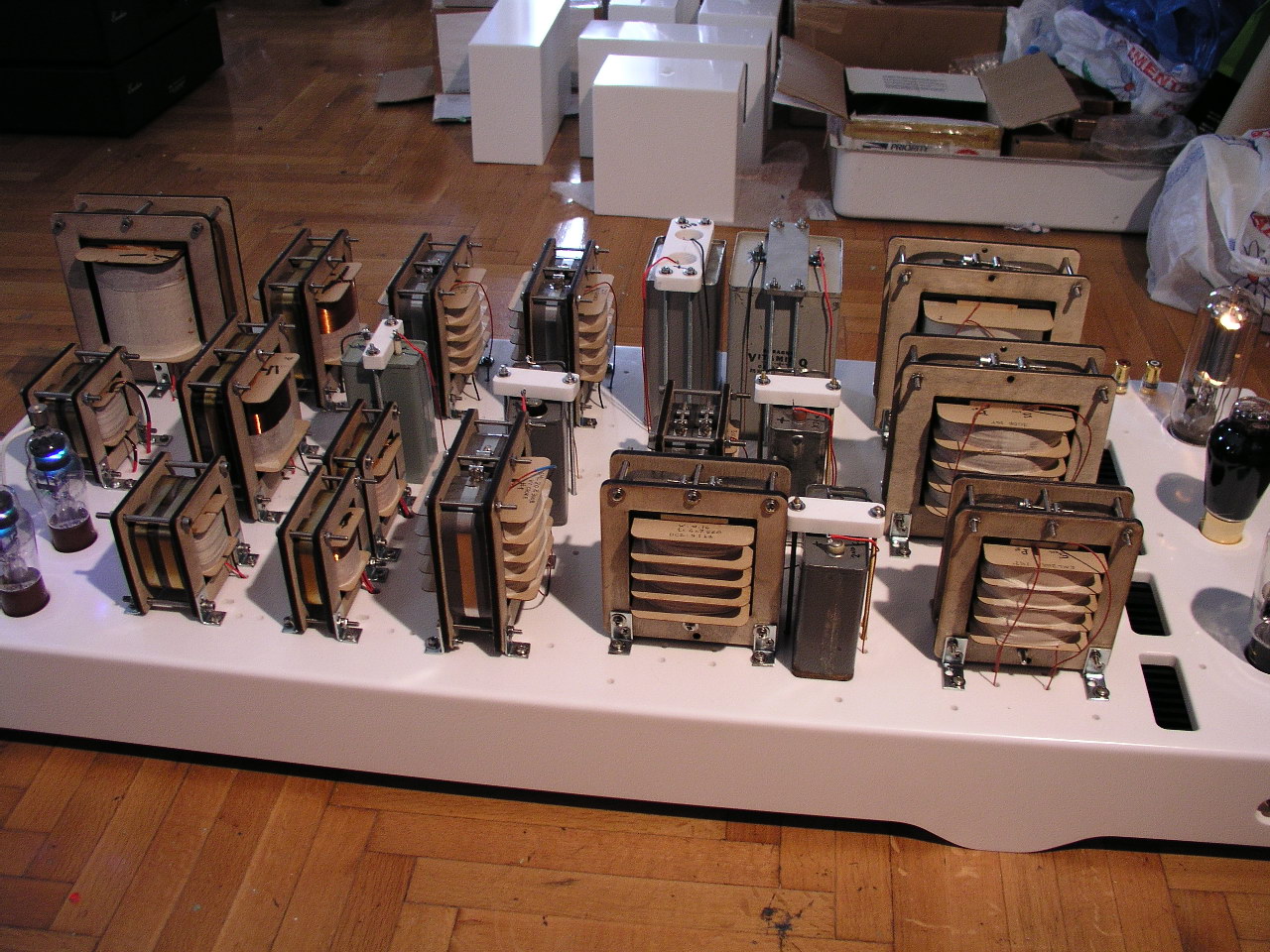

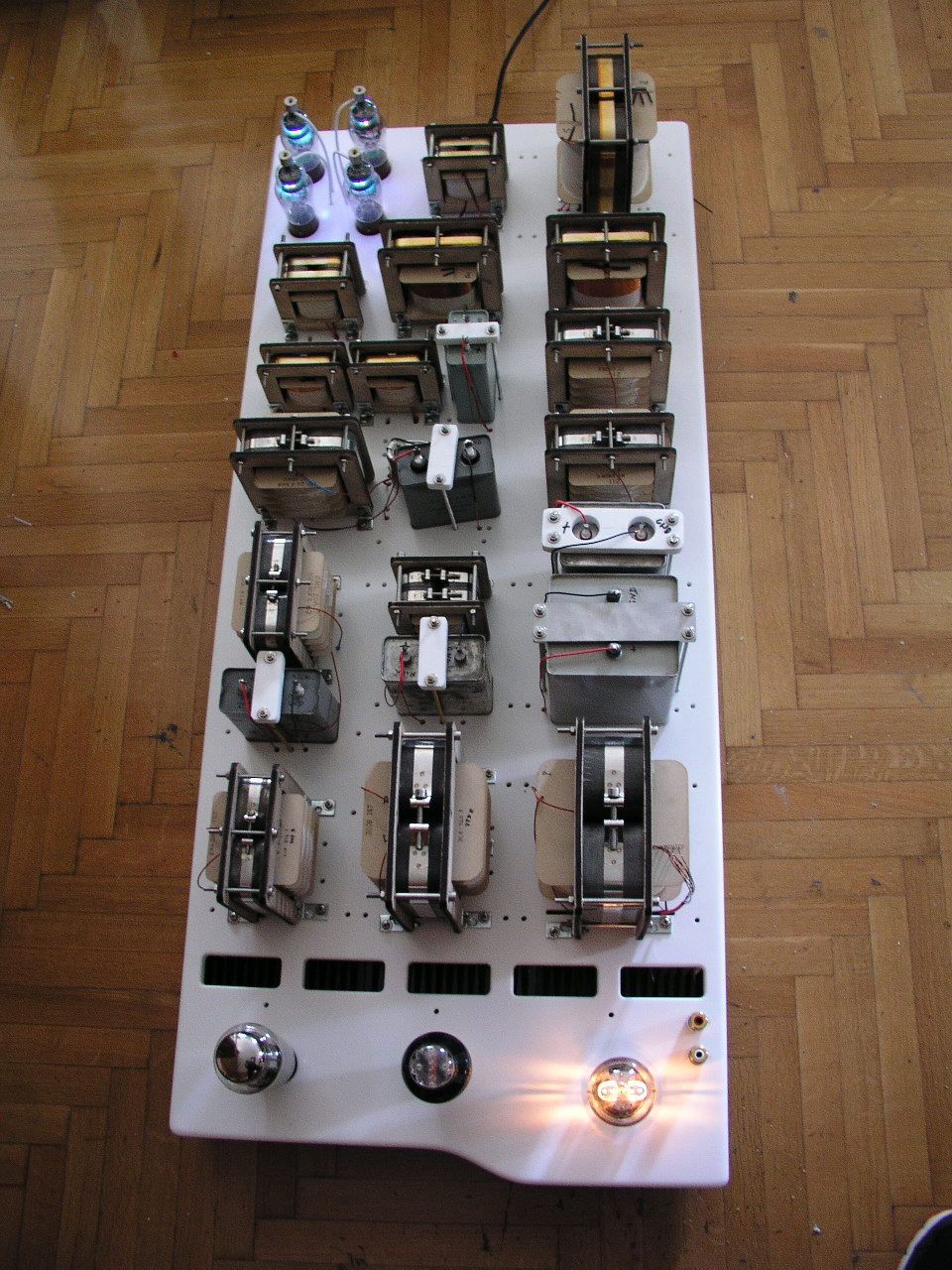

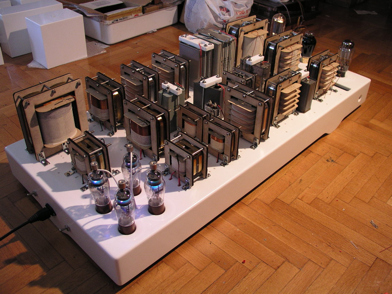

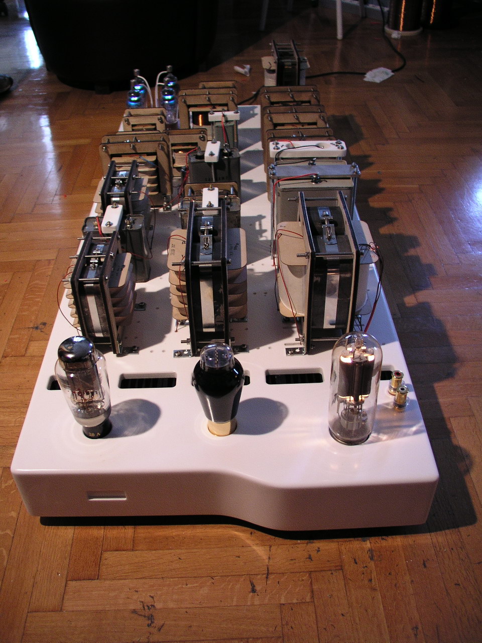

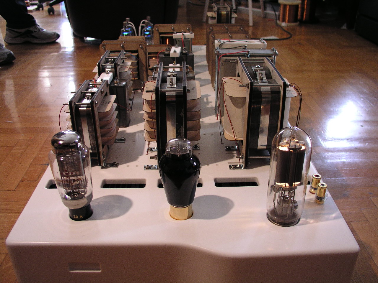

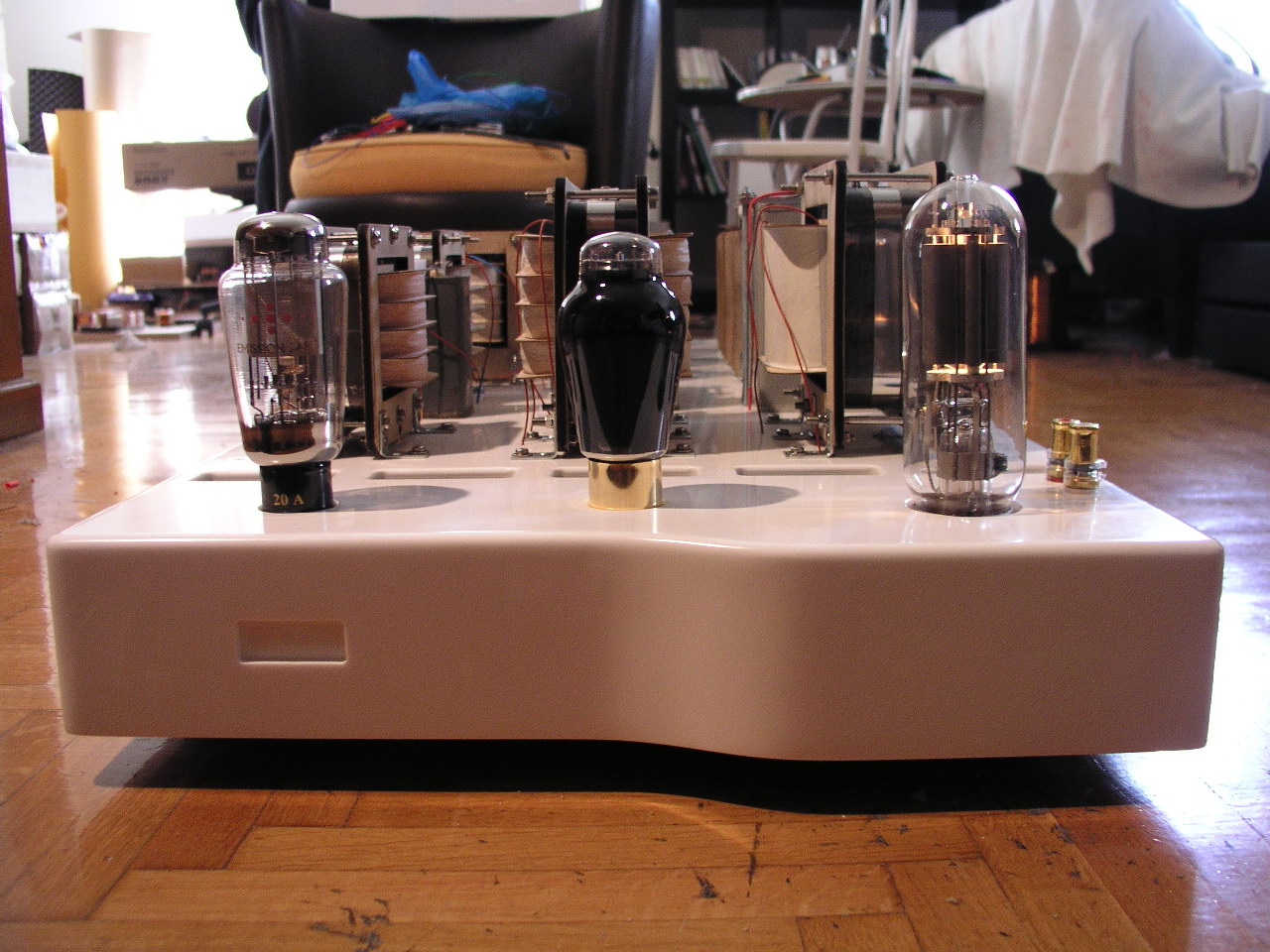

As I promised you a few days ago, I will post some pictures of the project I'm now finishing. It is an exotic power amplifier equipped with 211 power tube.
Due to the unique specs, I would say that I'm quite certain that this might well be one of the most exotic amplifiers ever made. There will be several posts regarding the specifications afterwards[/SIZE][/B], for the time being I have uploaded some pictures of this unique project.[/SIZE][/SIZE]
It is a 35 W/ch Class A2 power amplifier around 211 output tube, with 300B driver tube and EML20A input tube. There are totally 15 iron pieces spread allover, all of them in double c core configuration. Signal path is 8 cm from input socket to 1st tube grid and around 20cm of copper leads coming out of the OPT secondary, directly soldered onto the loudspeaker connectors.
For the time being enjoy the pictures.

I do not have any sort of problem releasing the schematics. Actually I have done so through my writings...
Those guys that are still complaining, judging from their writings are totally unaware of tube amp design. The reason is that I have thoroughly explained everything related to the power supplies, tubes operation, biasing, etc. As soon as they are still asking questions, there is no room for me to respond. They are not up to the level even to understand the basics, so I have nothing more to write. Let's say I'm just enjoying their ignorance.
Now, regarding how I am winding the transformers, how many Henries is each of the interstage trafos, how many turns per primary or secondary coil, magnet wires diameter, winding scheme, how I succeeded in maintaining a perfectly linear load from subsonics to ultrasonics, what the exotic cores are made of, where do I place the custom order to manufacture all this hell of c cores, sorry but I have the right to keep this info undisclosed.
All other questions have been asked so far.

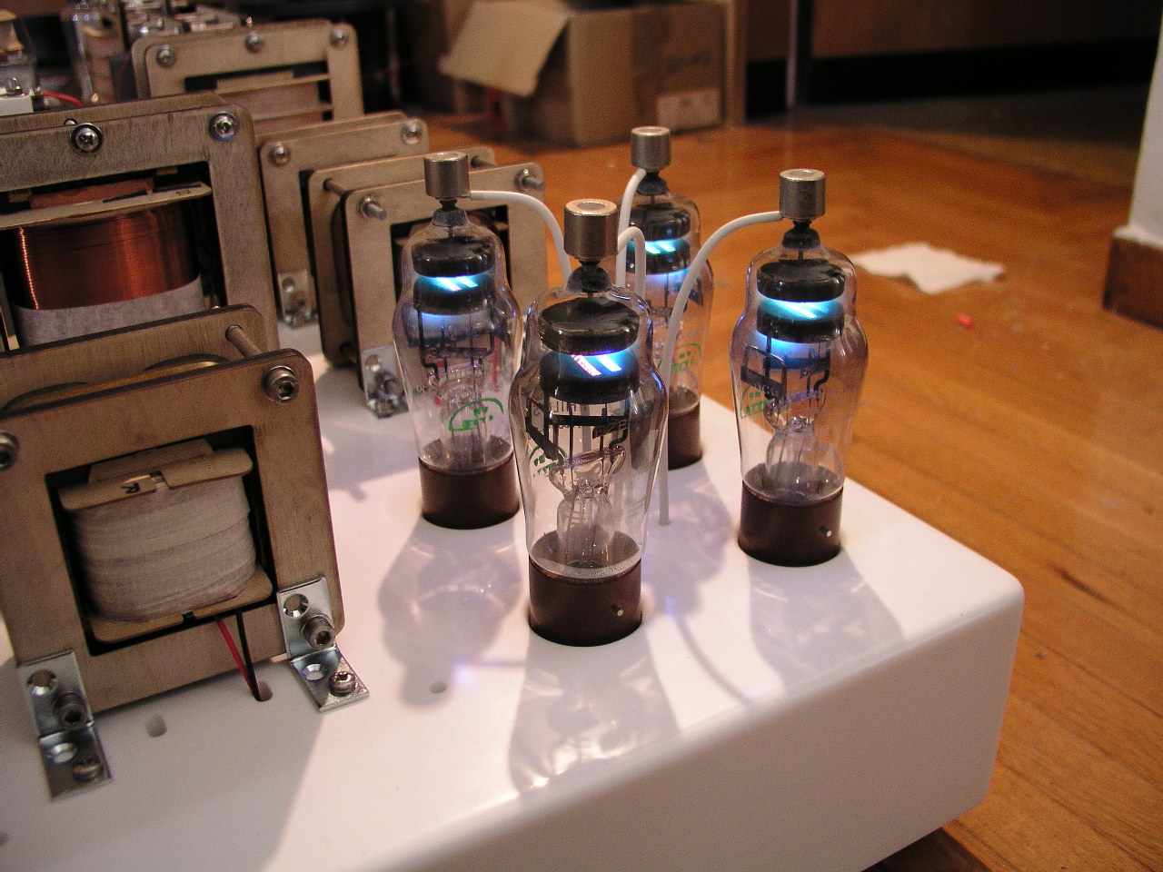

Finally, those MV rectifiers are the best ever manufactured, at least for this position. I have evaluated every and each crazy MV rectifier existed, this is an outperformer. Those 4 MV tubes do not form a bridge, like in Kondo designs. They compose two separate power supplies, two for 211 rectification and two for 20A & 300B rectification. In all my designs of power amps (otherwise IMHO a creation cannot be justified as 'exotic'), I always use a dedicated power supply for the output stage. This stage must be kept completely isolated from everything else, this is where my experience leads to.

Regarding the aesthetics, I have to thank you for your comments. There is a lot of effort there, too much pain to hands and pockets(!) as well...
Regarding the performance, I think that I'm not the proper person to respond here. As soon as I am the manufacturer of everything here, it is not me that I have to comment on this. Maybe the owner can write something, he has auditioned many many amps in both various installations and his own system. I am not trying to be modest but as you would easily imagine, the creators tend to be a bit biased... I am tryig to avoid this path, nothing more.
As soon as you are not that familiar to SET designs, maybe this project could intrigue you a bit to start over. This amp provides 36W RMS power, it is very high power considering it is a SET design. And remember, here we do not have a 833 tube, we have one of the most linear and best sounding tubes ever made on earth. Not simply a 211 tube which is exquisite as a tube design for audio purposes, but the creme de la creme of all 211 tubes: United Electronics!
Yes, I am using inductive loading throughout, not only in output stage but in both three stages! That means two interstage transformers and one output transformer. If properly calculated and developed, this is by far the best way to couple signal between stages. Contrary to your own belief, it is not the ISTs that account that much in the performance of this amp, but the OPT! OK, the design and manufacture of the 300B IST is extremely complicated, but as it was perfectly executed, it does not account that much. Taking under consideration only the performance of signal transformers, the OPT is more than 80% of the sound alone, the rest 20% belongs to the other two ISTs.
As every knowledgeable DIYer here already knows, it is totally unfair to compare the performance of such SET amp against any commercial product, regardless of cost, status, price, etc. There is absolutely nothing in common to compare. The companies you have mentioned are well respected companies producing commercial products through a distributors network. Although I am taking orders worldwide to manufacture 'exotic' amplification devices, IMHO there exists no ground for any kind of comparison, even with some exotic brands like Kondo or Wavac and their flagship creations, although I am paying so much respect to them! Judged side by side, under the same conditions (distributors network), what you are looking to here would cost 2.5fold the price of a Kondo GakuOn power amplifier, an estimated $0.5M where GakuOn costs around $200k.
