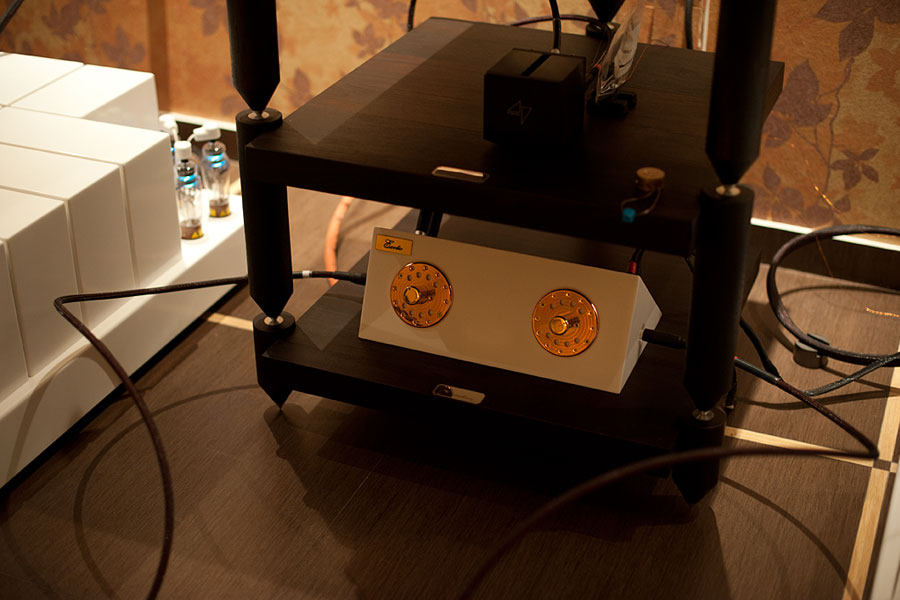

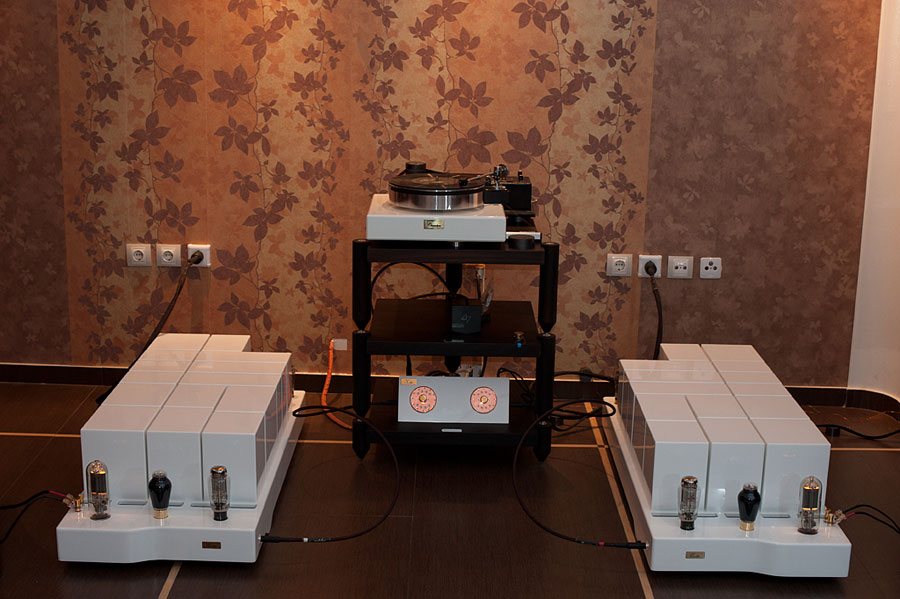

Petavgeris, can you tell us about the turntable on the top of the equipment stand? Is the base also made of Corian? What type of phono stage?
I am also curious about what appears to be a passive volume attenuator on the bottom shelf. Does that use autotransformers and if so did you wind them yourself?

The turntable on top is a classic Verdier painted in white color. The phono stage is 47 labs modified in its power supply. The 'table is also modified. All mods were performed by the owner, who is also the manufacturer of this nice wooden rack.
The preamp is nothing more than a mere carbon film attenuator of maximum quality. Several autoformers had been evaluated as the owner was not that supportive of the 'pot' idea. He actually owned probably the best ones evaluated, but again they sounded inferior to this carbon pot.
This passive preamp is a preliminary model, a temporary solution. It is going to be replaced by the most insane autoformers pair ever developed, with custom designed and manufactured ferromagnetic alloy as tape wound c cores, with a huge power supply to energize the magnetic field inside these transformers. Unfortunately, these creations take a really looong time to reach maturity, so we try to keep patience. In the end, patience always pays back!

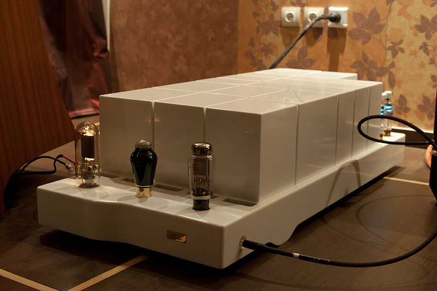

Can I ask, are you using the multi-split bobbins for both your output/interstage transformers and chokes? There is a short video I have seen about Kondo and the Ongaku amplifier that shows a 'technician' winding on a multi-split bobbin. I have always wondered which component he was winding, and whether a secret was inadvertently being given away.

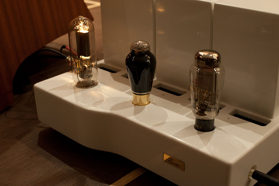

Simon,
thank you very much for your kind words. This was a really tough project but the most tough are still ahead
The split bobbins that you mention, as well as all the bobbins on these amps are hand made. They are cut on a precision laserject machine and then hand assembled and glued alltogether. They are designed so as the c cores fit with maximum tolerance and virtually no space is left.
The number of the sections is calculated and the space occupied by copper wire is the ideal for each application. I did not know that Kondo OPTs are sectioned. My ISTs seem to be 'plain' multi-sectioned, wound on split bobbin coil formers, though reality is not exactly this. I apologize for not being able to give out more information on ISTs.
Nothing is actually a 'top secret' in SET arena, the technology has been squeezed to its limits since many decades ago. In theoretical terms. As soon as I am the designer and manufacturer of this amp project from scratch, all I have to say is that it is not the technology that suffers when the result is not up to the task, it is the application of the rules that suffers. Whoever designs SET amps has to depend on the quality of iron pieces, name it P/S, IST, OPT transformers or inductors. This is the limitation of SET design. In order to travel the extra mile, you must wind the iron pieces yourself, as all products suffer from very serious flaws. Trust me, I know what I am writing of... I see some ISTs around, small like an appricot, terribly executed, sold for several thousand dollars, because they are made of special material and varnished with snake oil...
