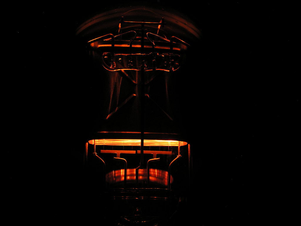

As previously written, it is a Class A2 power amplifier based on 211 transmitter tube, with 300B driver tube and Emission Labs 20A input tube. So we have three active stages, all anode driven, no transistors (as previously questioned) anywhere of course. It is a zero feedback design (locally or globally) with nominal power output at 35 Watts per channel.
All tubes have been selected to be Directly Heated Triodes, this was the 1st prerequisite for this amp, no indirectly heated valves were allowed. The 2nd prerequisite was the inductive loading of all stages, no capacitor was allowed to be used. The third was to use exclusively tape wound cores, no E-I iron was allowed for this project, so I ended up using double c core transformers and chokes everywhere. The signal transformers are wound around 0.1mm CRGO c cores and all others around 0.23mm CRGO c cores. Then come other prerequisite parameters like one secondary coil per transformer, only oil capacitors in High Voltage filtration circuits, only Mercury Vapor tubes for rectification, and then only the best parts and components, vintage or modern, without the slightest compromise. And finally come the aesthetics, I wanted to show something extraordinary, different than anything presented so far. The amp should reflect the philisophy of both the designer and the owner, about aesthetics. It should follow classic design lines with lots of transformer covers but presented in a contemporary 'feel' without bolts and eye-catching candies, the amp should look not like a monster but like a generous giant relaxing close to each speaker.

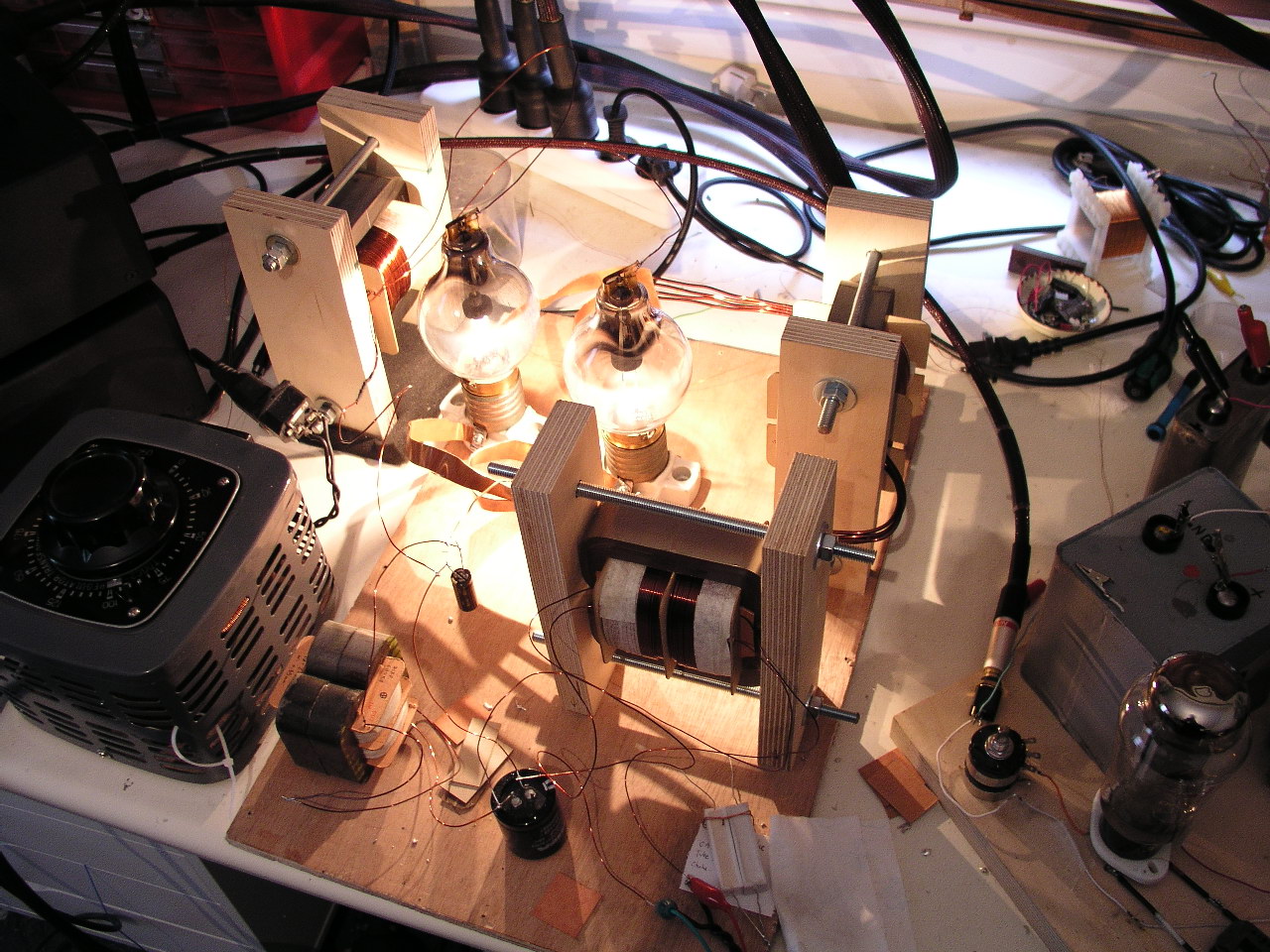

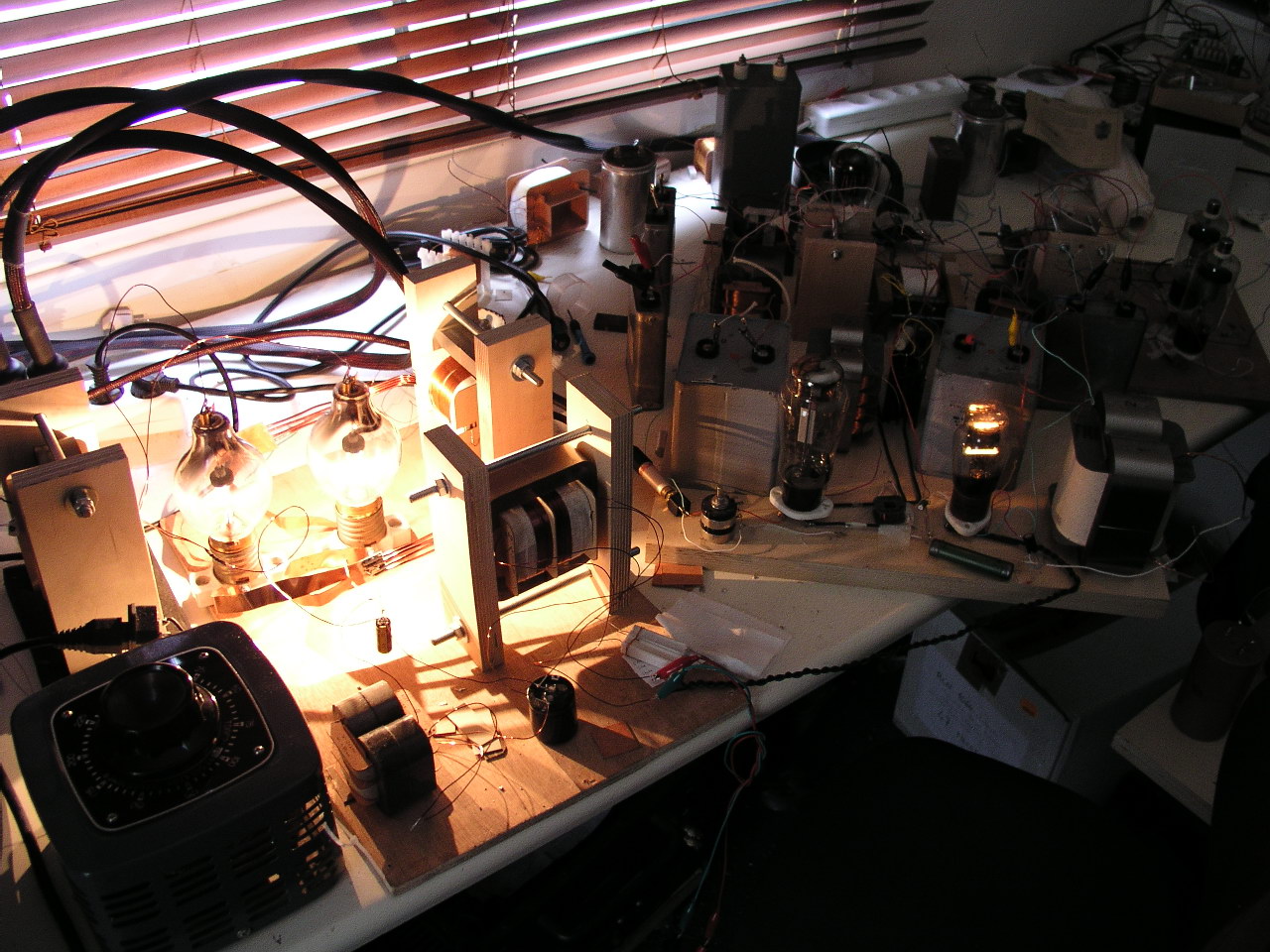

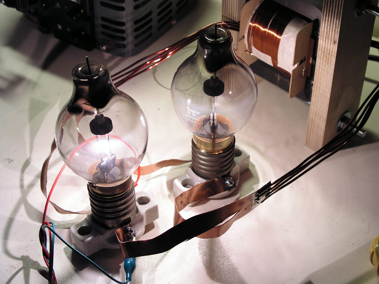

And in order to have a better idea of what is coming, here are some more pics.

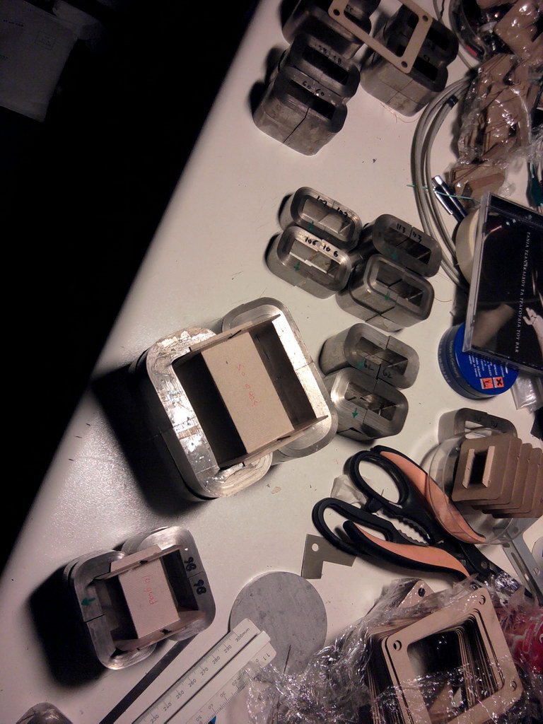

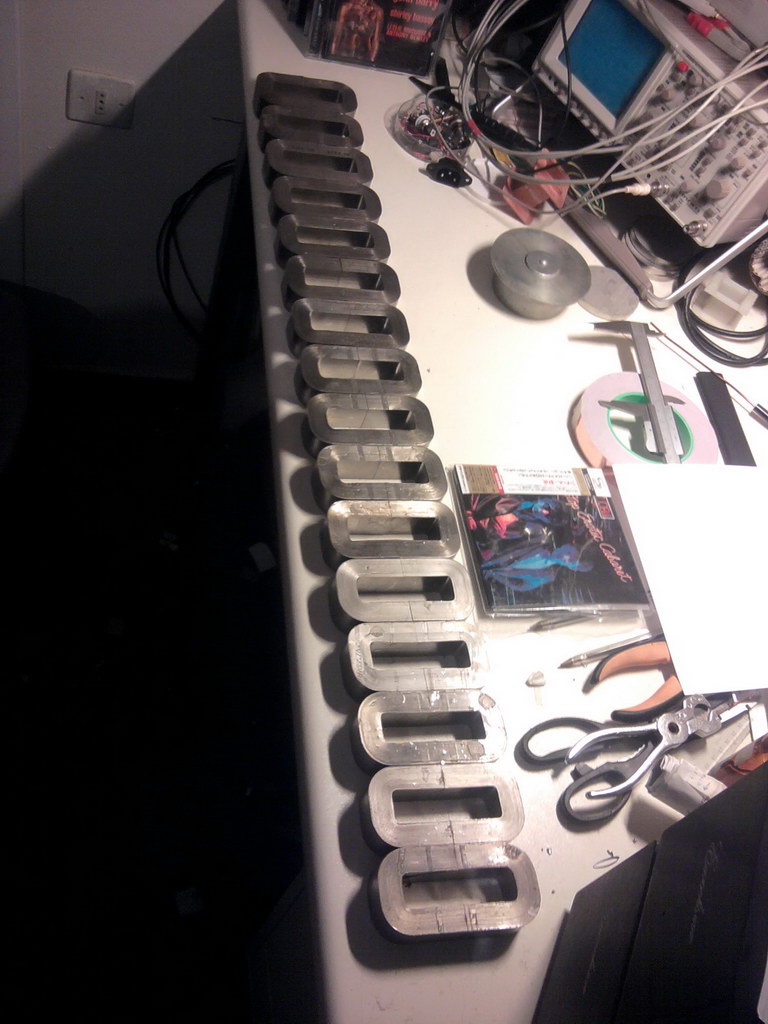

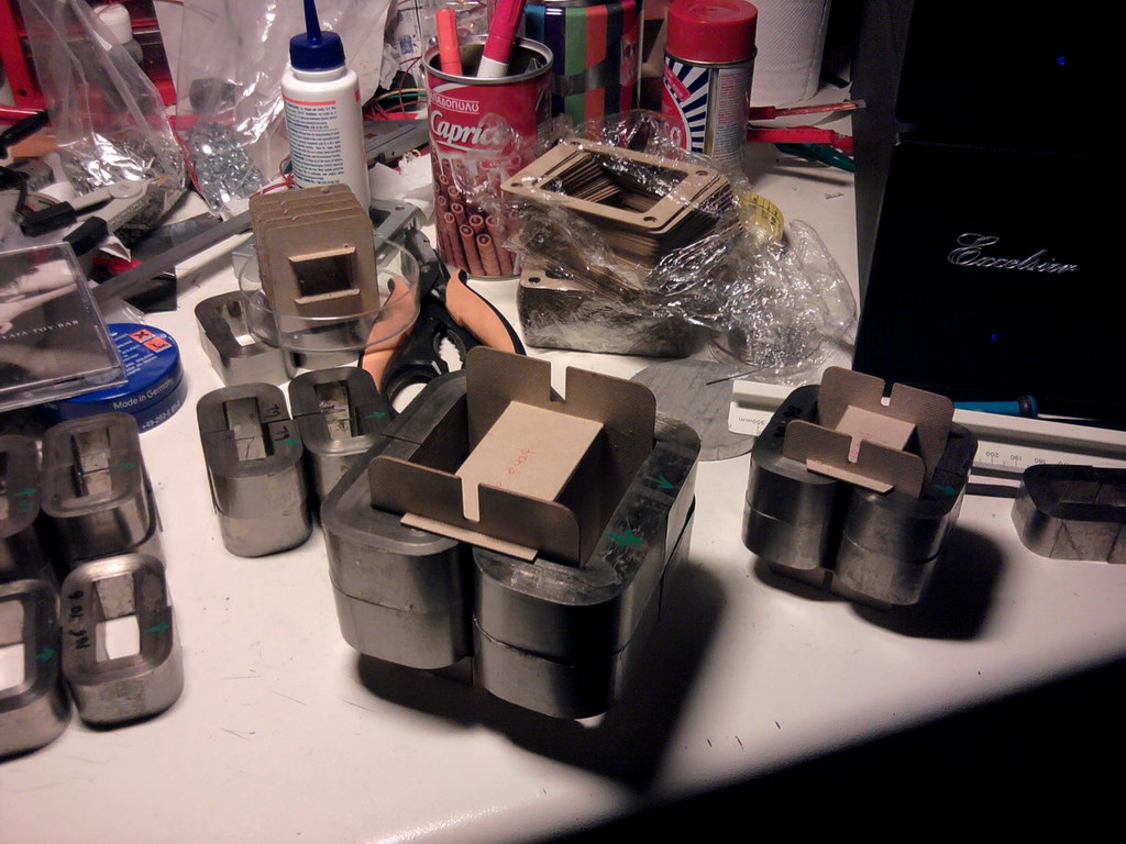

There are dozens of exotic, custom designed and custom ordered c core pieces waiting to be wound.

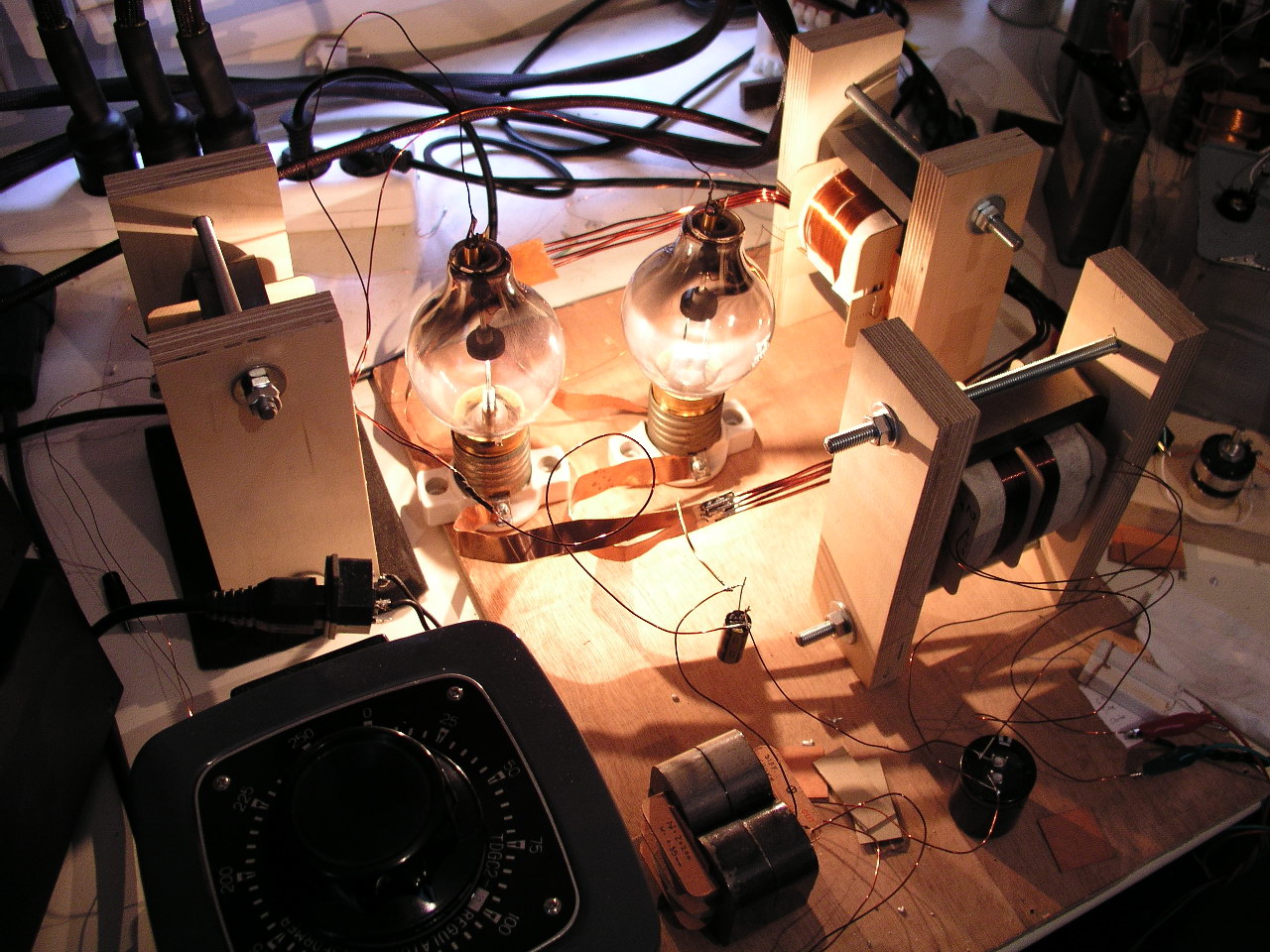

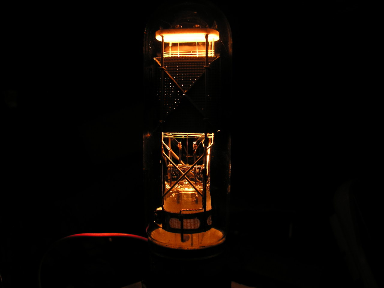

Here you get a brief idea of the double and quadruble filament transformer c cores. And you see the argon filament rectifiers in full operation!
As I have written you before, when you have the knowledge, the skills and the imagination, there is practically no boundary that can be seen as an obstacle, in all aspects of life. Remember that I have been grown and live in Greece. Although we're still sufferring from deep economic recession, we have proven historically for thousands of years, that free spirit, imagination and inspiration to offer the best to humanity, never die in this country! This is the way we have been grown and we live our lives.
Have a nice day!
