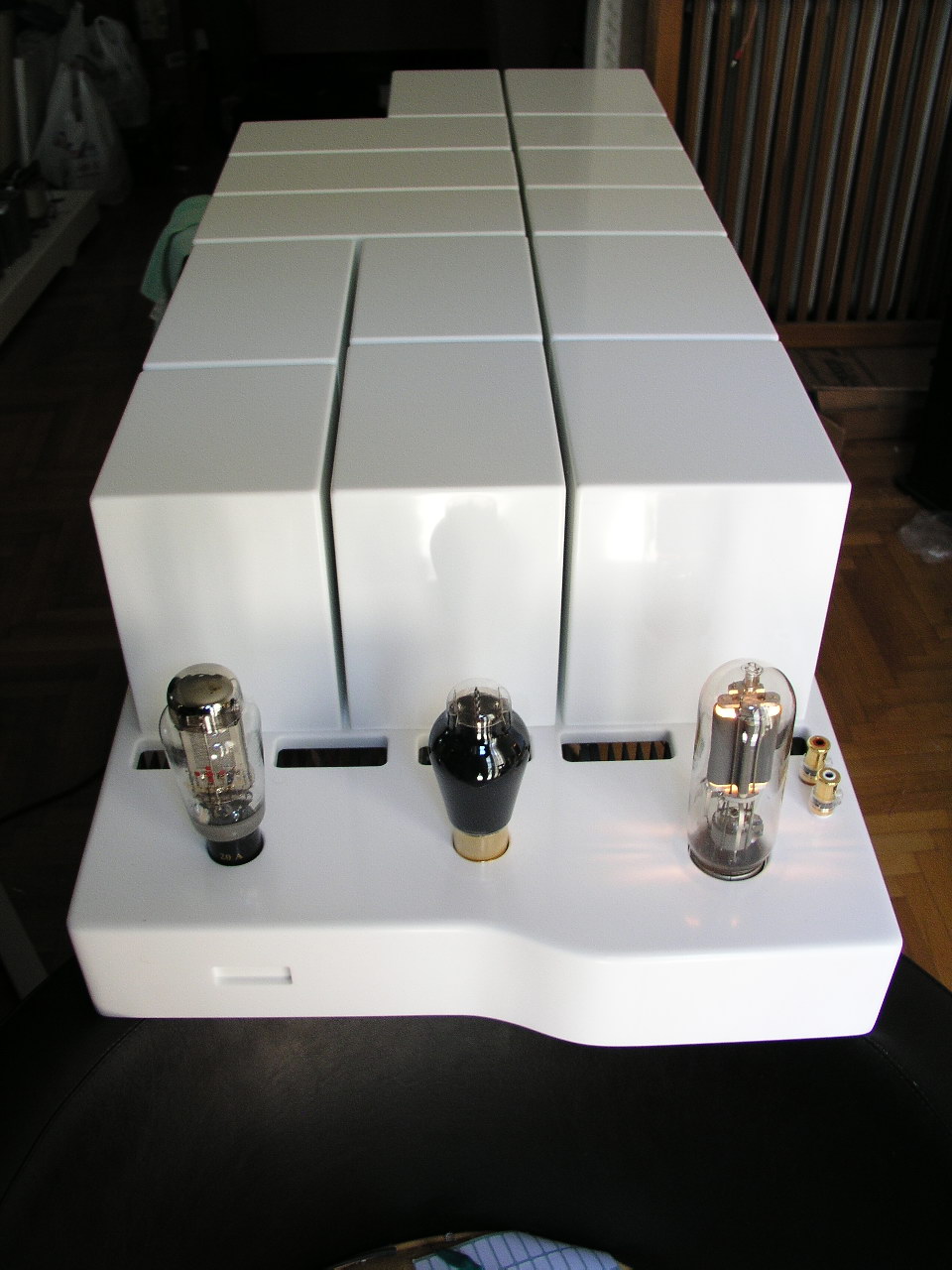

This is a project that lasted somewhat more than a whole year.
What I had in my mind a year ago was to manufacture completely from scratch a super amplifier, trully exotic, something that probably has never been made so far. The majority of the 'extreme' work that this machine needs, specially in coil winding, is totally unseen or obscure. The complexity of the winding of all the transformers cannot be understood without dismantling and reverse engineering.
Anyway, with this project I wanted to show to some friends and to the DIY community that everything depends on the boundaries of your imagination. Just imagine the end result and... bingo, you've got it. Remember that I live in Greece where the economy is dying due to the recession, however if you have the skills and the courage, you can surpass every obstacle that may appear during the trip.
I just saw that many of you are asking for the transformers, or wonder why so much iron. I need to underline that the extraordinary level of performance of this amplifier lies in the quantity and quality of iron. I have told to many friends that the level of performance of a well designed SET is proportional to the weight of the iron! Use more iron and you get better sound, so simple, provided that everything is up to its task.
On this design, I have used the following iron pieces:
1x filament transformer for 1st pair of 866A MV rectifiers
1x filament transformer for 2nd pair of 866A MV rectifiers
1x EML20A filament transformer
1x 300B filament transformer
1x 211 filament transformer
1x HV transformer for EML20A & 300B tubes
1x HV transformer for 211 tube
2x HV supply chokes for 211 tube
3x HV supply chokes for EML20A & 300B tubes
1x Interstage transformer for EML20A tube
1x Interstage transformer for 300B tube
1x Output transformer for 211 tube
All the above make a total of 15 iron pieces per monoblock.

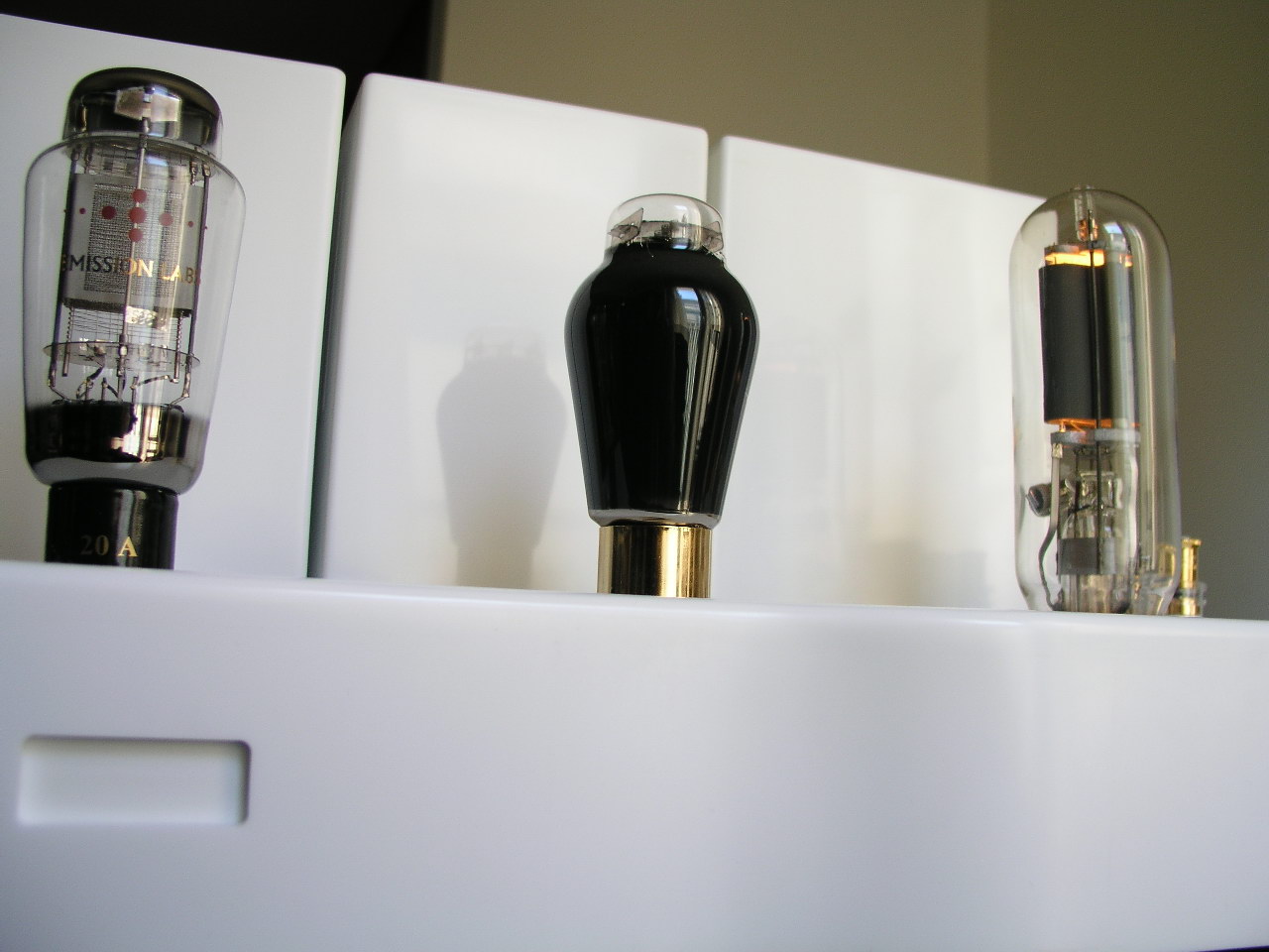

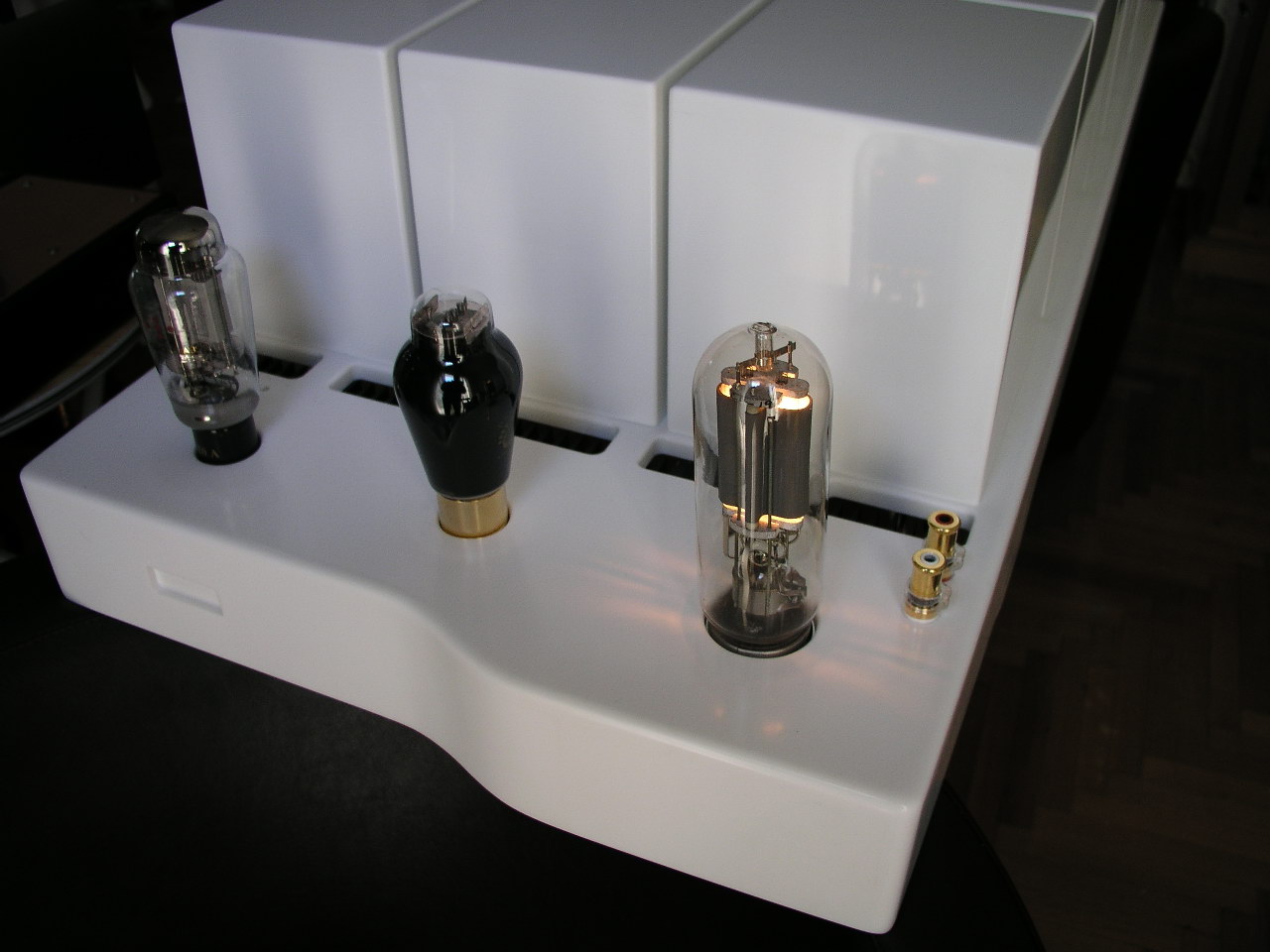

that's a piece of art. using 300B as driver probably is the smartest thing to do
what is the enclosure made of? seems solid aluminum with some endless CNC machinery hours.
is this the final look? is there any dust cap or something like a hat to cover all those terminator robot-looking irons? as the voltage is +1000V I think this gear should be used by an expert or you may hurt someone with that toy of yours😀😉

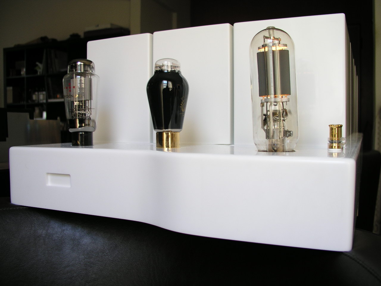

Here are some new pics with the dangerous irons fully covered.
I am still waiting for the tube caps but the post office still plays a bad game here...

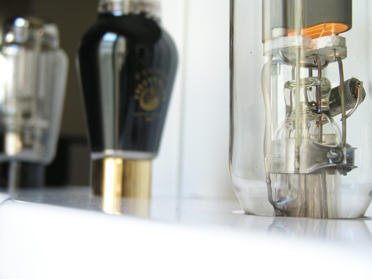

211 has been pushed to its maximum voltage limits, 1250V anode to cathode.
The chassis is made out of corian with endless working hours on the CNC.

I think that definitely qualifies as exotic. Looks like a lot of hours, beautifully executed, obviously a labor of love. I wish it was as simple as "Just imagine the end result and... bingo, you've got it." I can imagine a lot but I know I will never have the skill to do what you've done.
If you can ever get the thing turned over, it would be interesting to see the inside.

Thanks for your kind words.
You are right, this creation is a labor of love. I really loved it from the first moment, as soon as the whole idea was captured into my mind. I wanted to show what is possible sound-wise and at the same time have nice and luxurious aesthetics. Unfortunately it is not possible to show the surface of the highly lustrous corian, under normal lighting conditions it draws your view like no other. I wanted to follow classic vintage design line with rectangular cases allover but at the same time give a modern look with contemporary 'feel' that inspires you to listen and watch, all at the same time. Above all, I wanted to avoid any bolt head that harms the unique contemporary look, only two are visible, on the IEC mains socket.
Turn this thing upside down? Hm, I doubt if it is possible, 4 strong men are needed. Anyway, there is almost nothing inside, only 3 heat sinks for tube rectification diodes and 3 caps for filament supplies, one per tube. There are also 3 regulators inside, giving power to the filaments. This is it.

That is some very nice work. However, I must say that I prefer the naked look with the exposed transformers.
Hi Peter! Congratulations on your work.
The transformers and chokes are fine work, with unexpected materials, and I believe that they deserve to be shown off - along with the splendid 211, King of triodes.
I also think you've done a great job with this amplifier. According to the Dupont website, this material thermo forms at 150º C (300ºF). I hope you don't run into deformation problems from the tube heat with long term operation.

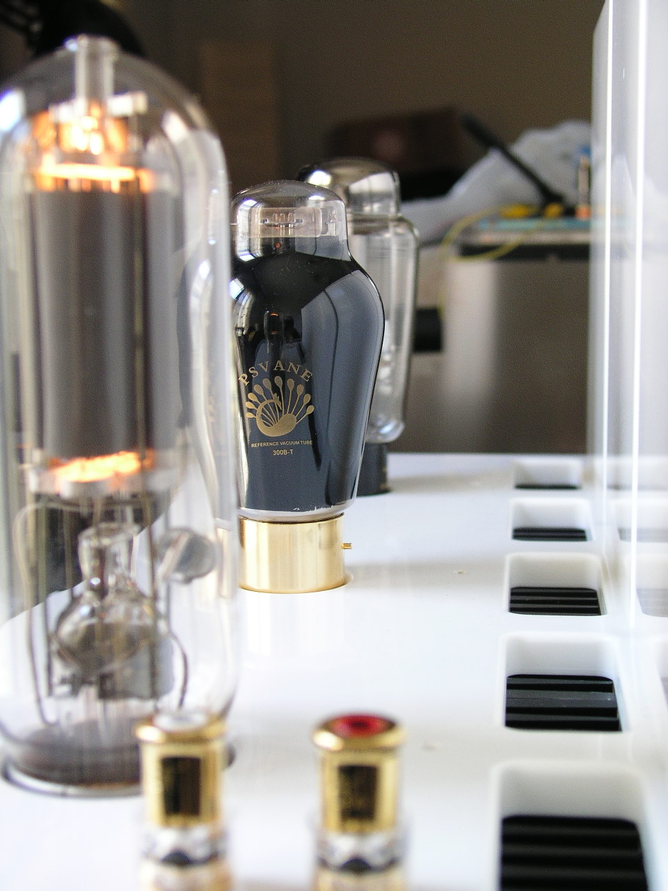

Hi!
After assembling the parts and igniting the tubes, I realized that after 3 hours of continuous operation, they run much cooler inside the chassis than laying on the bench. The heat sinks and the passive ventilation channels really do a lot of work there... This was a bit expected but not to this degree, as the heatsinks are at least 15 deg cooler. You touch them and you just feel they're warm, not even hot! Thermal stress is subminimal and the amp runs unexpectedly cool, of course this is welcomed. Transformers run cool as well, being either HV or filament.

question: how are you lighting the tubes? AC? or DC?
very nice. an impressive handcrafted piece of equipment. bravo! if I were you I'd paint in different bright colors the transformers covers just like a picture by Mondrian.
Nice pic! Maybe for the next project.
Tubes are all DC heated.

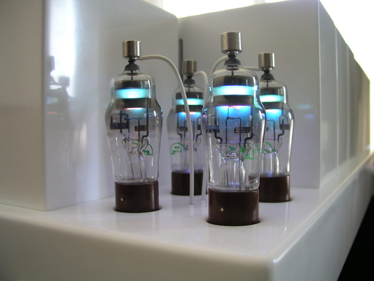

Killing machine. It needs dense robust cage around it.
Edit: or, at least around this tubes:

Lovely. Bu t I'd like to see the Corian lined with mu-metal. I've worked with Avonite a lot which is the same solid acrylic as Corain but not from DuPont and they sell Avonite to anyone. Drills & taps nicely. Invisible seams. Sands & polishes to a nice finish.

The tube caps are still missing, waiting for them!
Why use a cage around it? Afraid of being killed of electricity? Not a chance!
If you want to commit suicide, there still exist other alternative ways 🙂
And much better! And faster of course!

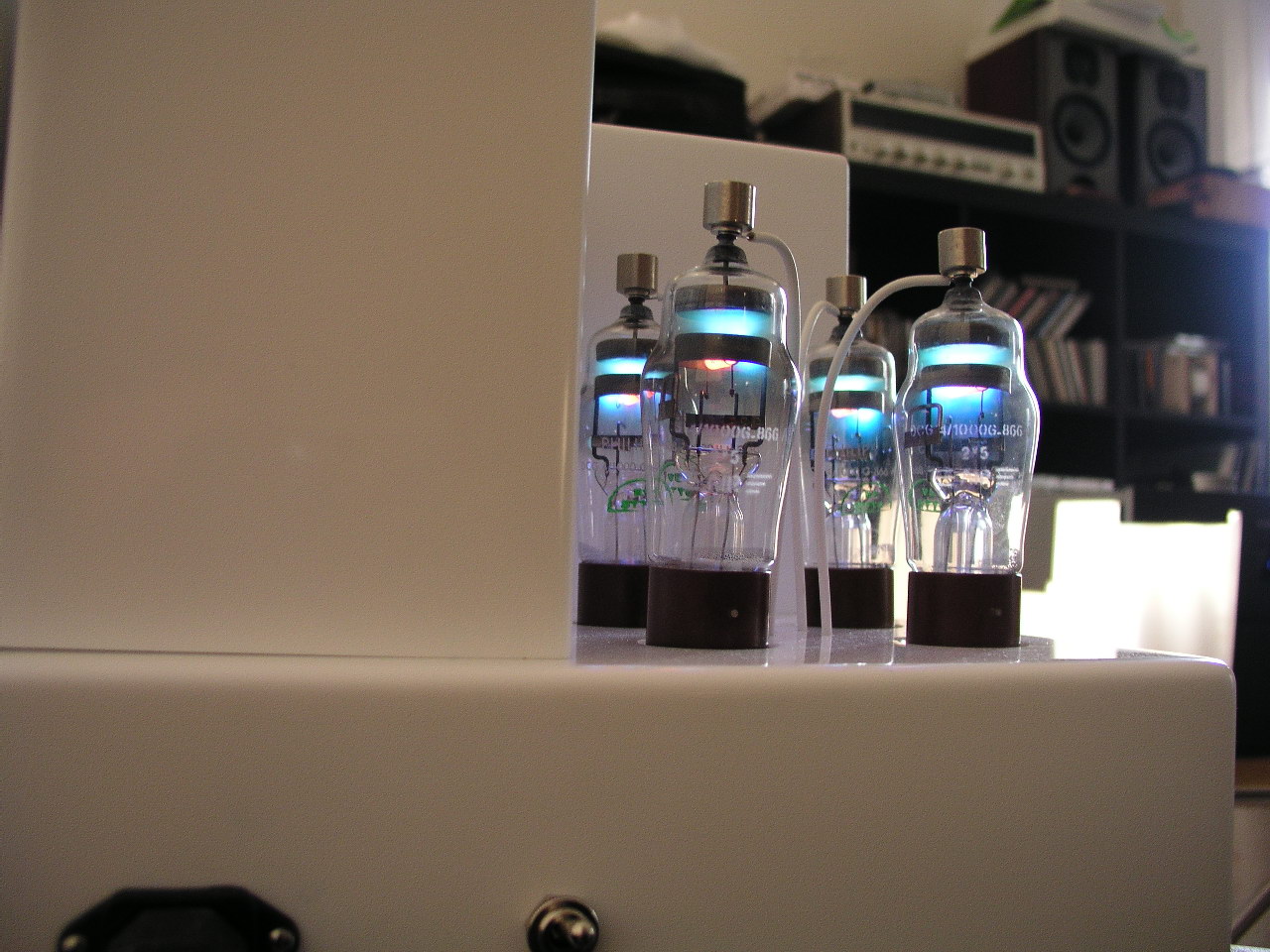

Consider some tempered glass to protect the hands from the mercury rectifiers??
Ceramic plate caps are insufficient, better than bare metal, but insufficient, imo.
also watch the temp inside the xfmr cans... best to provide some cooling paths from below at minimum...

Yes, corian and other solid surface materials finish up very nicely.
