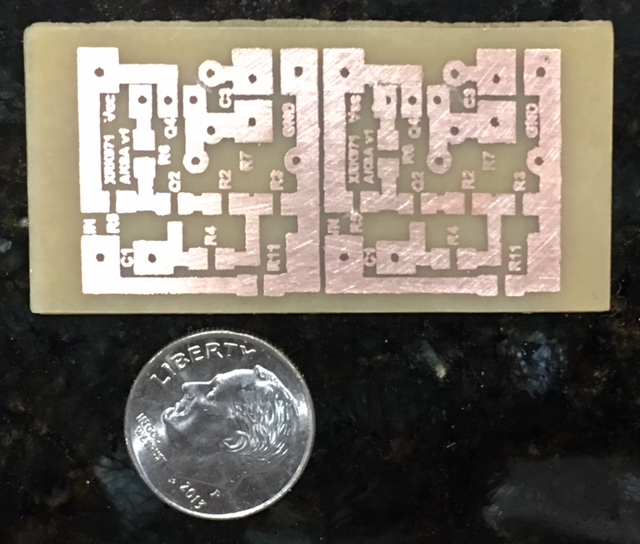

Which resistors do I adjust to get the bias of the LU1014 down lower? Thanks for all your guidance on this Hugh - it's been a cool and learning filled journey.
Just finished etching PCB. Will need to trim some bridges with xacto. Board is 25mm x 53mm (sized to fit Altoids tin with room for two 9v batteries). Actual boards are 22mm x 22mm each if made as small as possible. It's a tiny amp. Heatsink may be a problem though. If running 100mA bias that's about almost 4w dissipation for both channels.

... Which resistors do I adjust to get the bias of the LU1014 down lower? ...
If you bothered to understand Ohm's Law and read Borbely's article you wouldn't have to ask that.
Sorry, but I never understood how people are so willing to wield the soldering iron without a slightest effort invested into understanding how the components and circuit works...
Aksa, you misinterpret me for a second time. I begin to think that you are doing it on purpose. I am trying to stimulate him to learn how to catch a fish so he doesn't need to depend on "guru". That's not sneering but a sincere help.
I'm sure you'll try active loading, cascoding etc. soon enough and find out what you like the best.
For starters, try C1=2.2uF and C5=470uF (with values as shown in sch. too much of the low frequencies are cut off and the phase shift is way too big, and that's easy to hear).
If my Abacus works, a suitable value for C5 to work with my 40 Ohm HP would land a bit above 3mF, eg. a standard lyte size would then be 3300 uF, ugh??
