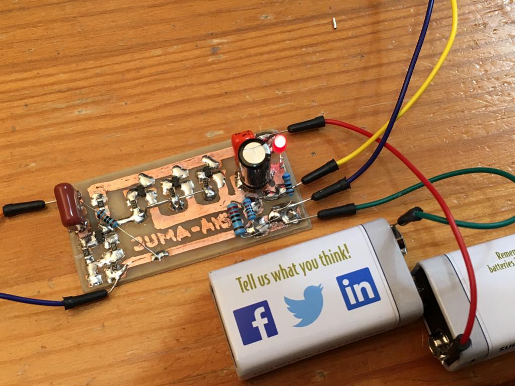

I managed to find three JFETs with Idss = 14.4/14.5/14.8 mA and used them for the three outputs and a JFET with 13.8mA on the input stage. I am using a 47R source resistor for the input and this gives me about 8.2v at the drain of Q1. Bias current in the input stage is 7.5mA as measured across the 270R resistor. The overall bias on the output is 37mA or about 12mA ea as measured across the 1W 220R source resistor. My cellphone doesn't have quite enough oomph to power my DT880-250's to loud levels. However, connecting it to my DAC, it can get loud. I am using 560nF 100V Panasonic MKT input cap, 47uF 63v Panasonic EB output cap bypassed with 1uF 63v film cap. I have 270R load resistor parallel to my phones and did not notice a reduction in amplitude when that was connected or disconnected. Leaving it in to drain that cap to reduce turn on thump when plugging phones in.
Sound impressions: quite nice, very good bass, clear mids, nice detailed highs. The bass is not as deep as my big amp, title of this thread - but then again, that amp has a 100w toroidal trafo and uses big IRFP240 MOSFET and LU1014D JFETs. However, it feels like the mids, are not as rich - not sure if that is simply because listening in mono. Hard to really tell in mono, but I can't hear any distortion. I will have to listen in comparison to my other amp to give more comparative data. For now, just reporting that it works and sounds pretty good for such a simple circuit.
I can see how this might be a slick portable CMOY type amp in an Altoids mints tin. It will need more gain to be driven from a cellphone though. I just noticed there is no global feedback on this amp.
For now, it is playing in one of my ears and I am trying different tracks that I know. It's doing a decent job on deep bass House music, jazz vocals, pop, rock...

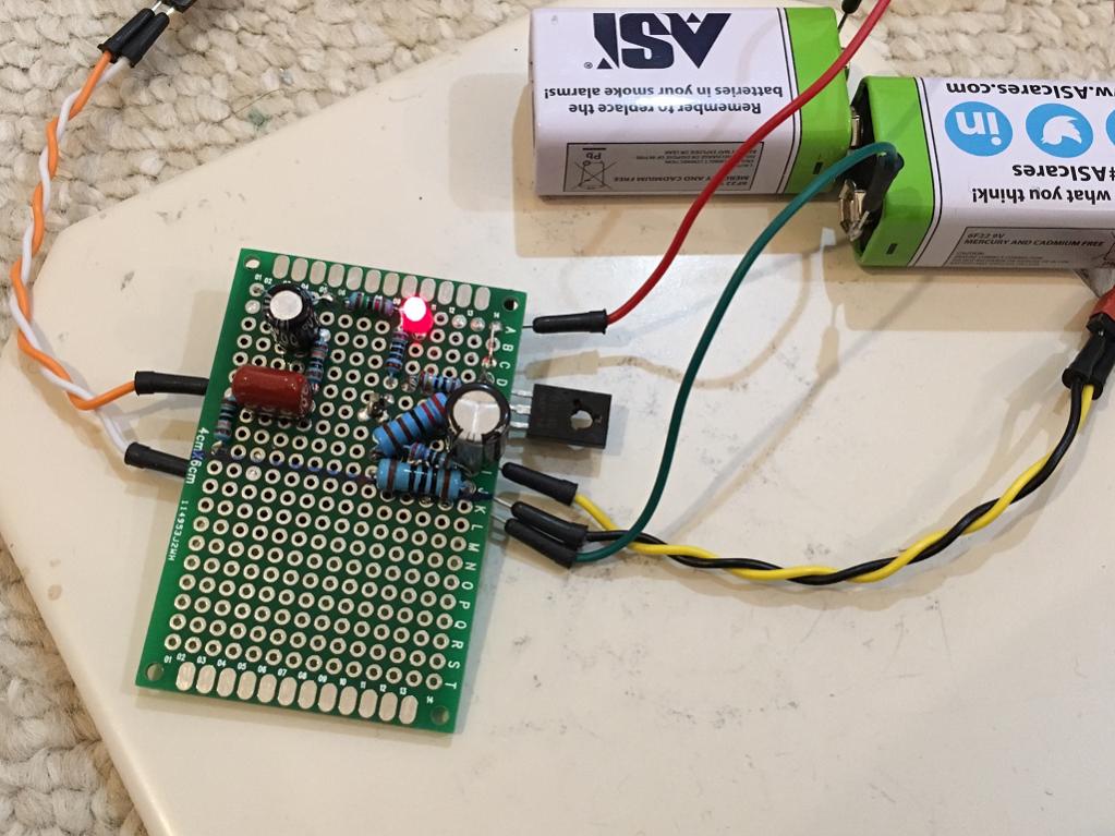

BF862/BD140 SE Amp
I quickly threw this together on veroboard. I even left room for a second channel on a single 6cm x 8cm board. It sounds really nice and clear with impactful bass, but volume is very low (by maybe 10x) even at full volume on my DAC. So not sure what is wrong. Maybe I have an incorrect resistor somewhere off by 10x? I am using 15k instead of 12k, and 100uF instead of 47uF for C3, but that is the only one that is off spec. I am measuring 28.2mA across the 100R source resistor.
Edit: I found a mistake, I had a 2.2k instead of 220R on the collector of the BD140. Changed it out and the volume issue is still not loud enough. Hmmm...
Ok, it's late - will have to debug another day.

Why is the output level of the single BJT so low? Could use of 15k where R7 is be causing too low of a bias voltage on gate of JFET? Is it a matter of not enough gain or do I need to increase bias current? When you say replace with P channel mosfet could IRF9610 work?

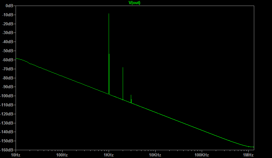

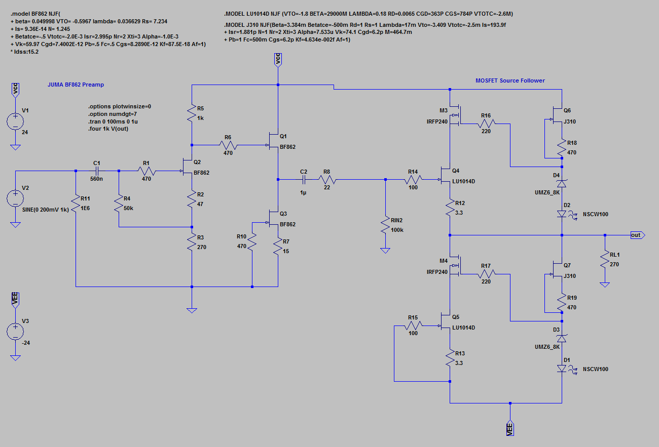

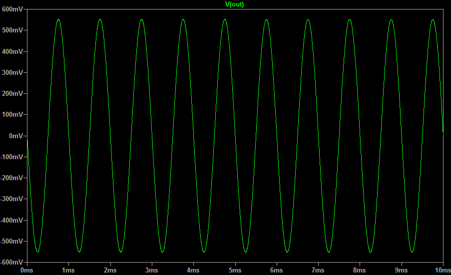

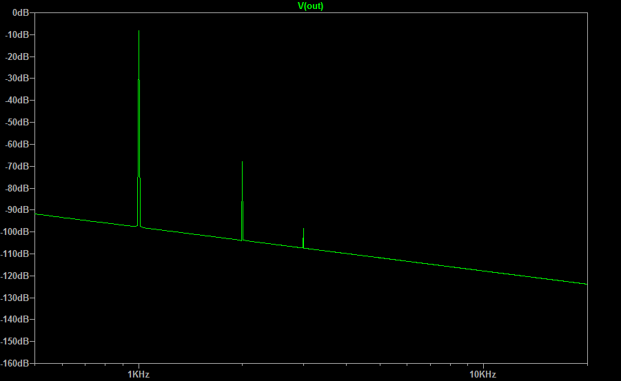

Playing with LTSpice
Still learning LTSpice and tried to model Juma BF862 preamp and EUVL source follower power amp (with J511 replaced with J310 CCS and zener-LED combo) together as system. Implementing Aksa's recommended change of R4 from 220k to 50k significantly reduced predicted HD.
Schematic:
Sine of 1kHz:
FFT (as predicted shows predominant H2 and very low H3 for great sonic signature:
Schematic:
Sine of 1kHz:
Very nice work X,
I like the predominant H2 and very low H3. Now we need to get Prasi involved...lol
Do you get the same sonic signature with a 60 ohm load ?
Thanks,
Eric
Here is sim for 60ohm load - still excellent.

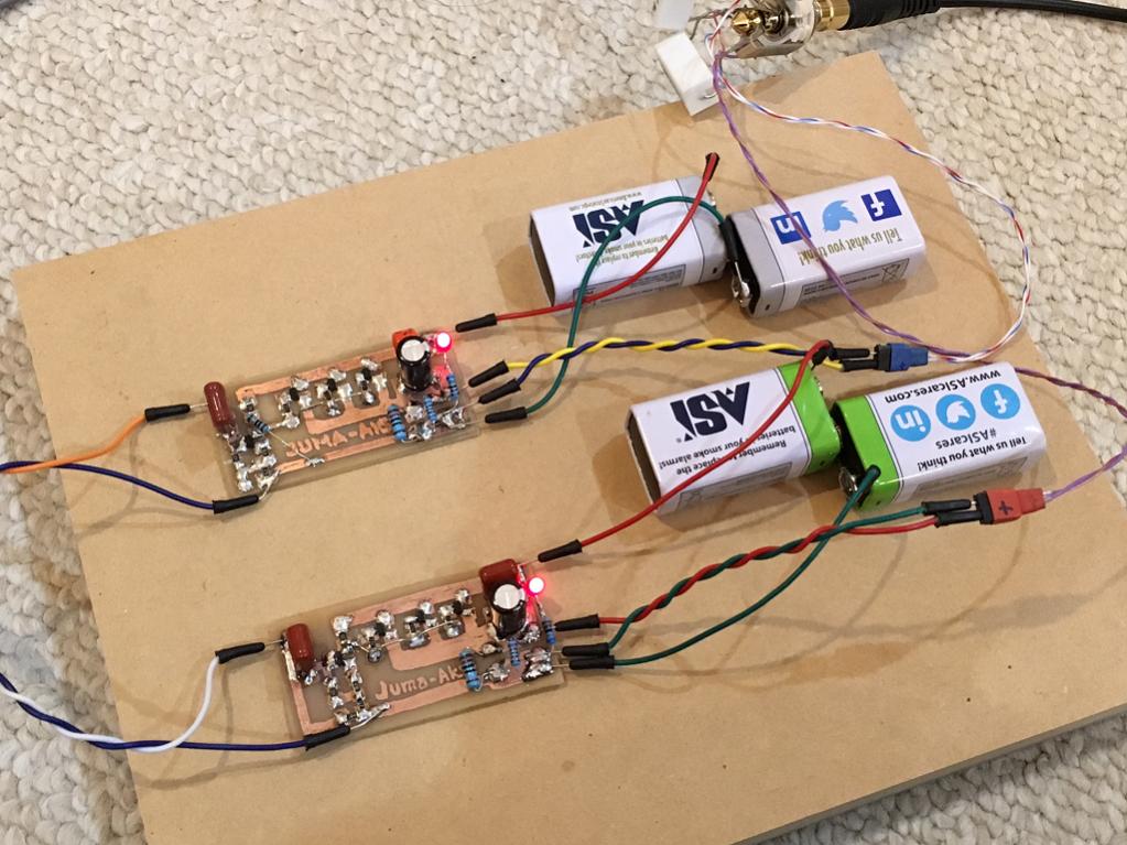

Juma-Aksa BF862 Amp in Stereo
I just built the second channel from start (etch PCB) to finish in record time of 90 minutes. I am using my last set of matched BF862's for this amp.
Listening to it now. Vocals test track with mids and highs are extremely clear and transparent. Very nice. Test track with bass is very good but not as powerful as my big LU1014D amp - but that amp is like the penultimate bass monster. Very nice still. Amazingly simple and effective amp and runs off a pair of 9v batteries. A set of 600mA Li-ion should last about 6hrs (total draw of about 90mA for both). I really think people will enjoy listening to this headamp.
It makes a big difference to have it in stereo to truly experience the bass and the soundstage. Amp is silent when no music playing. Of course with batteries there is no hum.
I can highly recommend this amp.
Edit: after listening to some Deep House mix tracks, the bass is surprisingly deep and powerful. Very full and rich - not weak in the least. Just making sure people don't get me wrong when I compare it to the big amp. It still shakes your head with the pounding beats on dance tracks.
