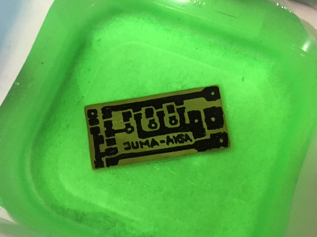

Etching in progress... I figured I would just make the amp board and use the input stage as the matching rig. This was hand drawn with just only a Sharpie marker and is missing a 100k input resistor which I can add with a through hole jumper resistor to GND. This is some old solution so is taking longer than usual 20min.

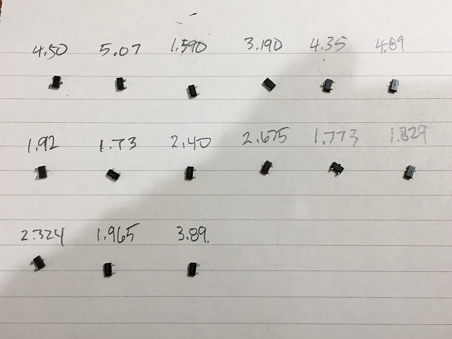

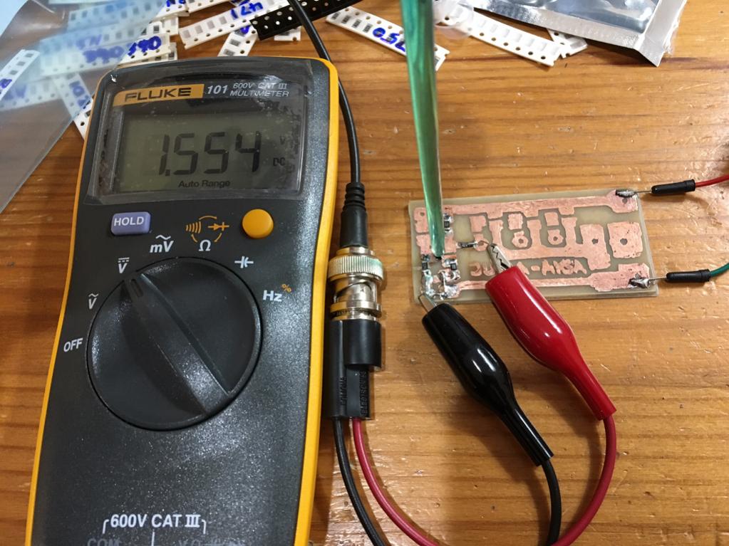

Hugh,
I set up the rig as described with 1k on Drain to 18v, 220k from Gate to GND, 10R from Source to GND, and measured at Drain pin relative to GND. I get voltages that are in 1.5v to 4v range - looks more like typical Vgs values rather than the circa 8.5v you are predicting. Did I do something wrong? I m using two 9v batteries in series so voltage is 19.5v. I think the particular BF862's I have need higher Source resistance to get the voltage up. I seem to remember running into his issue when making the preamp and changed Source resistor to 47R.
Here is jig with the JFET being pressed by a non conductive push stick.
Here is what I measured with my remaining BF862 JFETs:
Your measuring jig has to hold some conditions at some steady known values.
You need to hold current constant, or Vgs constant, to be able to compare devices.
I think you have described a source resistor and a Vds.
If the Idss is different then a different current passes through the resistor. This leads to a different Vgs and thus a different operating point.
Pick a few devices that end up very close to each other.
Measure the Idss and then compare these few at a suitable Rs to give the Vds you require.

Hi Hugh,
What would a circuit with the outputs as ZVN4306GTA look like? Since it is not depletion mode it needs a bias source now. Usual zeners and JFET CCS's to set bias?
X,
I've had more time to consider it. I think we need to select for Idss, so connect gate AND source to ground, and then measure the voltage across the 1K, which is same position from drain to Vcc.
Then select on Idss, running the source followers devices with current at 2/3 Idss. If you select three at 12mA, run each at 8mA, same circuit as agreed.

Ok, I will remeasure based in Idss. I wonder if there will be any correlation to the drain-ground voltages I measured earlier.

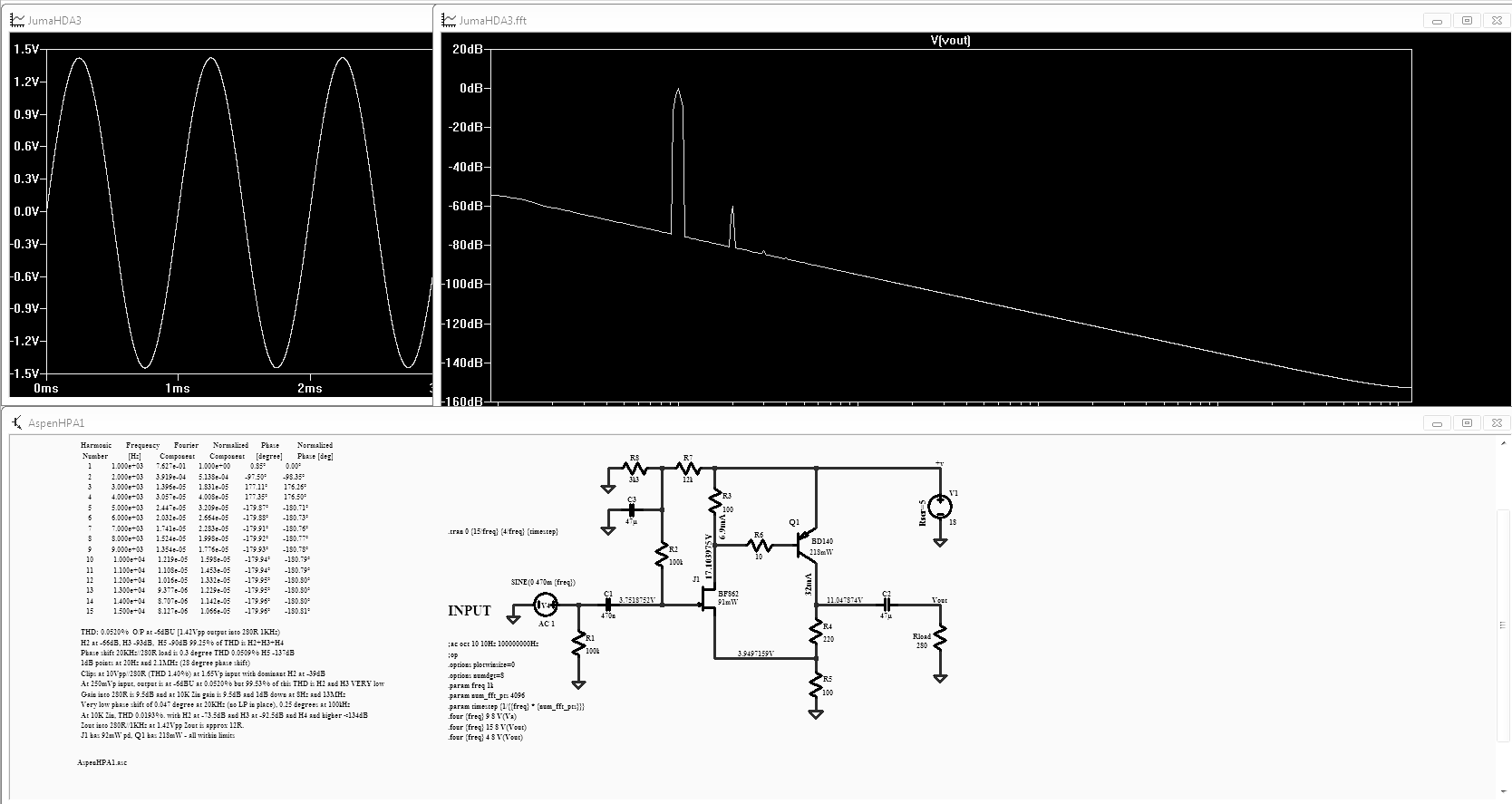

New Circuit
I have reworked the original design to maintain the jfet sonic signature, give more peak to peak output from 18V rail, drive low Z cans, and reduce the distortion across the board.
I built this some years back and it sounds stunning. It needs a BF862 with Idss selected of 10mA, and a BD140. Phase shift at 20KHz is only 0.3 degree.
HD
Founder of XSA-Labs
Joined 2012
This is really nice Hugh. So many choices now! How can you beat 2 transistors? Your circuits are refreshingly simple and have only H2 and very low H3 which I really like. I would probably still make this as mostly SMT board with room for through hole BD140. If I heatsinked it well, what changes would be needed to get 50mA bias? And would that help SQ? Is this still a pure class A amp?
