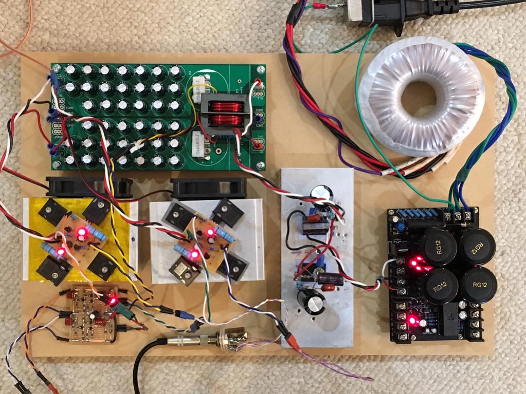

My system is finally completed with proper power supply: 20VAC 100VA Antek toroidal providing +/-28.4V rails feeding a 20mF per rail COTS PSU with turn on delay relay, this then feed a Juma MOSFET cap multiplier which knocks it down to 24.5v rails and zero ripple, this then feeds an RLC filter cap bank with 20 x 1000uF caps per rail for low ESR. The Juma BF862 single ended preamp is fed upstream of the 0.47R de-coupling resistor following L and before the cap bank to help isolate the main amp transients from the preamp supply at +24v. This setup provides a 2.5mOhm ESR (50mOhm/20) 20,000uF supply rail which is shared between both channels. I know, I did not do monoblock PSU's but I figured that since I will be using a crosssfeed circuit, cross-talk isolation isn't top on my list. Anyhow, PSU ripple measures 0.000V (scope shows small 3mV spikes at MHz range from somewhere). Output of amp measures 0.0mV on DMM with input turned off (not shorted - DAC still connected).

System laid out on wood board:

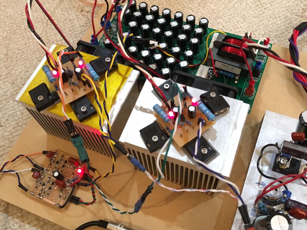

Closeup of preamp, amps, cap bank:

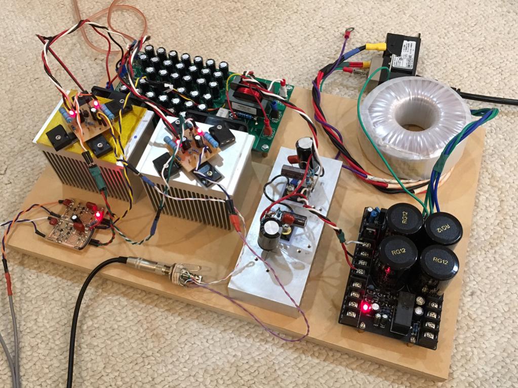

Top view:

Anyhow, it's working very nicely. Absolutely dead silent when nonsignal playing. Bass like I have never heard before - that cap bank makes a difference. Head shaking bass. Everything else is great sounding as well - clear smooth midrange, lush vocals, superb highs with clarity and no audible distortion. Piano is a good test track to listen for distortion and piano sounds great. Anyhow, a wonderful sounding head amp.
