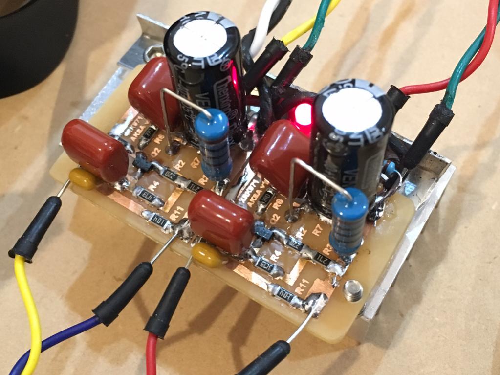

Aksa-xrk971 JFET HA works!

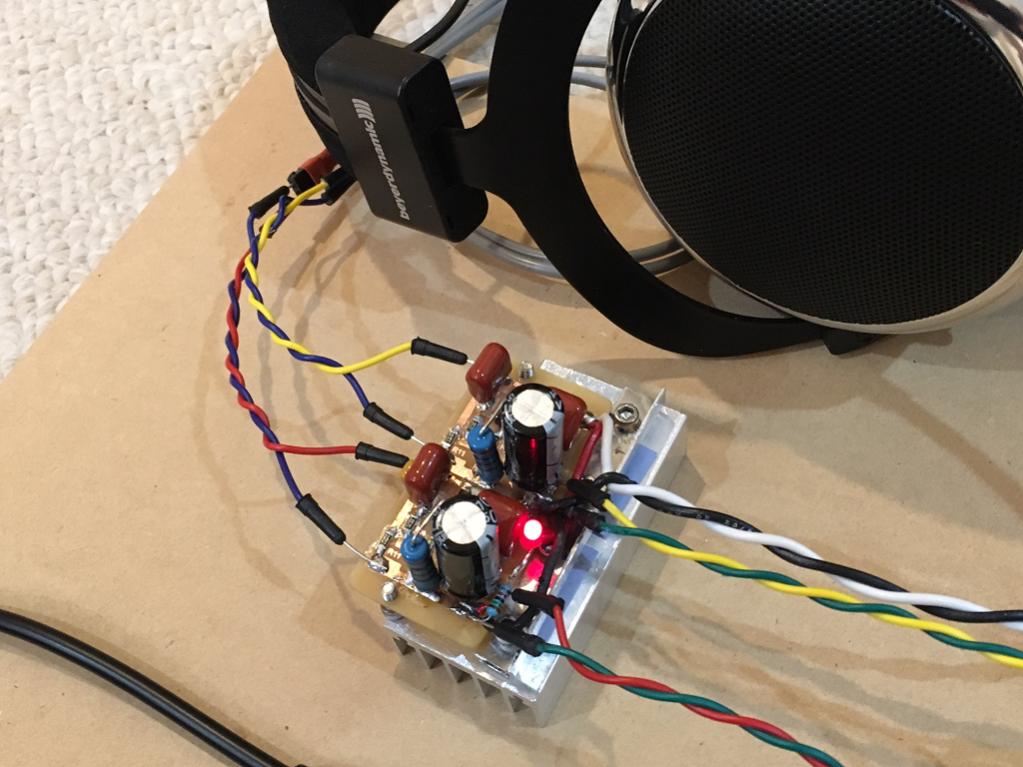

I just finished the amp and fired it up just minutes ago. It's a miracle it works the first time with no smoke or fire. I am using a 19.5v 4.65amp SMPS laptop brick for PSU raw (no filtering for now).
The board is so small, it was kind of a challenge to squeeze some of the through hole components in there. Juma recommended a 470uF output cap so I am using a rather dubious brand (as cheap as they come from China Chenxing brand 470uF 50v 105degC) but bypassed with 1uF 100v MKT. On input I have same 1uF 100v MKT paralleled with 10uF 50v MLCC to get the deep bass. I ran out of 47R SMT so using 39R gate stoppers. The source resistor is a metal thin film 100R 2w mounted vertically to fit. The LU1014D's are very securely fastened with a small L bracket clamp held in place with four 6-32 hex cap screws pressing down on power JFETs against silicone transistor pad.

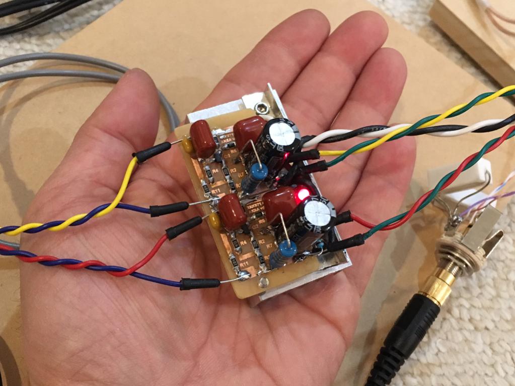

It is a tiny amp! Look at the scale relative to the headphones. I am measuring 104mA bias current per channel. That's basically 19.5v x 0.104A = about 2 watts dissipation per channel or 4 watts total. Heatsink seems appropriately sized, hot but not unbearable to touch. I can hold it for over 20 seconds before it is uncomfortable.
I am listening to the usual YouTube dance mixes to give it some time to burn in. Sounds quite nice. Very clean and excellent sonic presentation. Bass is very good.
I will post detailed listening impressions soon - but so far so good. That laptop SMPS works surprisingly well. No fuss no muss type of PSU for a head amp 🙂
Edit: you have to see this thing to believe it - how such beautiful powerful sound can come from such a small two transistor amp? Here it is singing in my hand!

Female vocals are extraordinarily good. Kind of like voice of angels stuff. Just enough second order harmonics and sans any significant third order (or higher orders) for euphonia. It really is quite nice - just very clear, not a hint of sibillance or harshness. Smooth like a glassy smooth lake surface. This amp is the real deal. 😀
Thanks to Hugh for the guidance to make this little gem. 🙂
Edit: just listened to Nils Lofgren's Keith Don't Go. The attack on the guitar strings is outstanding - very clear and great dynamics. Very powerful, precise, highs are far reaching with no hint of harshness. Bass from guitar slaps are very good - a visceral thump. 🙂
Now I have to compare it with my big amp...

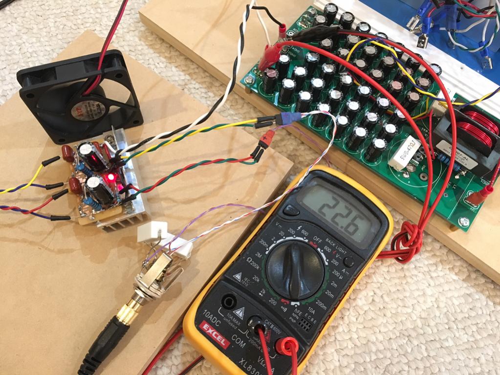

The big amp still sounds better from a bass impact and overall dynamics. But it may be just the fact that it has an uber good power supply with cap Mx and low ESR cap bank. I will tap into the big amp's positive power supply rail of 20.5v and feed the new 2 JFET amp with it to see if the performance improves.
Not a fair comparison if you look at the supporting PSU for the big amp:
587956d1482828357-mosfet-source-follower-headamp-mosfet-follower-ha-boxed-test-01.jpg
vs the 2 JFET amp's SMPS brick:
Ok, I connected the little amp to the big power supply with cap Mx and LC cap bank. It is reading 22.5v and bias current is now 130mA. The 2w resistors are probably running too hot as I can smell something funny so I put a fan on it. 1.7w is a bit close to rating of 2w.
The sound is more transparent with ability to resolve very low level details. The bass has indeed improved quite a bit. I think overall it sounds pretty amazing now. Will need to listen more to see if it equals the big amp.
It's sounding very very nice with a good cap Mx and low ESR cap bank for a PSU. The increased voltage may have something to do with it as well.
I just put the Deep House dance mix on and getting some real deep bass with superb authority. Amazing sound coming from this tiny two transistor amp! Very very cool.
I will have to make dedicated cap Mx and low ESR cap bank for this guy. They make a huge difference.

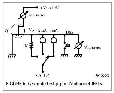

Also, from the Borbely article that Juma pointed out, in Fig. 5 of the first one looks like a pretty simple testing system:
I will see if I can sneak some time out of my day to try this. It's made easier with a solderless breadboard and 3-pin screw terminals for installing the JFET. I currently am lacking a good lab grade PSU so may just use a 9v battery.

Now that we can select LU1014D with a 0,01 V increment between 0.62 - 1.22 Vgs, what would be a suitable Vgs value to pick, maybe Hugh can chime in on this.
Thanks I will look into it as an option, and thanks also X for the test jig thingy info.
Yes, Hugh will have to advise. I am just still figuring out the bias points between the gate and source that Hugh was discussing earlier. Vg-Vs at steady state operating point is a negative number. I wonder if that is the Vgs we should be looking for?
Best Vgs at 100ma Id is around -1.1V.
However XRK'S amp came at -1.8V at 120ma Id and his sonic testing seemed very good
Conclusion: Since these are tough to source any LU1014D would be fine because in self-bias source follower we are leveraging the high transconductance and tke low, 6.5 milliohm Rdson.
