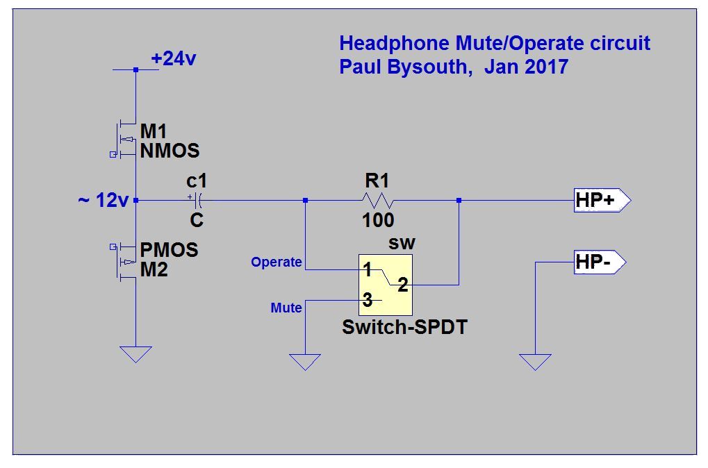

xrk971,
Back at post #176 you wrote that you had a small oscillation when you plugged in your headphones. I suggest you use a circuit like I've attached between your headphone amplifier and the TRS headphone socket. Put the switch into the Mute position when inserting or removing the headphone plug, and when powering on or off the amplifier.
In the Mute position the amplifier sees a load of 100ohms (though any value from 50ohms to 1Kohms would do), and in the Operate position the resistor is shorted out.
One turn on, the capacitor c1 (in my drawing) needs to charge up to its quiescent value, and you don't want this current going through the headphones. Also you don't want to short the amplifier output to ground when inserting (or removing) the headphone plug.

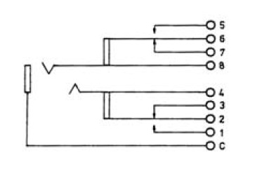

Paul,
Thanks for suggestion. I want to avoid drilling another hole for a switch. I may use pot with click on off and use that control relay. Your circuit shows 100R in parallel not shorted out when in operate mode. I actually have 270R in parallel already. These are soldered right onto TRS jack if you look at photo. This reduces overall impedance and seems to improve bass response in amp.
That looks nice but pricey. Here is plastic Neutrik that seems popular.
https://www.amazon.com/gp/aw/d/B00LVDYMVS/
But I really like the heavy duty nickel plated all metal ones I have - super durable click feel.
What?.....................Your circuit shows 100R in parallel not shorted out when in operate mode. ...................
The 100r is in series with the load. The 100r gets bypassed with the switch in listen position.
In the mute/standby position the 100r and the headphones are connected to Main Audio Ground.
Ok, yes sorry misread diagram - the plugin TRS jack with switch combined with this series load will probably do the trick without any drilling new holes.
yes

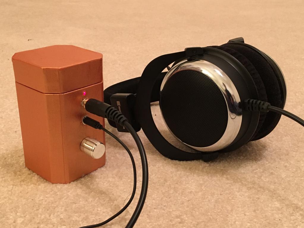

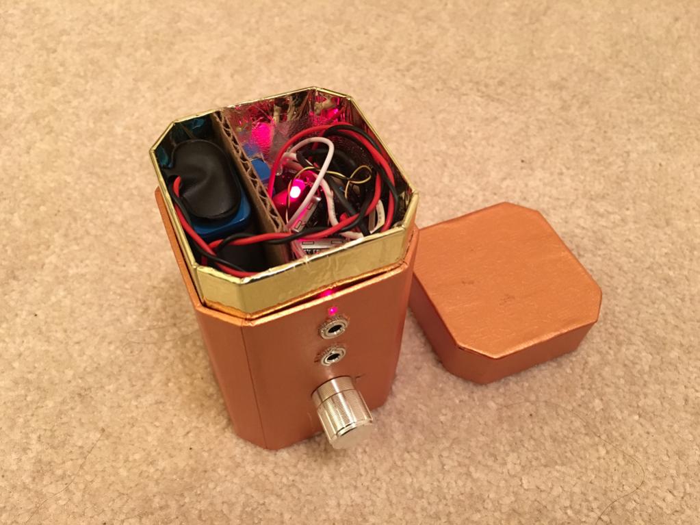

Portable Class A Tea-Amp (get it, "T" amp)
Remember this little hand drawn amp? I boxed it up with volume knob, input/output 3.5mm jacks, a power switch, and dual 9v Li-ion rechargeable batteries for a little portable class A action.
I managed to find three JFETs with Idss = 14.4/14.5/14.8 mA and used them for the three outputs and a JFET with 13.8mA on the input stage. I am using a 47R source resistor for the input and this gives me about 8.2v at the drain of Q1. Bias current in the input stage is 7.5mA as measured across the 270R resistor. The overall bias on the output is 37mA or about 12mA ea as measured across the 1W 220R source resistor. My cellphone doesn't have quite enough oomph to power my DT880-250's to loud levels. However, connecting it to my DAC, it can get loud. I am using 560nF 100V Panasonic MKT input cap, 47uF 63v Panasonic EB output cap bypassed with 1uF 63v film cap. I have 270R load resistor parallel to my phones and did not notice a reduction in amplitude when that was connected or disconnected. Leaving it in to drain that cap to reduce turn on thump when plugging phones in.
Sound impressions: quite nice, very good bass, clear mids, nice detailed highs. The bass is not as deep as my big amp, title of this thread - but then again, that amp has a 100w toroidal trafo and uses big IRFP240 MOSFET and LU1014D JFETs. However, it feels like the mids, are not as rich - not sure if that is simply because listening in mono. Hard to really tell in mono, but I can't hear any distortion. I will have to listen in comparison to my other amp to give more comparative data. For now, just reporting that it works and sounds pretty good for such a simple circuit.
I can see how this might be a slick portable CMOY type amp in an Altoids mints tin. It will need more gain to be driven from a cellphone though. I just noticed there is no global feedback on this amp.
For now, it is playing in one of my ears and I am trying different tracks that I know. It's doing a decent job on deep bass House music, jazz vocals, pop, rock...
