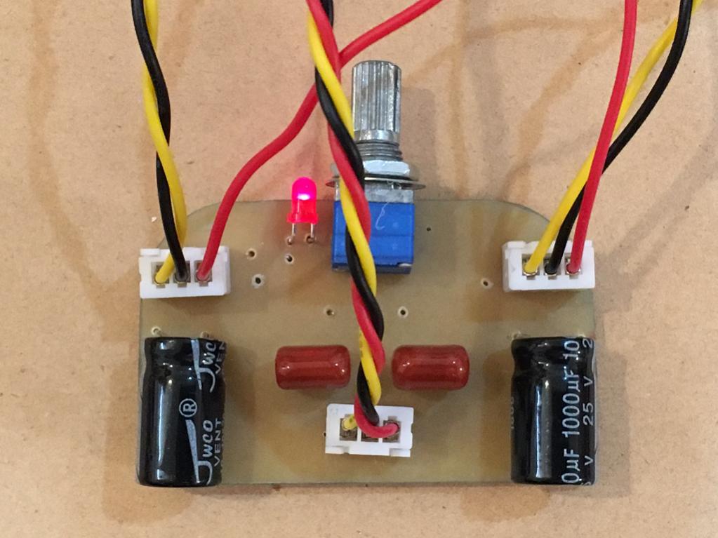

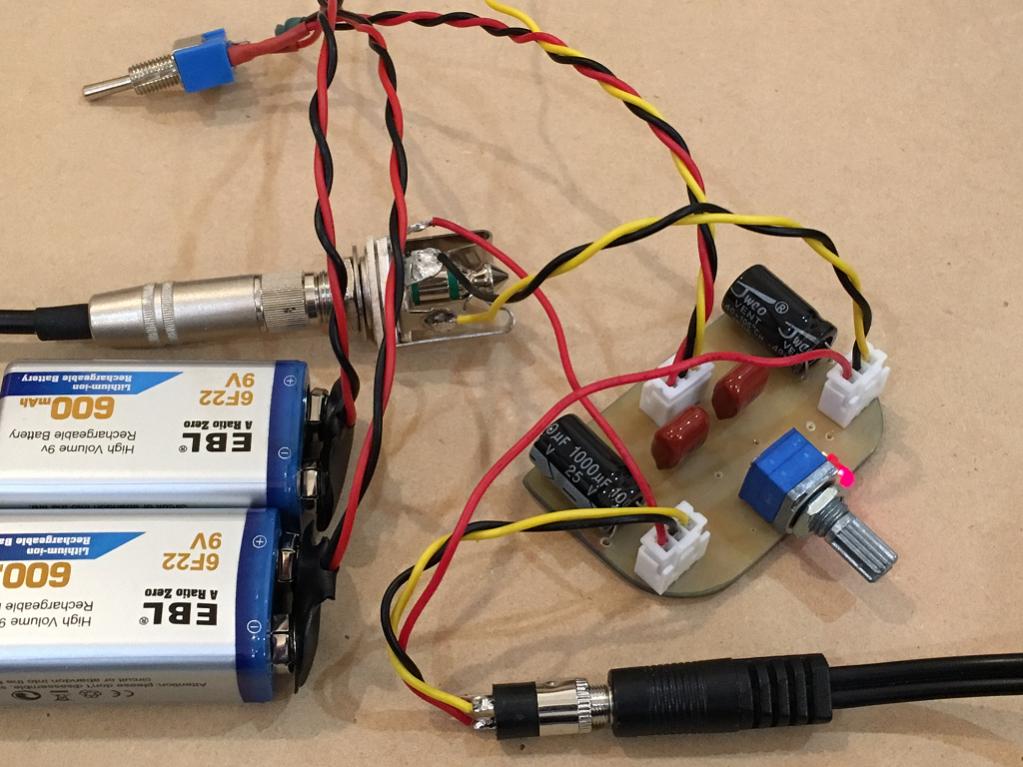

I put this 2 JFET amp in a case quickly so that I can take it with me out of the lab to enjoy music outside the lab. I am using a 24v 5amp SMPS, a Juma cap multiplier, and qnty 16 x 2200uF 25v cap bank for 35mF, that cap bank is connected via 0.33R to 5 x 2200uF cap bank 11mF after the 4700uF cap connected to the Mx. The 16 cap bank has 3.1mOhm ESR - this is good because it about matches the Rdson of the LU1014D for unmitigated bass authority. 😀 The 50k volume pot is mounted on a bare veroboard for addition of future cross-feed filter.

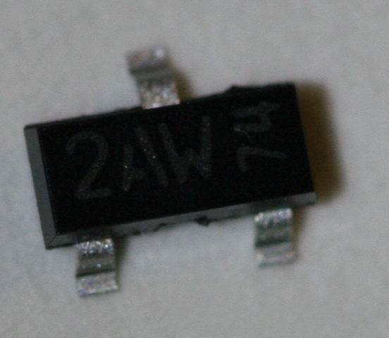

I don't speak about bf862 but i see lm4562 for 1$ ,10x2sk170BL for 2$ e.t.c😉I don't think anyone is going to bother faking a SOT23 BF862 at nominal $0.60ea.

I just bought 20 of each too.Can you read the code on the package?

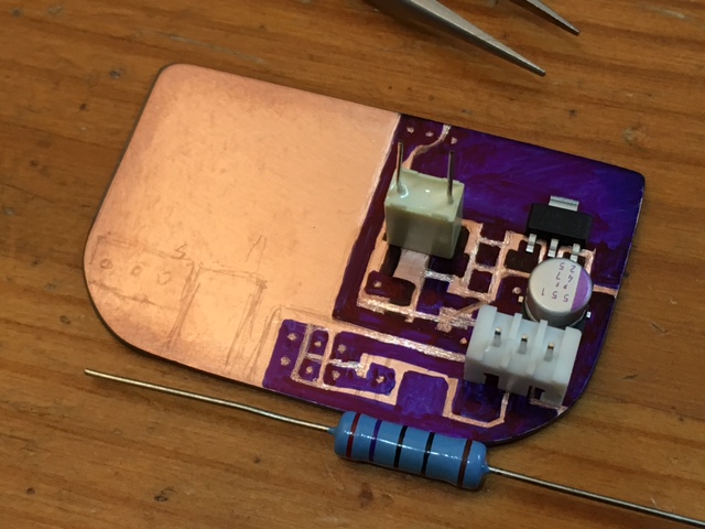

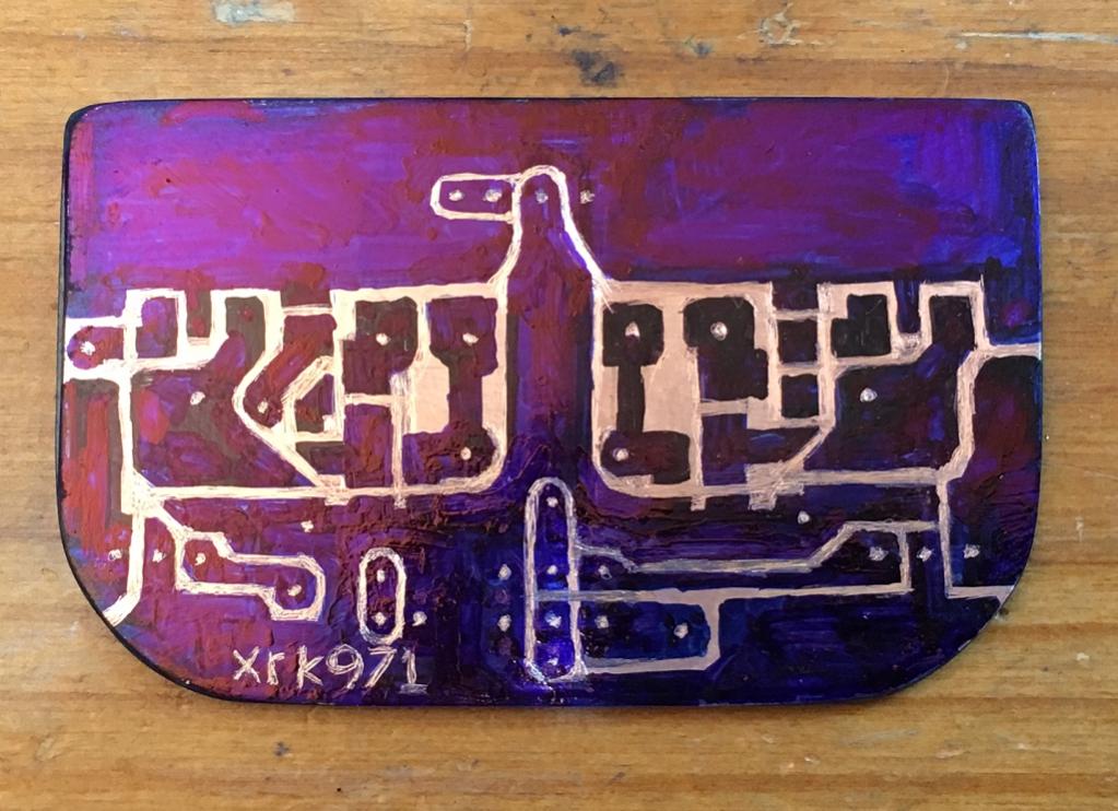

I am working on a slick little Altoids tin amp board using the ZVN4306 and BF862. I need to figure out values in order to set bias on MOSFET correctly - I am aiming for circa 60mA.
Here is half of the layout using a sharpie marker.

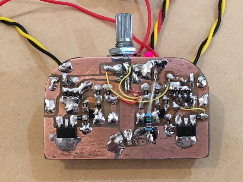

Well, I had a productive night. The BF862 and ZVN4306 amp is now singing. I had to adjust the input source resistor to 100R to get enough voltage at the gate of the MOSFET. I am running qnty 4 x 470R SMT source resistors in parallel (123R) on the ZVN MOSFET for a bias current of 67mA. I left a lot of copper plane for a heatsink for the MOSFETs.
Circuit follows this schematic but with LU1014D replaced with ZVN4036 SOT-23 but with R2=100R and R7=123R, R6 = 220R, and output C is 1000uF:
The SMT parts on on one side, which I will put in thermal contact with the bottom of the case. The through hole components are on top and will be visible,
Just tested a few songs - sounds very promising - nice bass, clear highs, smooth mids. Running from two 9v Li-ion batteries in series for 18v supply.
The board has been tested to fit in an Altoids tin with two 9v batteries perfectly.
Final layout before acid etch:
SMT side (I wanted to use nice 47uF OSCONs but change of plans put SMT on flat side next to case so no room):
Top side:
First sound test:
It's running now and temperatures are doing OK - not too hot. Sound is very nice.
