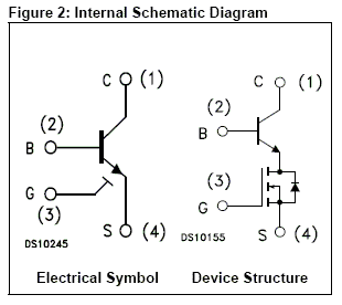

EVA -- have you seen this -- from ST Micro
I have seen a similar patent to ESBT years ago and didn't understand why will it work. If the bipolar transistor goes to saturation, the bias supply will feed his c-b junction's recovery current. I think the c-b junction could be damaged if the MOSFET is switching off too fast. 🙄 ?
