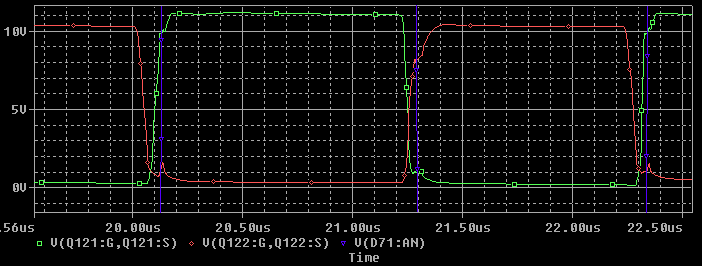

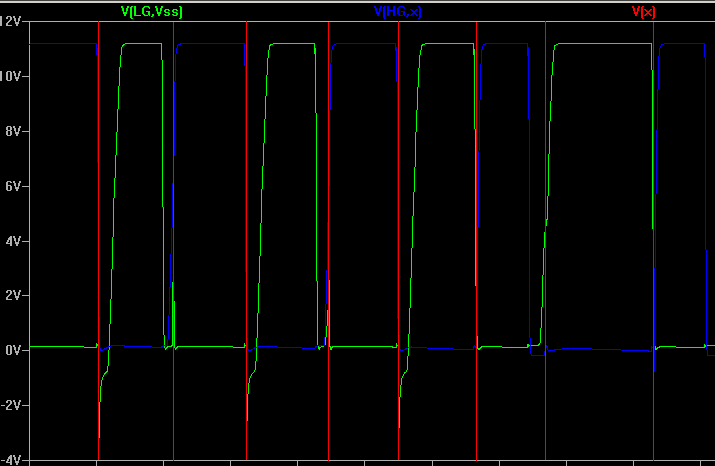

Jaka, good to know there's still room for improvement.. but it does seem like a neat idea. I haven't been able to get simulation waveforms ideal either, but it demonstrates the idea I guess.
Oh and thanks for the info, I am scopeless after all. It's still interesting to compare these waveforms to those of the much more complex rendition found in this thread.
