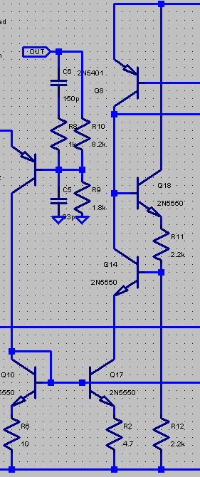

While we're on the subject, here's a discrete gate driver I came up with a couple weeks ago. It's only been built in spice, not real life. I was playing around with a UcD schematic classd4sure made and was unhappy with the amount of component dependency so I decided to take the comparator and feedback loop and design a new gate driver from scratch with no preconceived notions as to how it "should" be done.
Everything right up to the EF stage before the MOSFETs runs in current mode with little voltage swing so it should be pretty fast. Even though it's shown as UcD that may not be optimal, it requires more comparator drive than UcD feedback supplies at high outputs.
The .ZIP contains the .asc LTSPICE schematic file, and a .GIF version for those of you without LTSPICE. It was created on a clean four month old windows XP Pro x64 system running Symantec Antivirus and is completely safe.
So what do you experienced designers think, is this a workable design?

Hmmm, it's interesting.
Some of the interactions may be slightly reduced but it looks like they're all still there, even with 20V rails.
Watch how the thresholds and shoot through vary with output level.
I think the worst part would be trying to build in some adjustability over the gate waveforms with this one to achieve good performance, dead time, slew rates..
Tim, i think you have overlooked the problem of saturation delay in your voltage amp transistors. That would give uncontrolled turnoff delays in each transistor. Try looking at LS logic, how they have solved this problem. We are dealing with the same kind of speed here.
Further the devices you have used are not the fastest on earth..
Basicly you have only 3 ways of speeding up a drive circuit,
1..Use transistors with extremely low Ccb (can only go so low).
2..Use high collector current and high base drive to fight Ccb capacitance.
3..Make an ingenious circuit where the collector-base voltage is constant.

"Try looking at LS logic, how they have solved this problem. We are dealing with the same kind of speed here. "
Ah, clamping the base drive, good idea, though it does significantly increase component count.
"Further the devices you have used are not the fastest on earth.. "
Yeah I know, I tend to SPICE with positively average transistors, I couldn't tell you why
"3..Make an ingenious circuit where the collector-base voltage is constant."
Impossible to do directly before the emitter follower, and as far as I can see impossible to do with a bootstrapped high side gate drive. One could cascode the appropriate transistor and move the voltage swing to a different C-B junction, maybe even some sort of variable cascode putting half the total voltage swing across each C-B capacitance, I'll attach what I'm thinking.
P.S. The four Rs on the bottom do allow some optimization, I haven't fiddled with them too much, but it seems slightly higher values for R6 and R7 (15-33ohms) might be better.

Yeah I noticed that, like I said " it requires more comparator drive", maybe giving the LTP more current gain/lower impedance as seen looking into the emitters would fix it, sziklai pair perhaps?
Edit: Ok, here it is with a cascode and a sziklai pair LTP.
