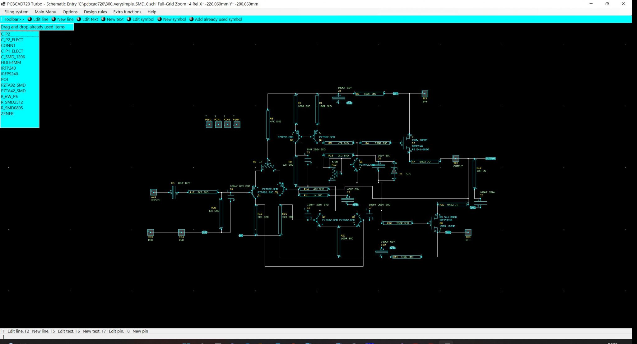

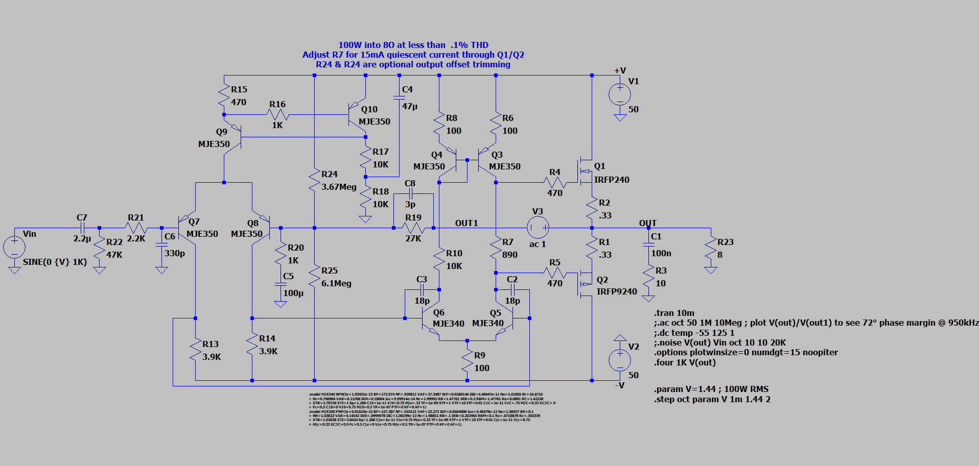

Here is my old design for 240/9240 output amp.
It uses the 1980's Maplin lateral mosfet circuit updated to use 240/9240 mosfets.

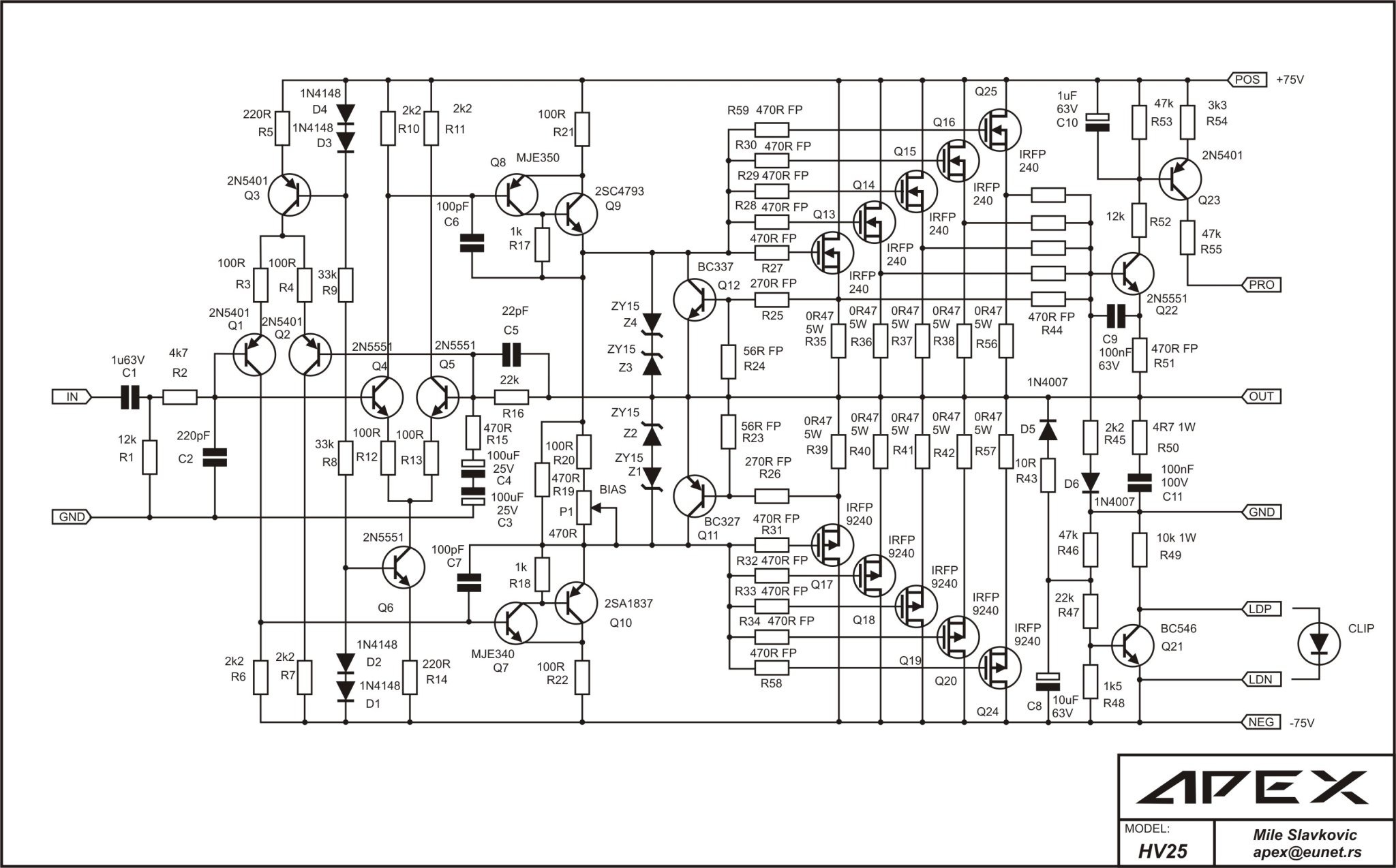

9240 and 240
are not complementary, look at the curves.
These are switching devices and its properties are not suitable for linear amplification
You only have to use N Channel Switching Mosfets. Build the same amplifier with just N-Channel IRFP240 and you will hear the difference
Then you will throw the 9240/240 Mosfet amp in the bin

Obviously, yes. It's like the expression "two left feet". Two N channel devices like two NPN is (usually) called Quasi complimentary, where the negative output comes from a CFP aka Sziklai, that use a PNP or P-channel driver. There is also the Circlotron topology (and similar) which are completely different and requires several independent floating power supplies, per channel hence not popular. Matching output devices can cancel even harmonic distortion, but that is contrary to phyco-acoustics that favors even harmonics. Instrument amplifiers deliberately create even harmonic distortion to improve the musicality of the instrument. This works because instrument amplifiers do not mix the sound of different sources. There is a You-tube video about Pass amplifiers where they recommend setting a bias offset to favor even harmonic distortion rather than the minimum distortion. Poorly matched complimentary devices may outperform Quasi designs because the speed and phase response are critical to stable feedback. Exicon makes Lateral MOSFETs especially for linear amplifiers and apparently the results are spectacular, but I can't speak from experience. The results using the IR devices can be very good, so cost and availability may be the deciding factor.
