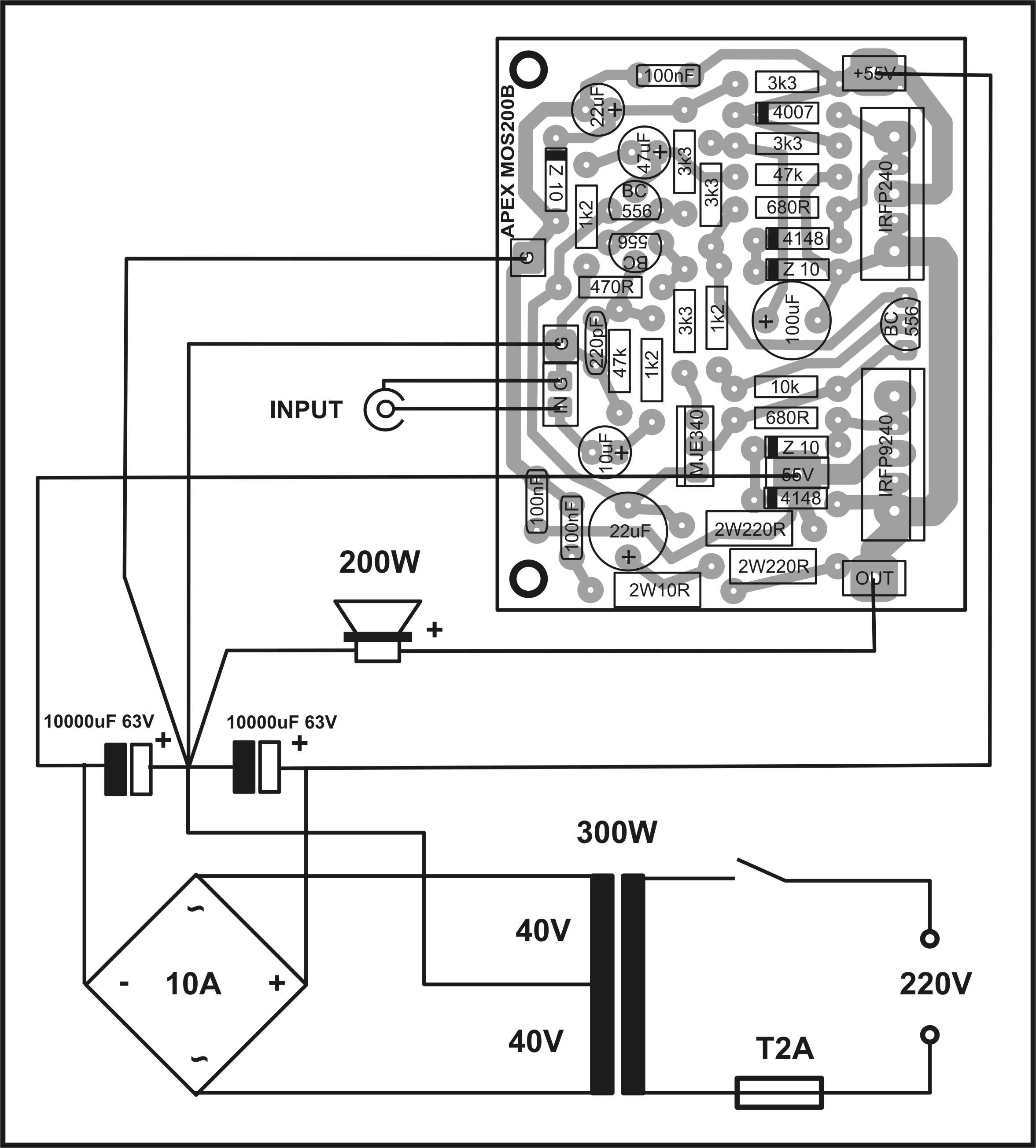

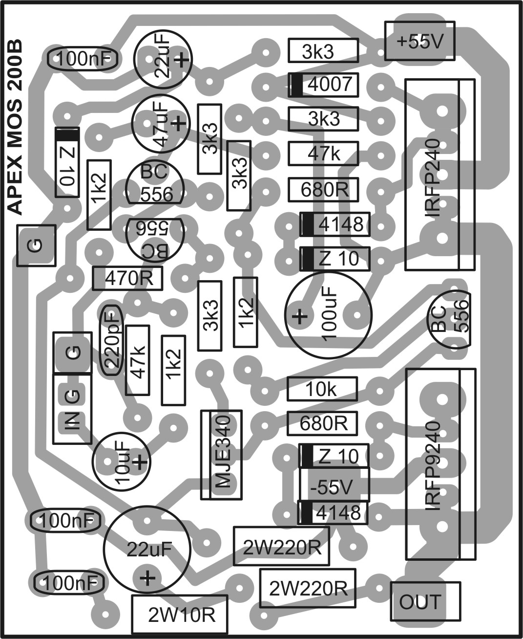

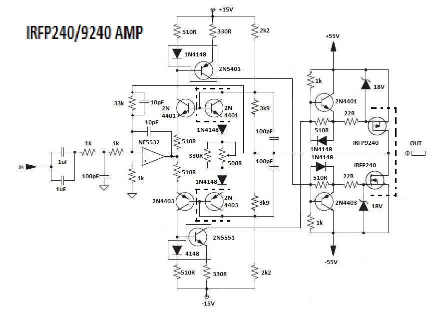

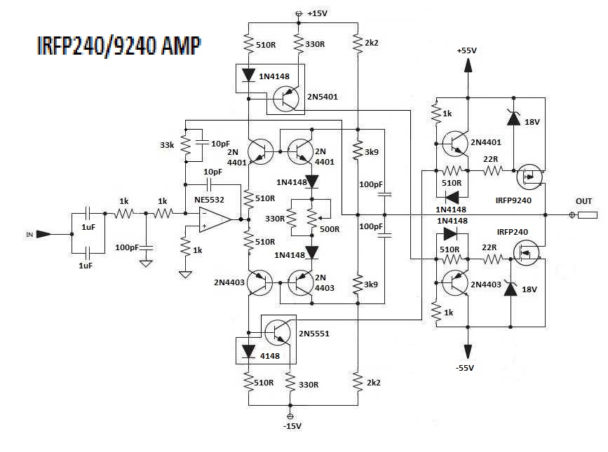

MOS200B

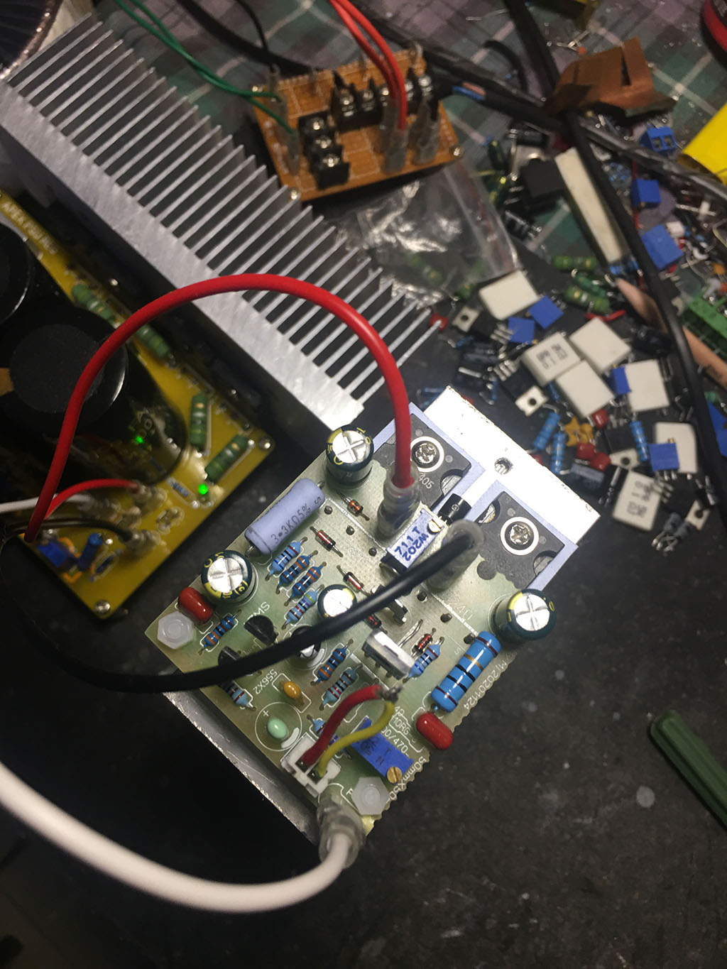

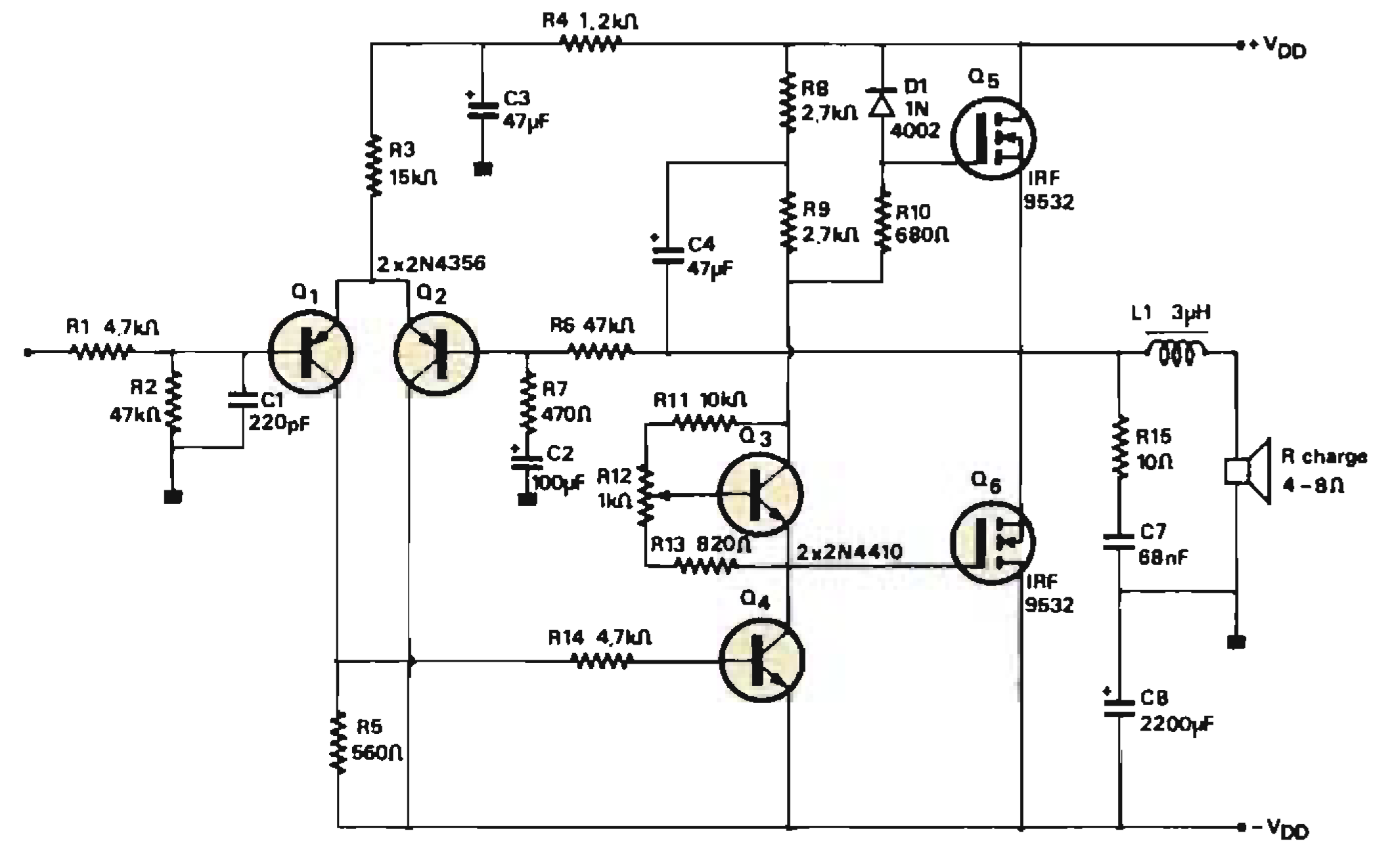

MOS200II

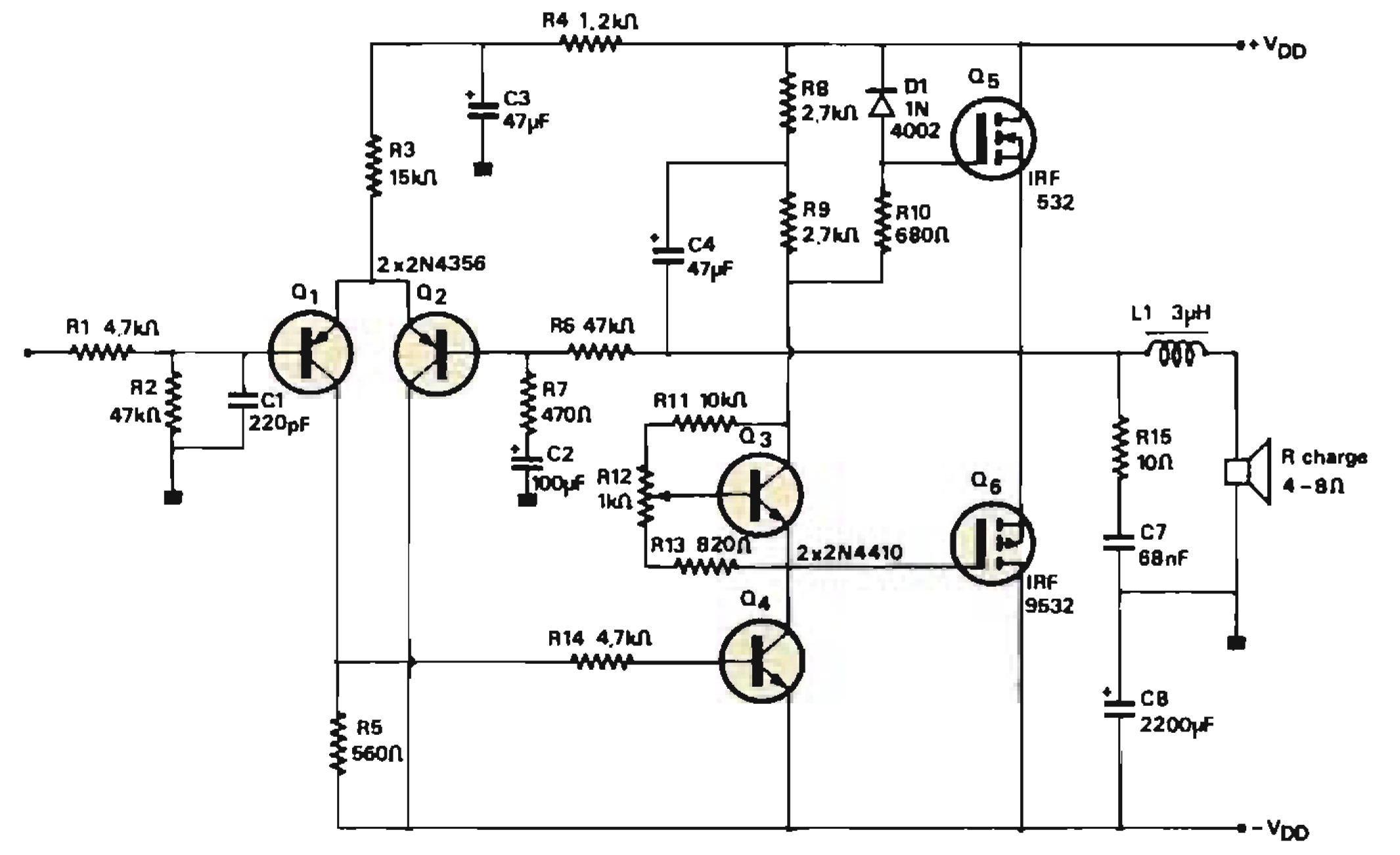

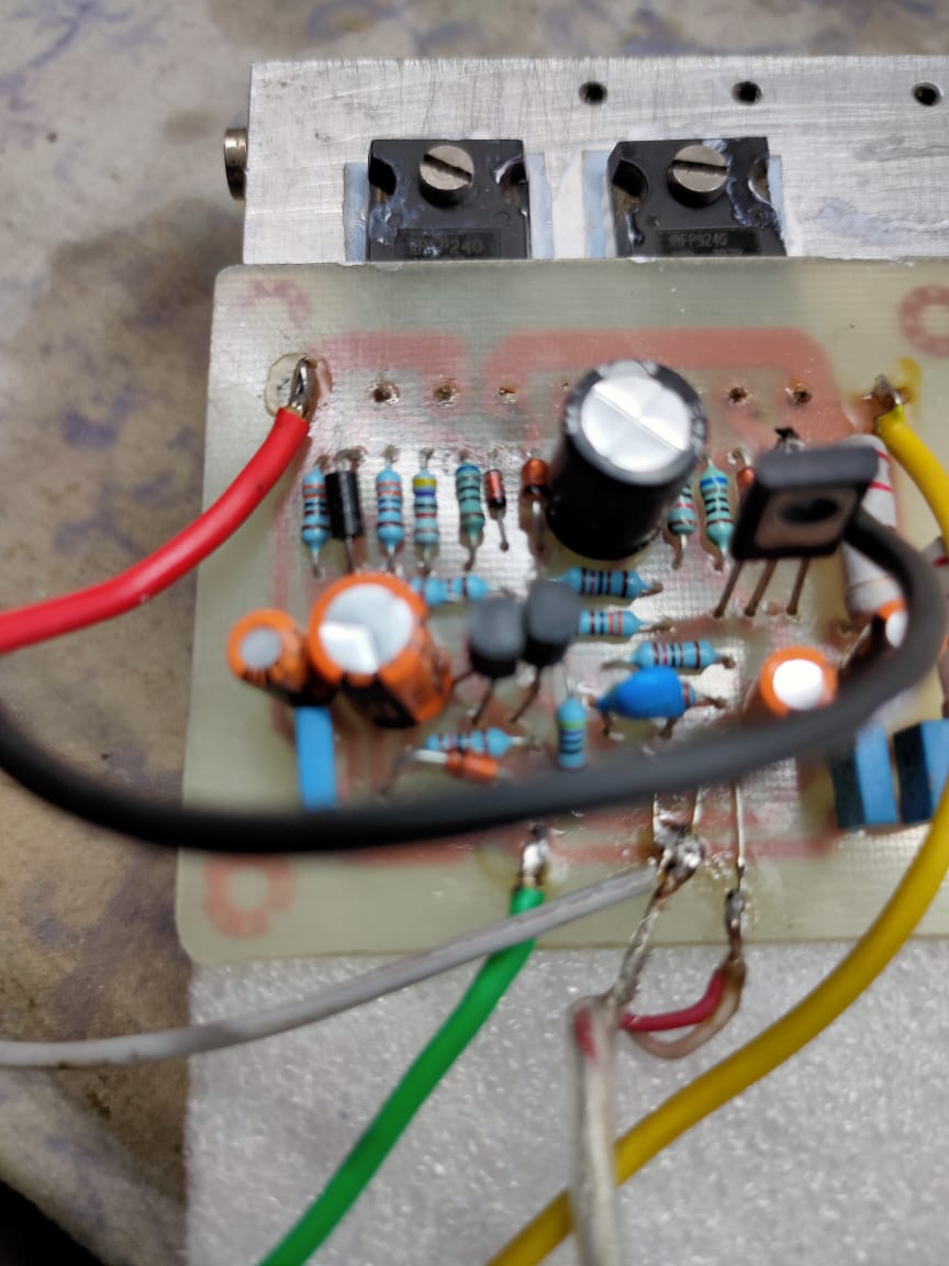

I use 55v DC, everything is the same as the schematic diagram, only changed two resistors to variable resistors, one is c-pole 470r, the other is bias 1.2k. I don't know why the simulation program can't get the correct bias and operation effect, but the real object can adjust the bias. I don't have 1n4740, I replace it with 12V 1n4742, but it will cause problems. In the input BC556, there will be a current of 3.5ma, which will be a little hot, I'll change it to 1n4740 or change the resistance value of 3.3k in the future to find a way to eliminate the slight rustling sound. The bass is very good. It doesn't need a fan. It can be installed in a 190mmx54mmx246 ultra-small chassis
