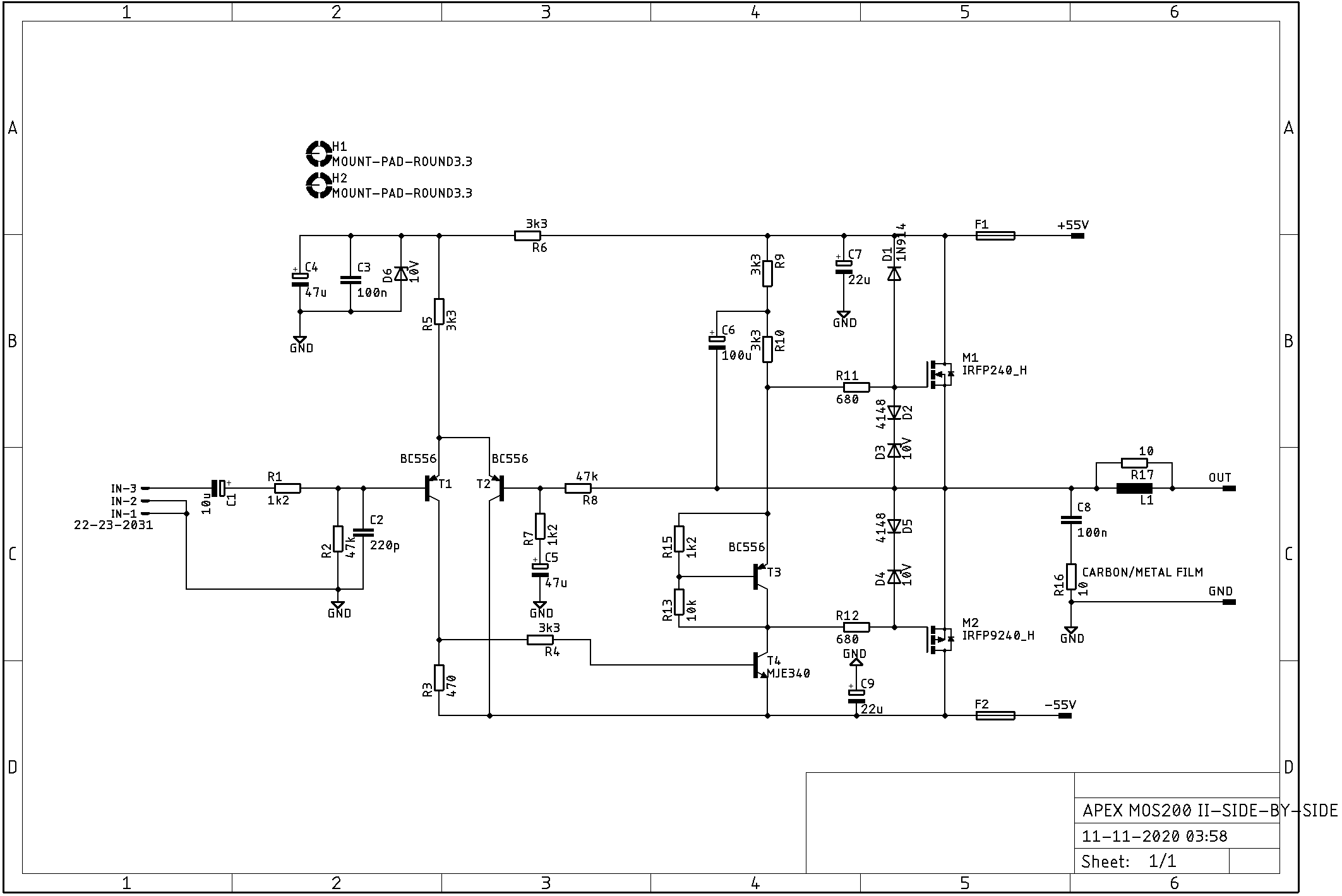

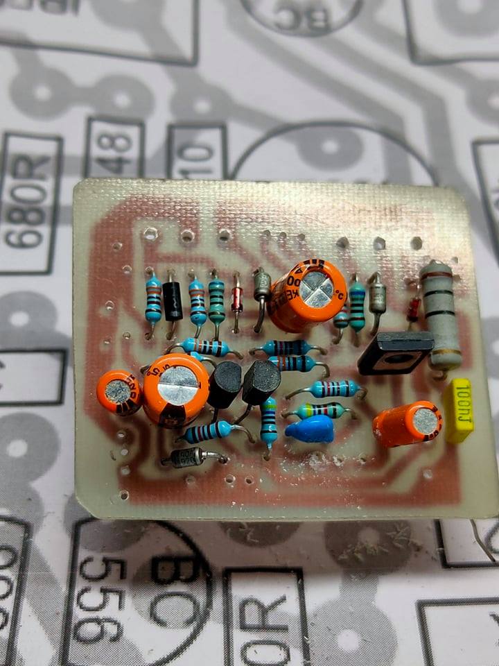

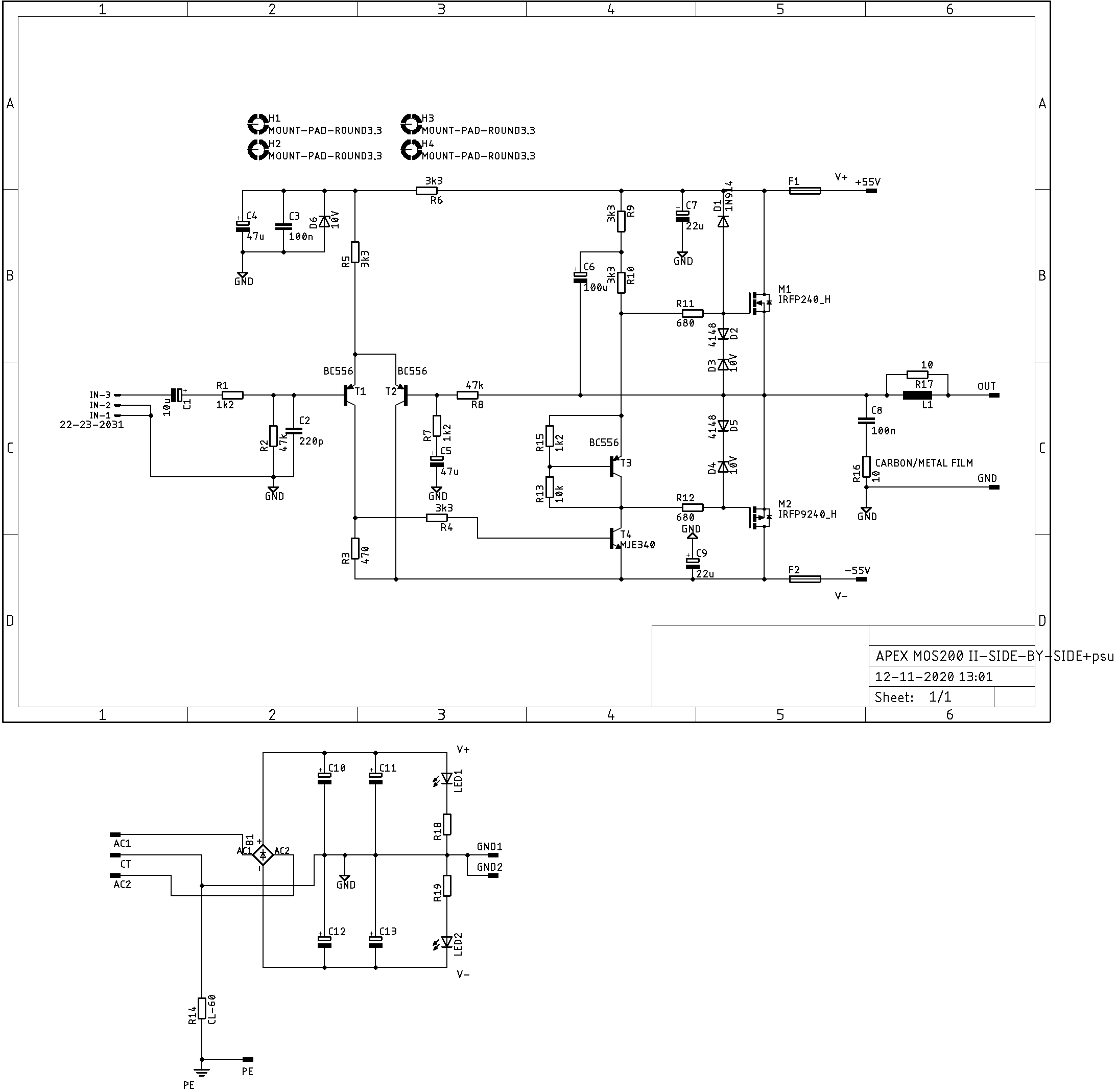

Hello Mile
greetings does this amplifier need zoebel output inductor
warm regards
Andrew

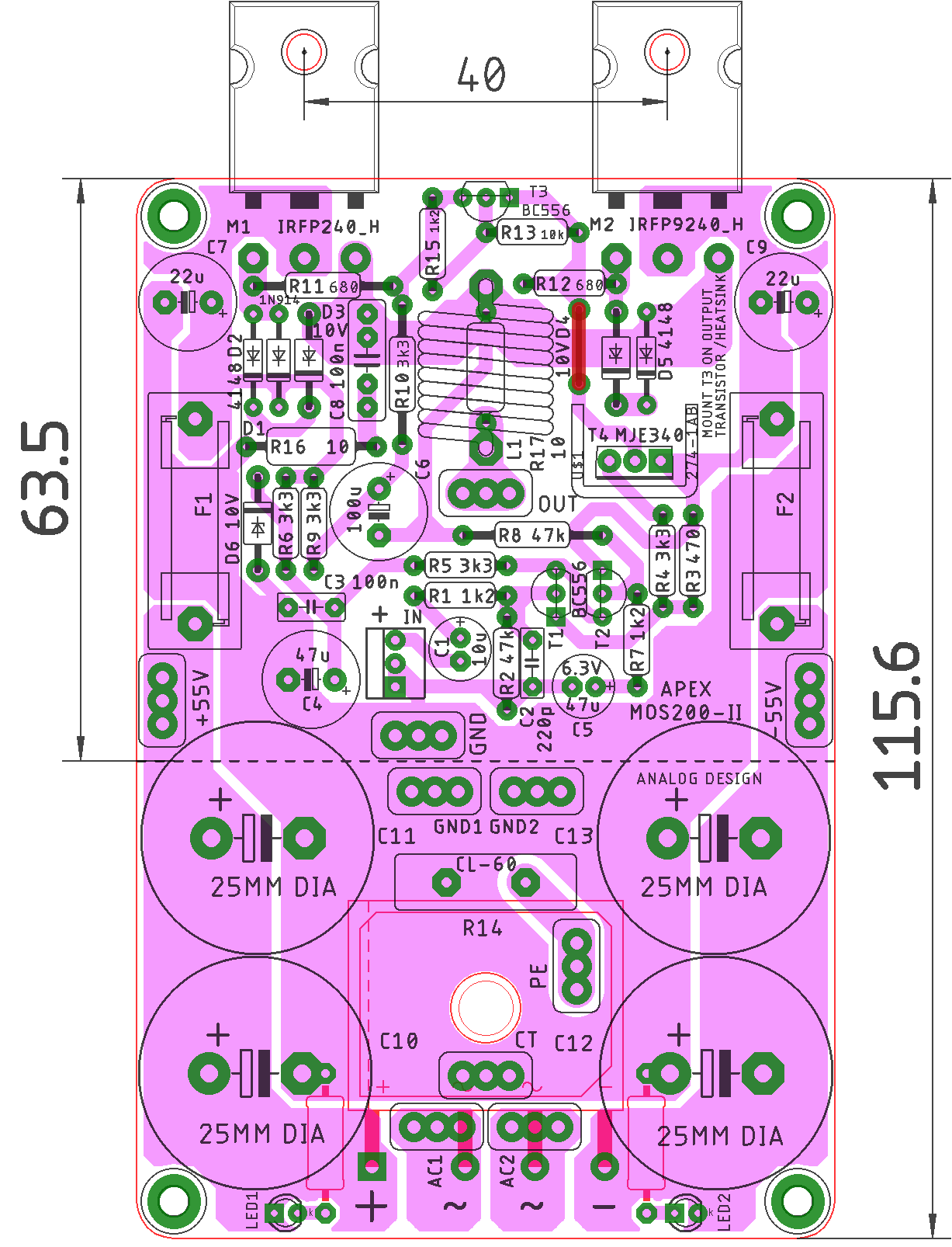

No need inductor, but there is mistakes on your board...

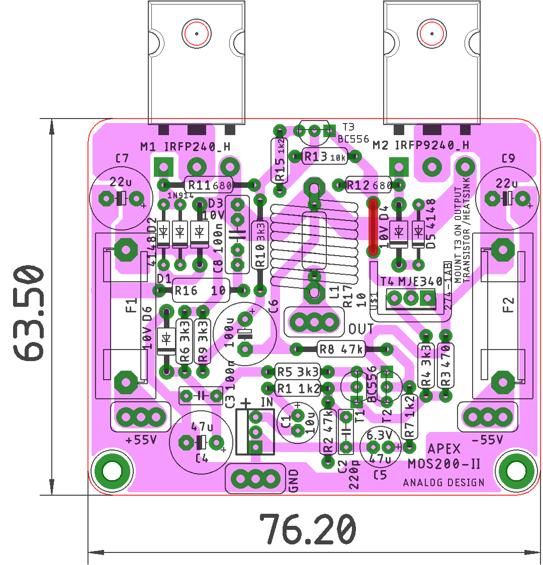

thats quick Andrew, . meanwhile i made another version. but the one you already made is best.
just remember to use metal film / carbon film for the zobel Resistor, as wirewounds can cause oscillation . just something i learnt recently on Mooly's mosfet amp thread.
regards
prasi

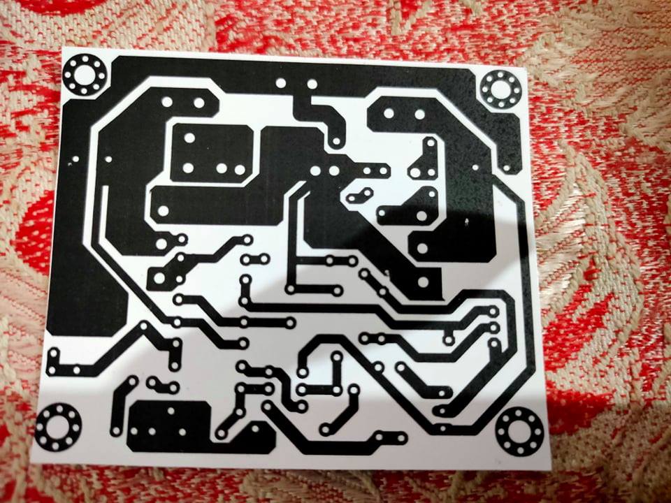

Hi Jacques,
Here are the pdf and gerbers. These are diy designs kindly provided by APEX, so no issues in posting.
regards
prasi
Hi Jacques,
regards
prasi

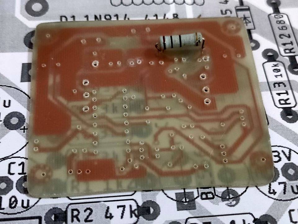

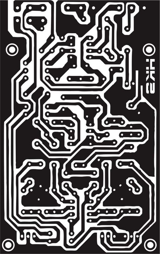

Thanks Prasi.
I just completed the 'doctoring' of your purple image with Photoshop to generate a laser-printable BW image !
Jacques

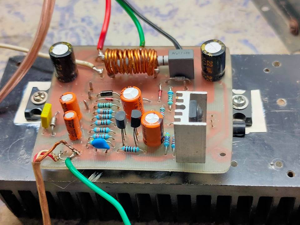

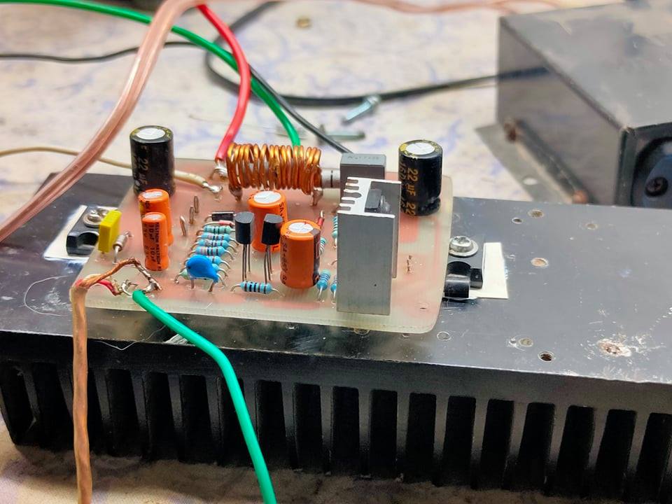

Hello
greetings and many thanks to Mile and Prasi amplifier came on first
time very detailed musical sound .
warm regards
Andrew
Hello
warm regards
Andrew
i am using +/- 30 v0lts DC
Hi Andrew,
Congratulations for your build!
Did you change any resistor value from the schematics for running at 30V instead of 55V ?
Jacques
