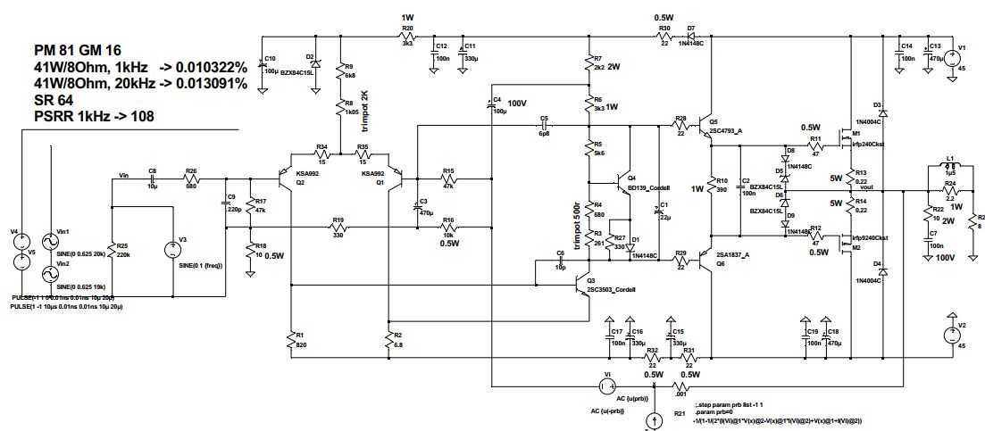

Terry this pcb must be more robust especially into the mosfet area, use bigger (fat) traces.I was checking my layout to the schematic and I was missing the connection between V+ and the 1k2 and 4007. I have added it here. These should be correct. now. Sorry for any inconvenience.
Bimo, because i know nothing about simulation can you inform me what are the alternative parts?My modification.

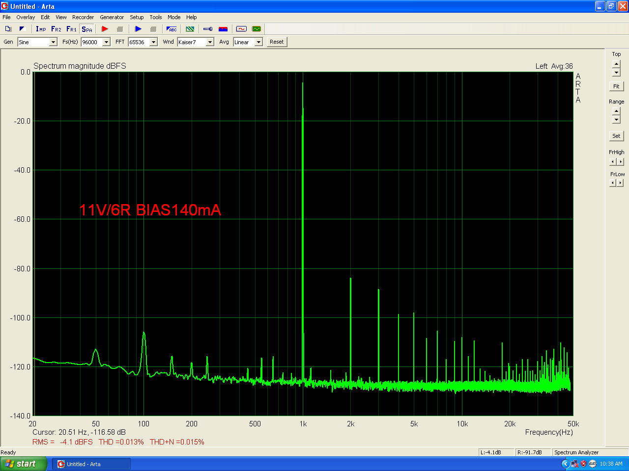

This amplifier have high THD for my taste, but have good harmonic profile. Slew rate is high enough.

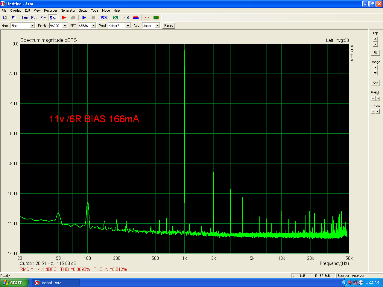

My modification using bias servo, so it safe to set bias current high, but I recommended bias current is 150mA for compromise good THD and efficiency.

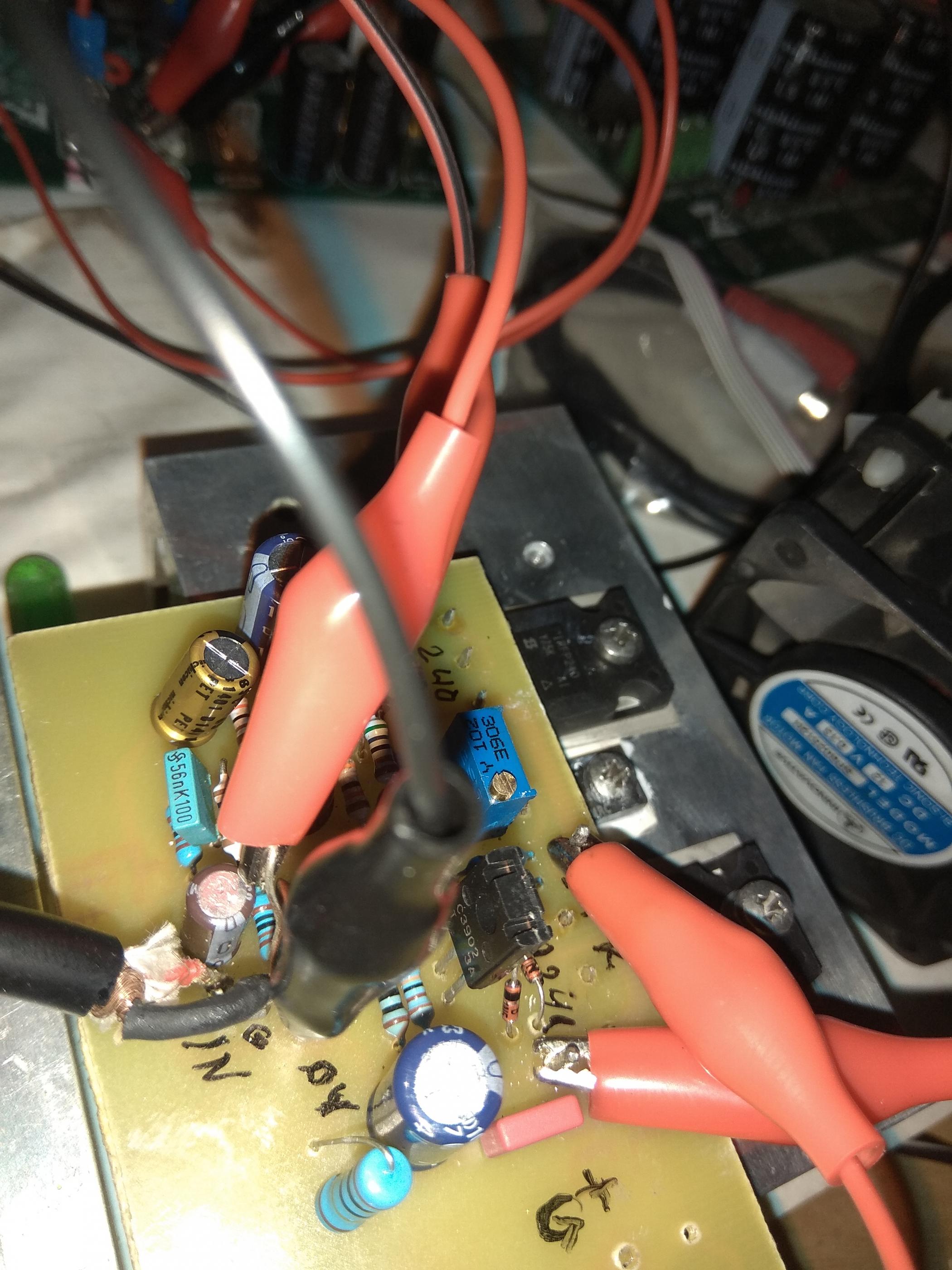

Hi Thimios,
I did enlarge the power and output traces. I didn't think the gate needed more. I will try to populate tomorrow and give mine a go. I plan to use an ammeter on V+ to set the bias. Wish me luck.

My modification.
This is really not the same amplifier. Many more parts.
Please can you post the schematic?In any case as it, i don't think that is a high THD that is audible and the gole is to keep amplifier's character.
high bias test
Power Supply=+/-50v
offset about 7mV
Idle current about 280mA OR More... be carefull,not safe!
Input current=3mA
VAS current=4mA
VAS transistor=2sc3902.

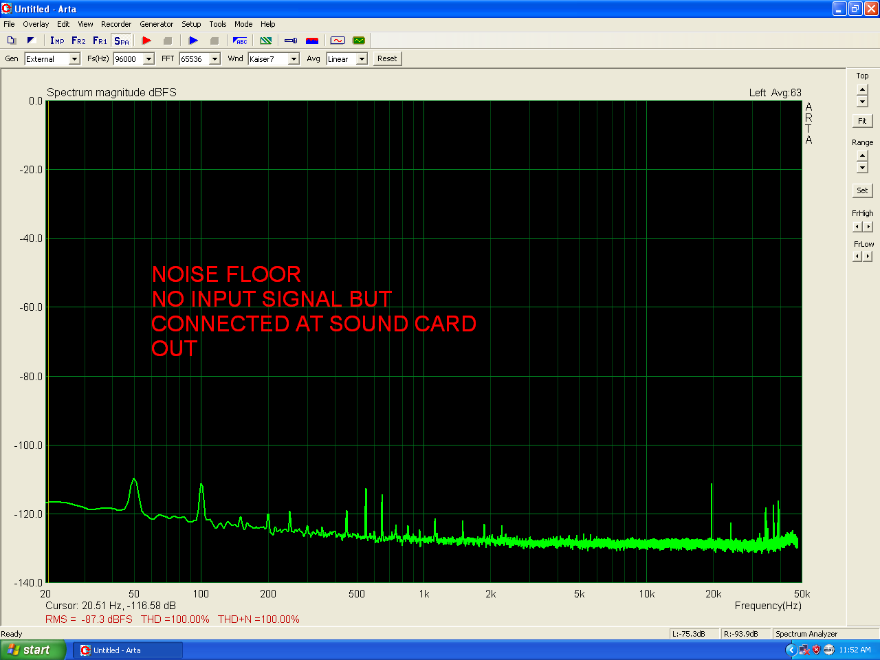

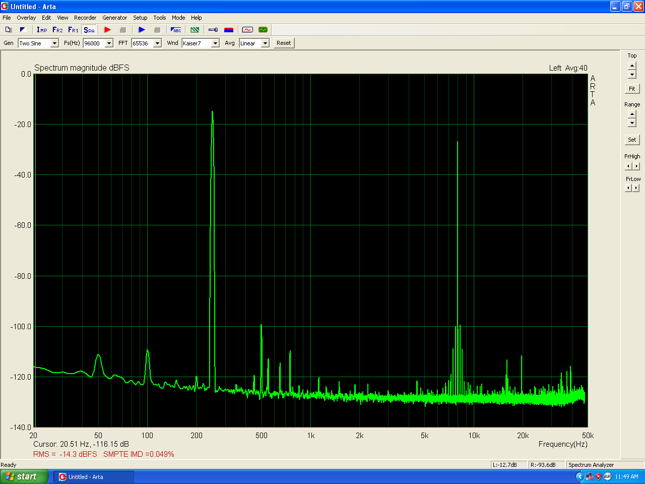

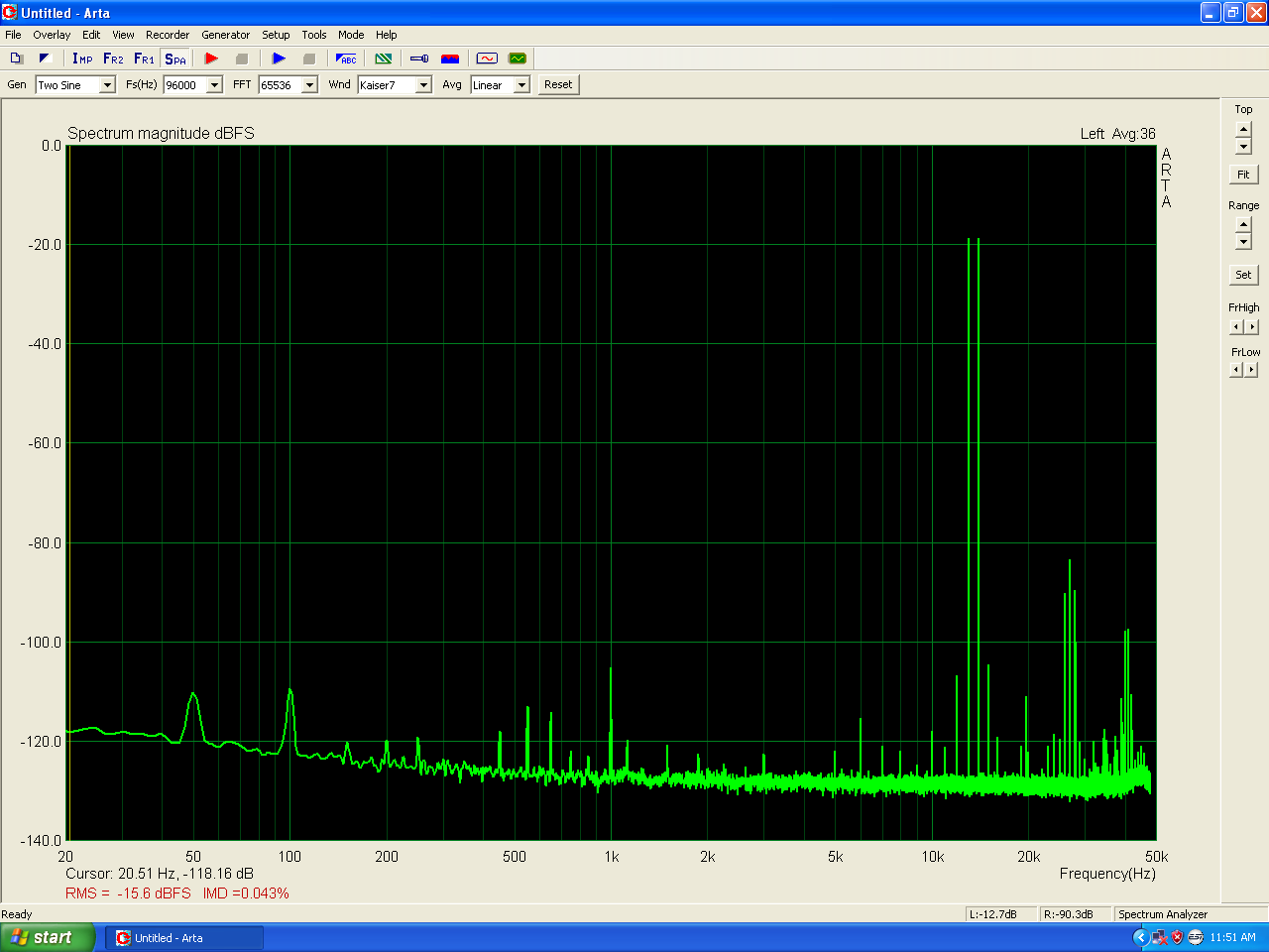

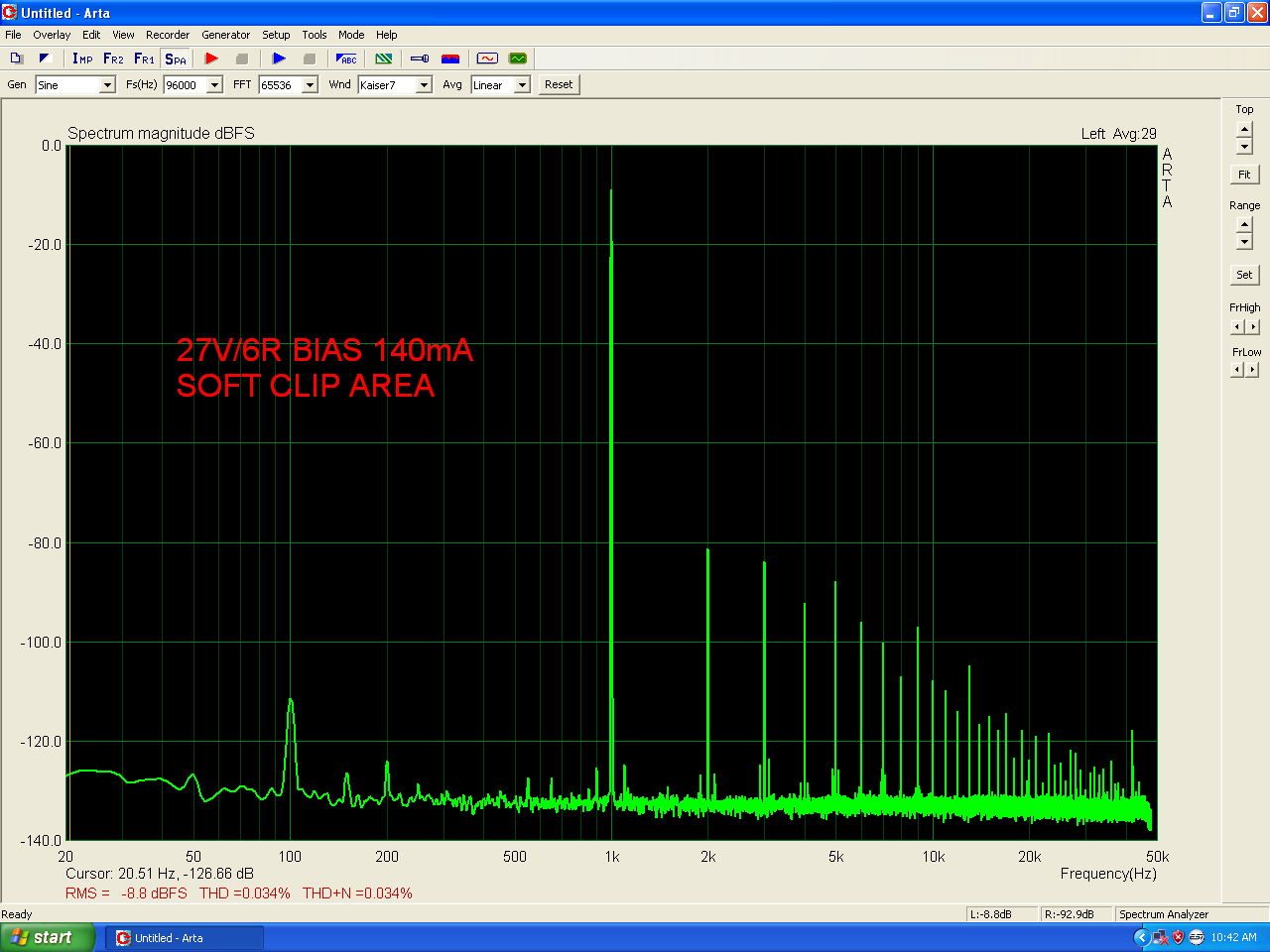

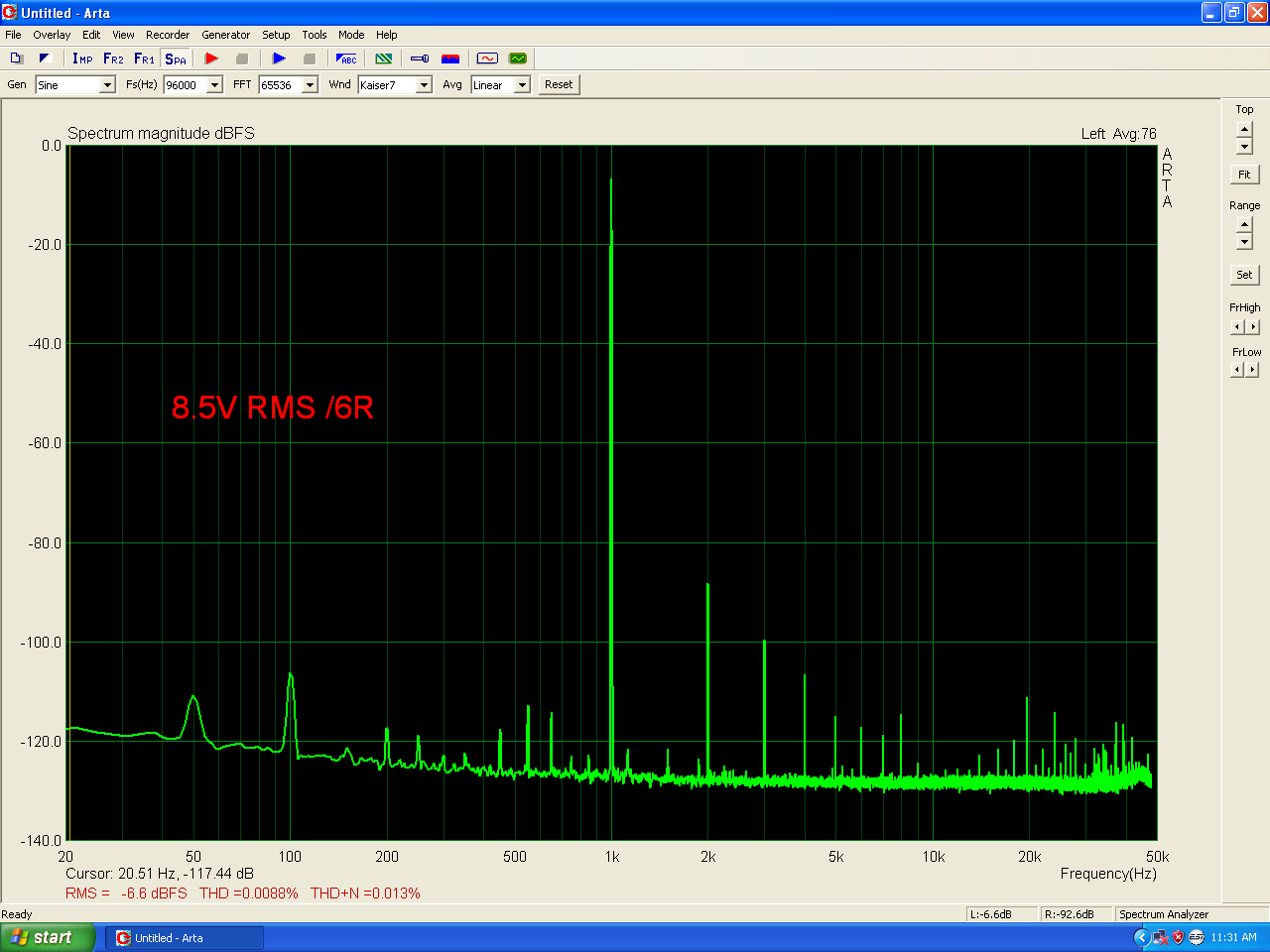

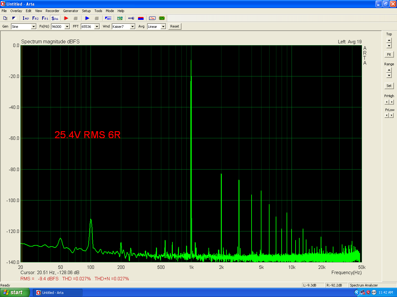

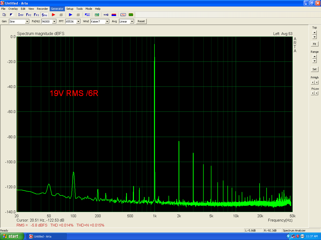

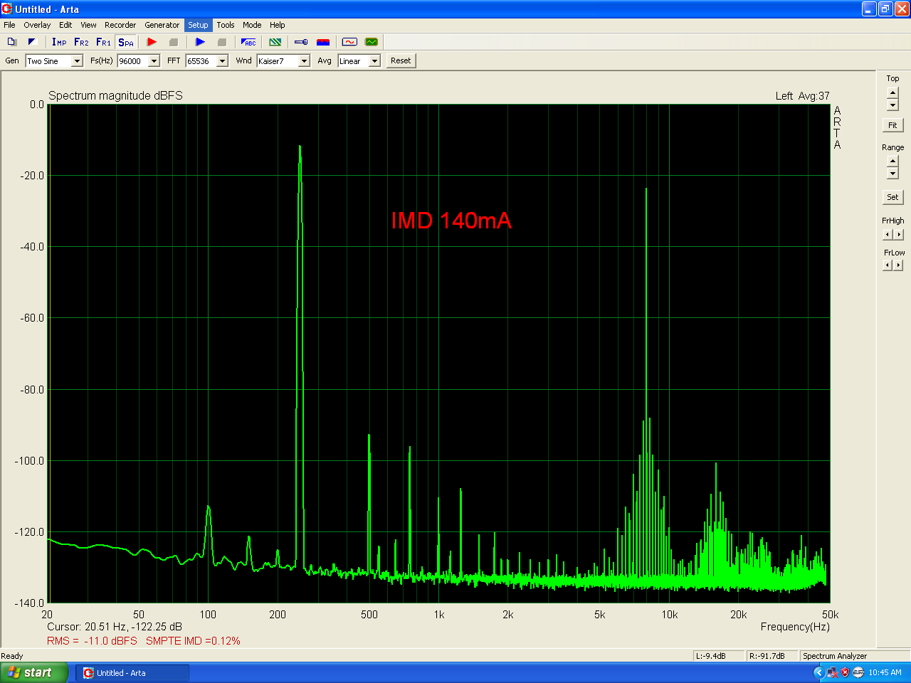

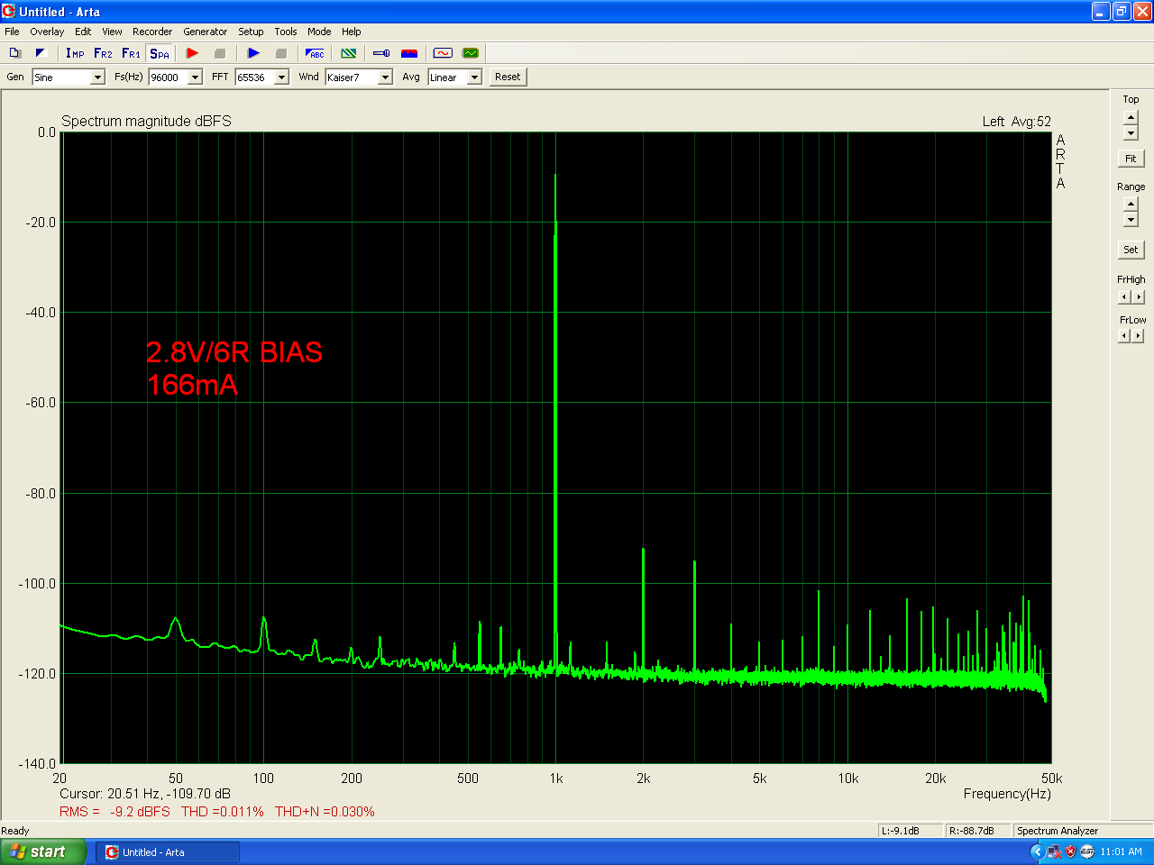

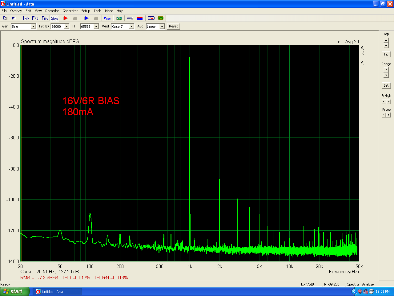

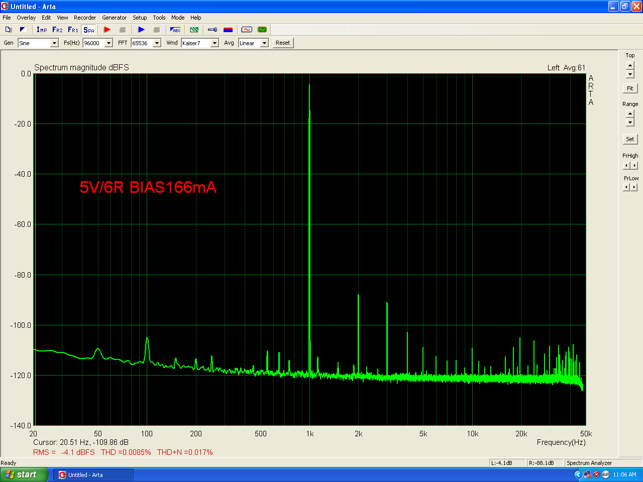

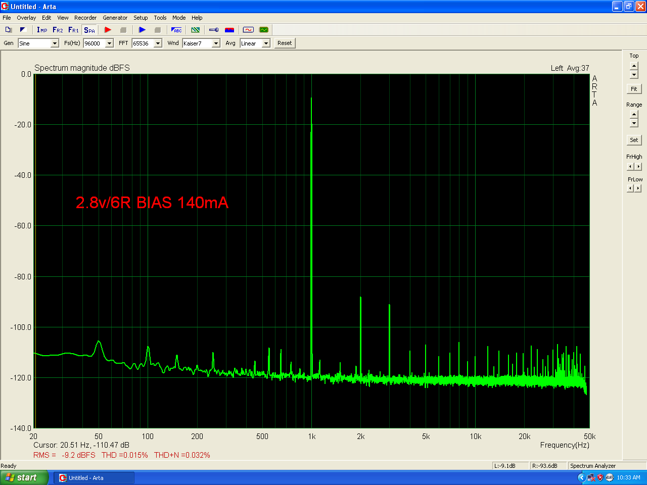

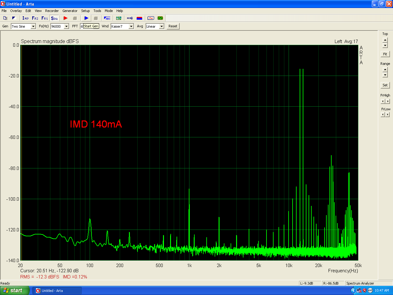

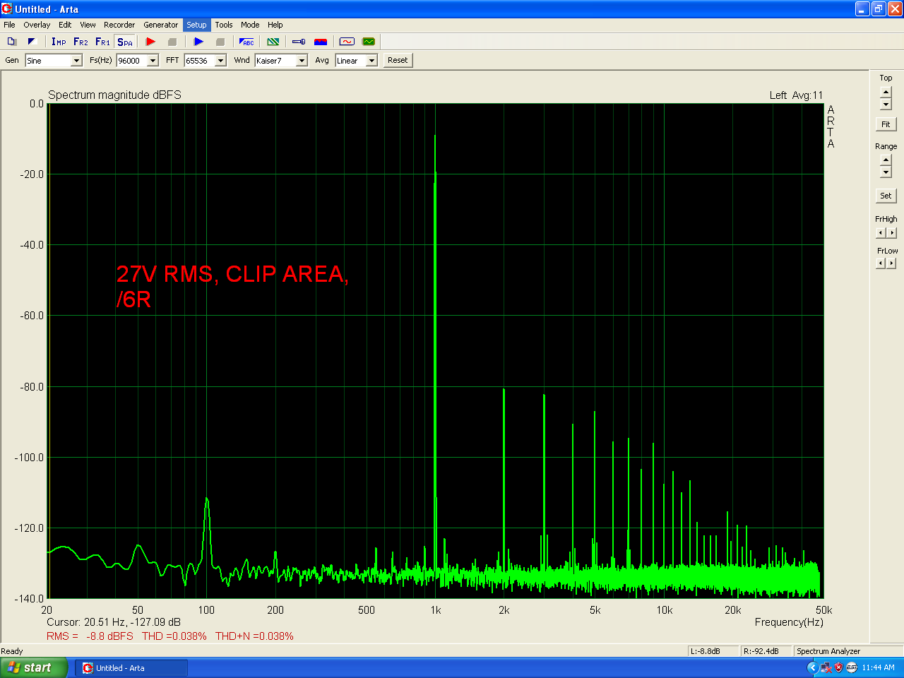

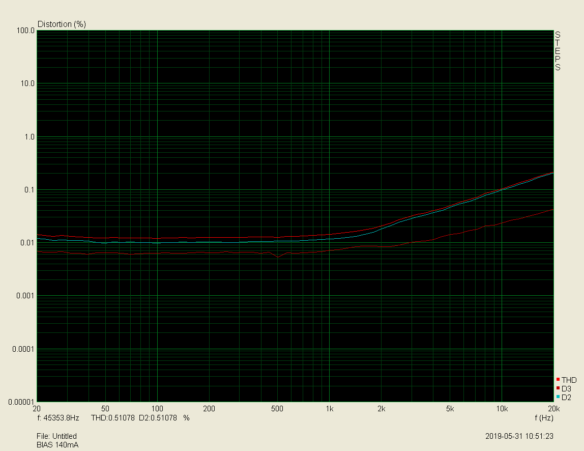

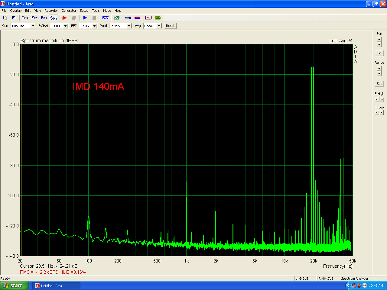

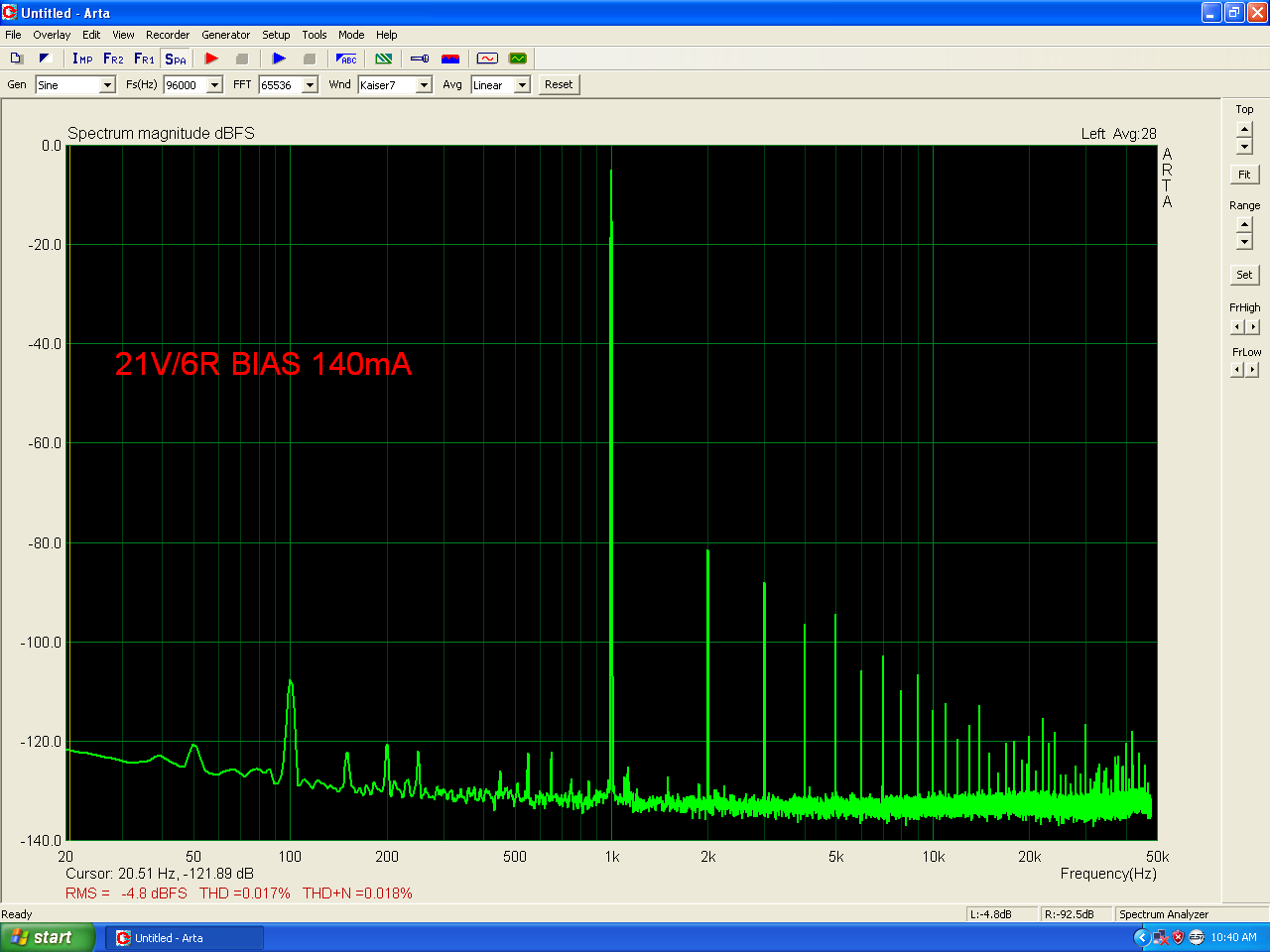

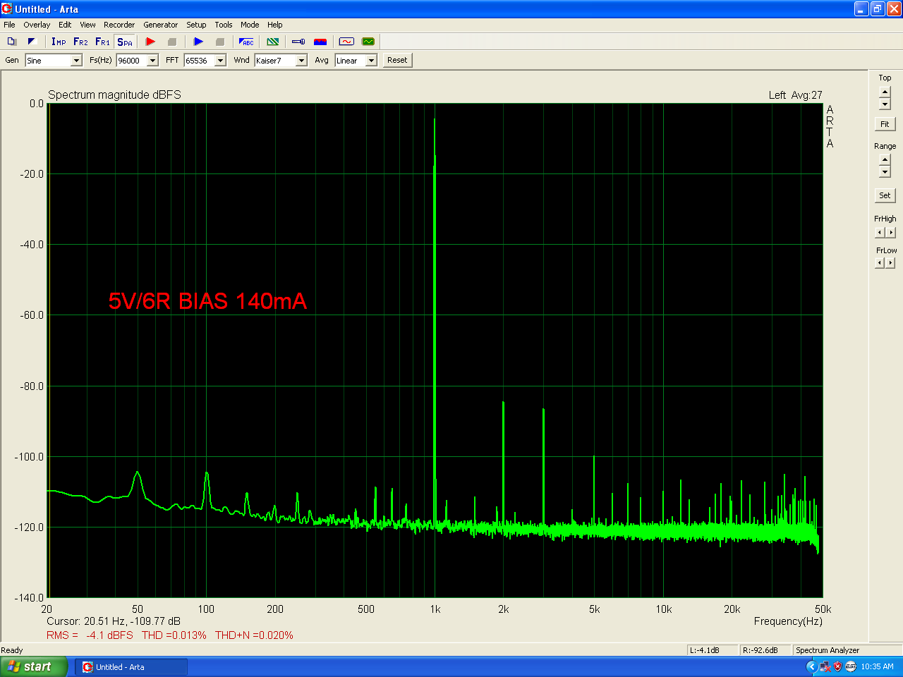

bias 140mA
BIAS=140mA.
BIAS=140mA.

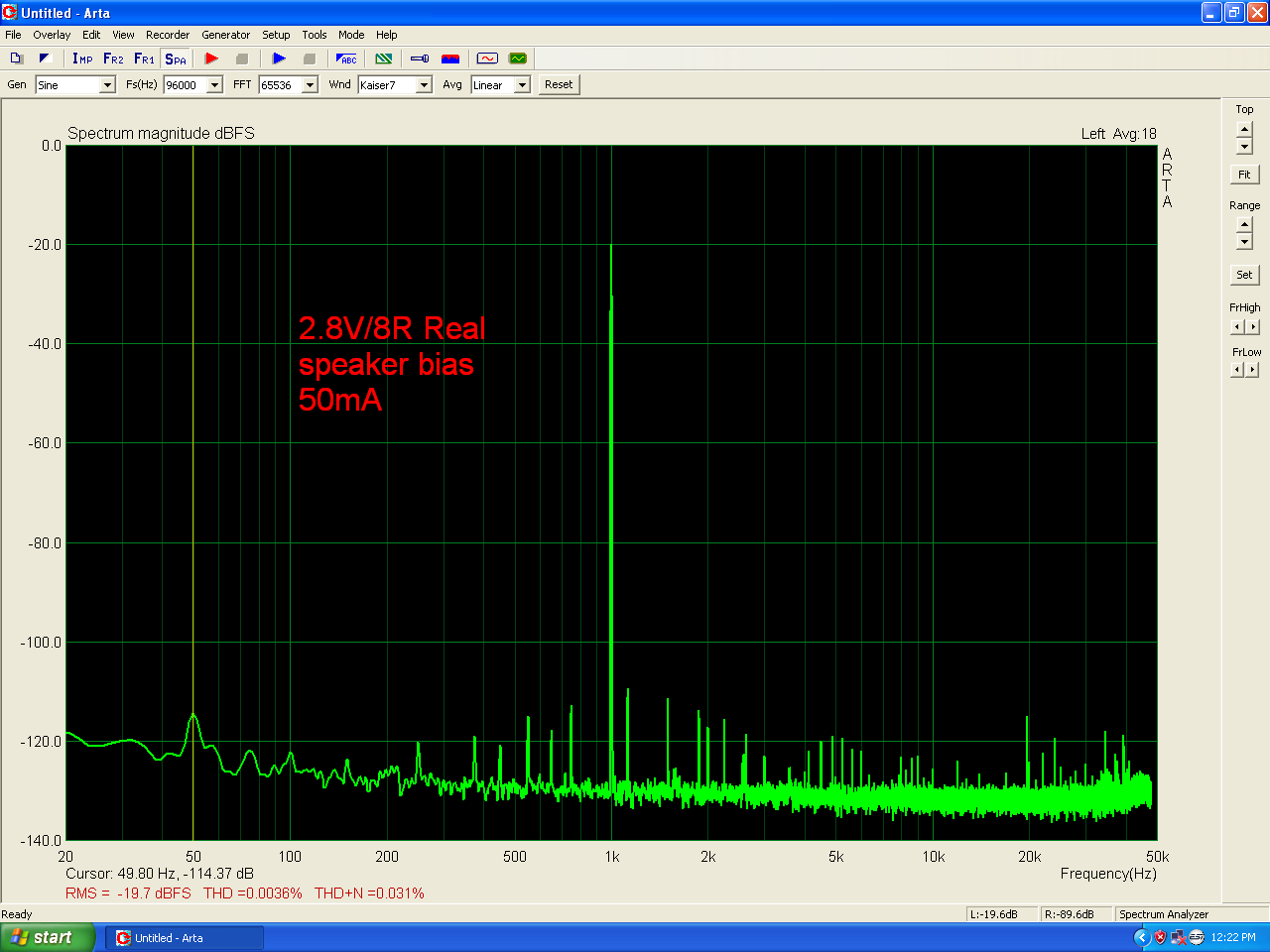

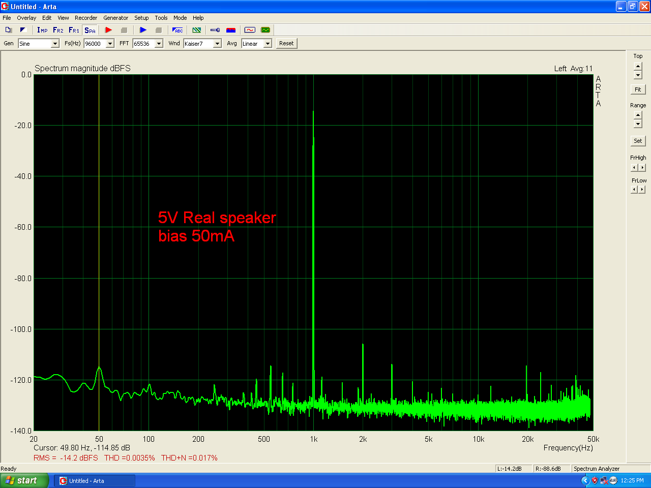

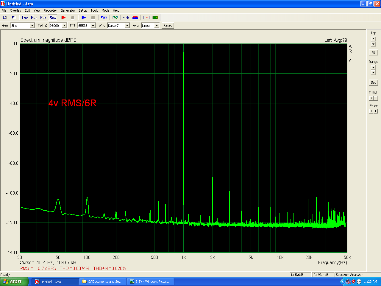

Testing this on a real 3way speaker
In this test a real 3 way speaker used as load.
Bias=50mA
I must run this last test again because another, different divider, was used.
I hope that all these will be useful....

anyone want to try the CFA version? non ltp input stage?
Can you give a brief explanation of what it is?

Bias=50mA.
I have try 5mA VAS current just now(4k7+4K7)but THD increased.
I will post the results latter.
Bias=50mA.
