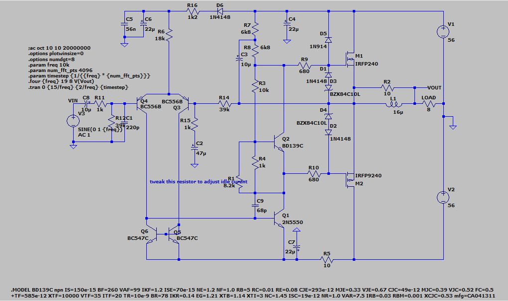

i see that you are getting the hang of pcb layout, have you tried ltspice, it can give insight into the behavior of these designs and sometimes identify problems. Even just figuring out bias V/I and static power helps in design. ltspice, schematic, layout all part of analog design these days and all for free except the parts.
Is that the design as in post #1195, shown as a ltspice .asc file?

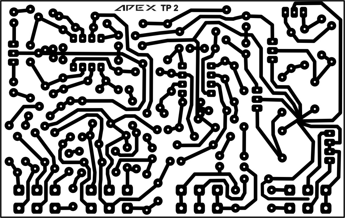

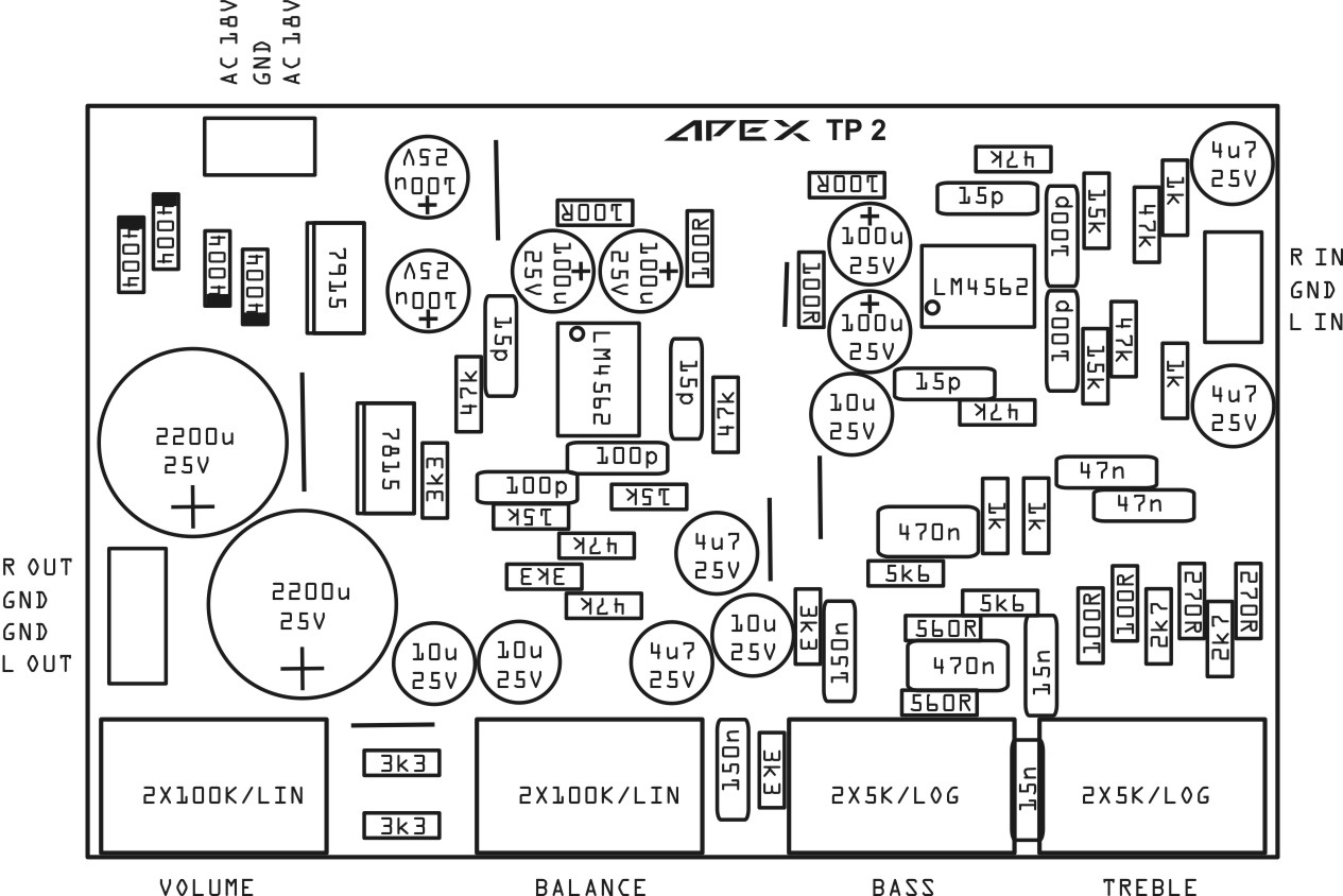

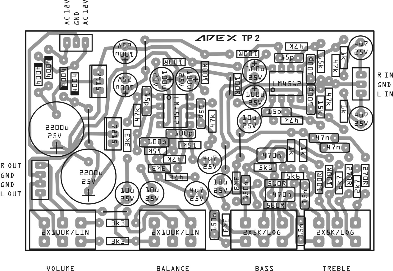

My Main problem is offset. I can't seem to get the offset to settle at a low value. Mains voltage changes it greatly. I have KSC3502 in now for the VAS. I haven't hooked up a speaker yet because of the offset. I know 70mV isn't a lot but I just think it should be able to go lower.
70 mV is acceptable.
Hook up a test speaker.
Try a different 556b pair,may be get better offset

I think I have oscillation problems. I had both channels running with <30mV offset with input shorted. All looked OK so I hooked up some speakers and music to the input. As soon as I switched on the power the outputs shorted and blew the output resistors of my FX100 PSU. Unfortunately, My test equipment is not functioning correctly so I can't easily troubleshoot it. I'm going to sack this. Maybe I'll try again later when I get my equipment sorted.
Terry, just two things.
Solder the separate signal gnd to power supply 0v, very critical.
If this isn't well contact the 50v rail is present on the output and a speaker short the output.
Second, what is the bias?
Higher than 100mV is danger.
Use your simulation program to find the max bias that is safe.
Mile, can you answer what is the max safe bias setting?
THD strongly depend from bias setting.
I will post results soon.
Ltp current is critical and must be about 3mA (Rail voltage 56V/(18k+1.2k)=2.9mA). If you use 35V replace 18k with 10k for different rail voltage you must calculate 18k resistor becouse there is no CCS. VAS current must be about 5mA, also there is no CCS (Rail voltage 56V/(6,8k+6,8k)=4,1mA) for different rail voltage you must calculate resistors value instead 6,8k. If ltp current is to low VAS transistor stop conducting and there is rail voltage on amp output. I have no stability problem evan with capacitive load (piezo driver).

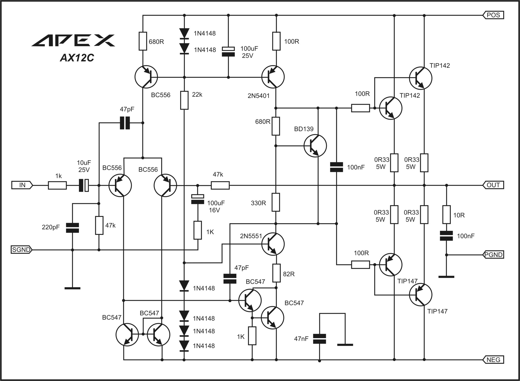

I'm sure others are also thinking this needs a bit of adjustment. Adding a current mirror gets rid of any sensitivity to supply voltage, ie no parts changes required, de-thumps the on-off, and improves THD by about 5x. This does require adding a compensation cap on the VAS for stability and I used a 150V VAS transistor which makes little difference to simulation. I made the VBE resistors a little more realistic/easy and added a small -V filter for the front end.
  • MOS200-1.asc
    MOS200-1.asc

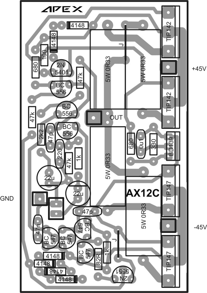

Nice, start to look like AX12C.
I have a +/-50v power supply.
I have 16k in ltp so 2.9mA ltp current
I have 5k6+5k6 in the VAS so current is 4.46mA.
I haven't check using oscilloscope but never smelled a hot zobel.

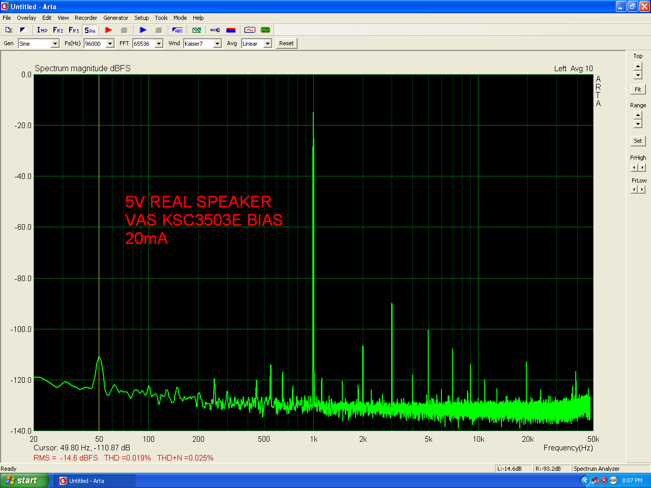

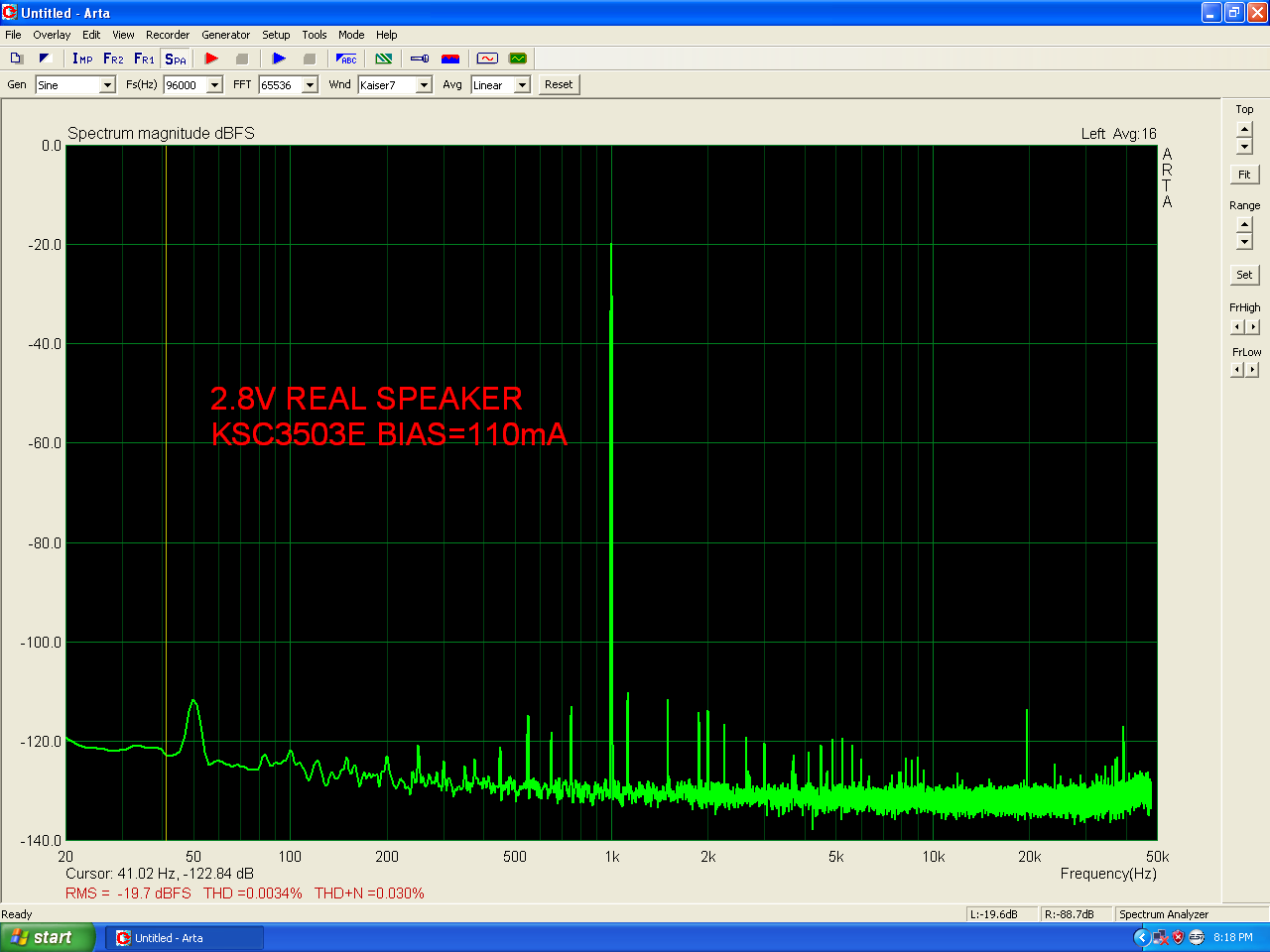

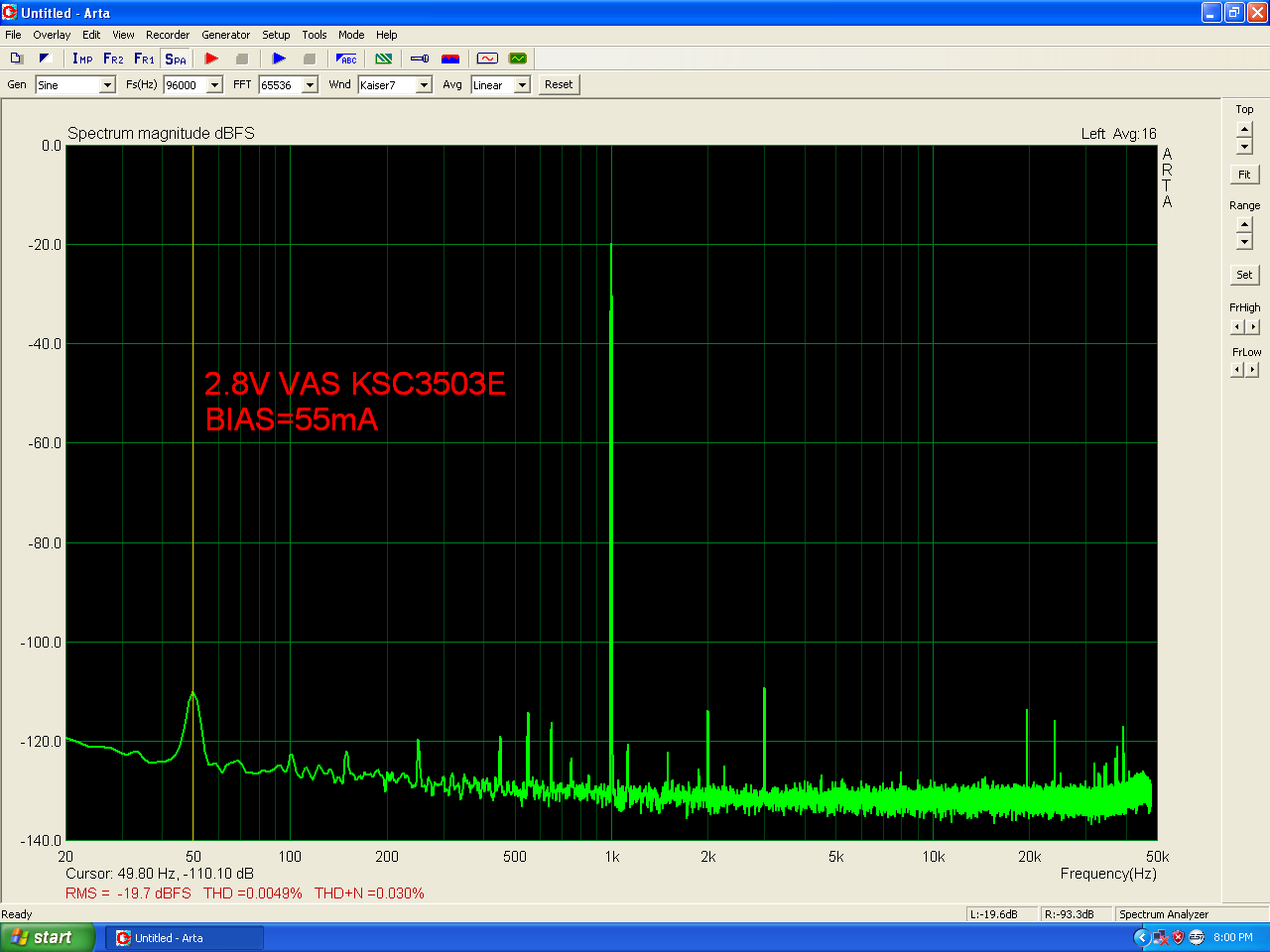

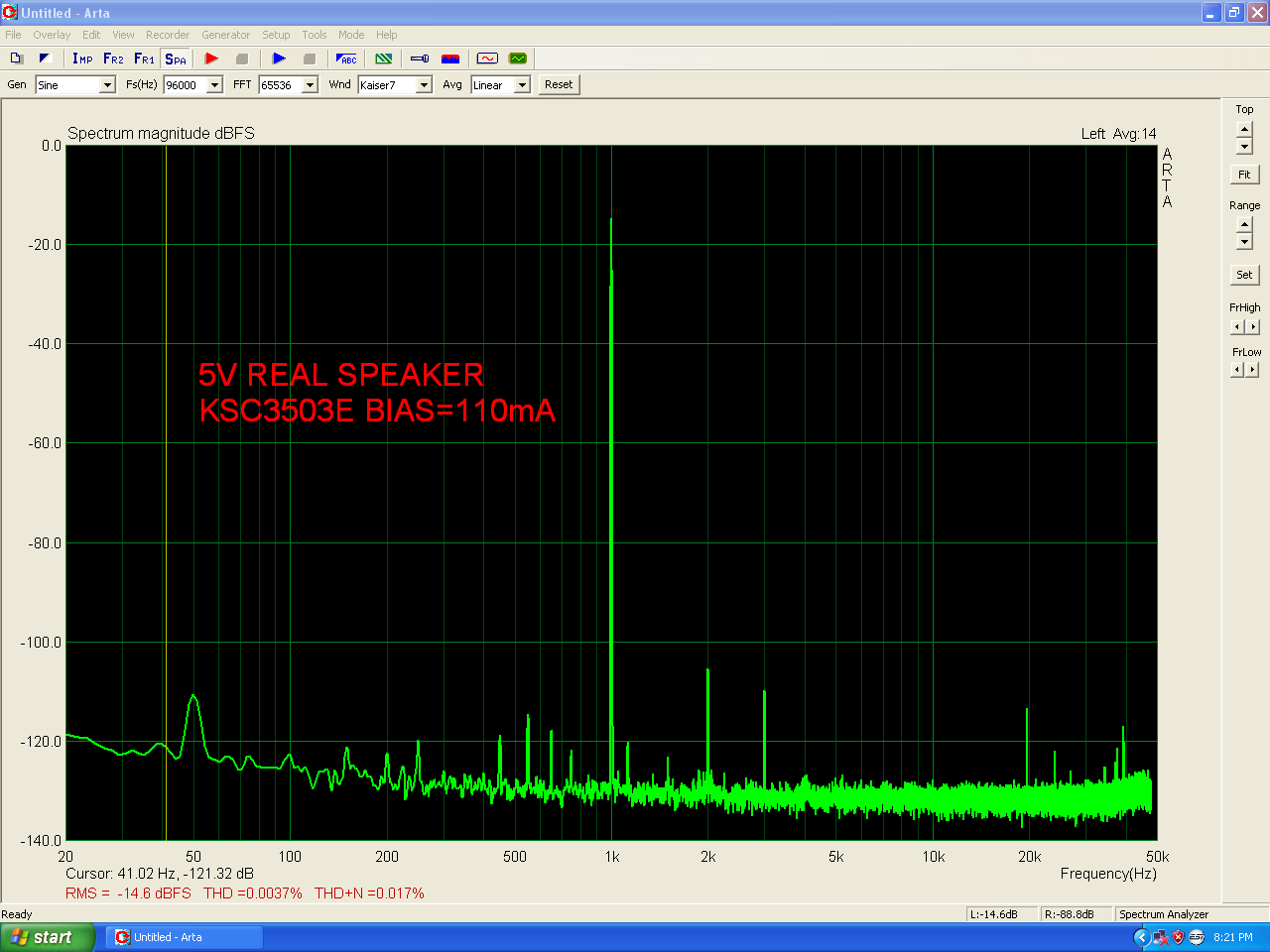

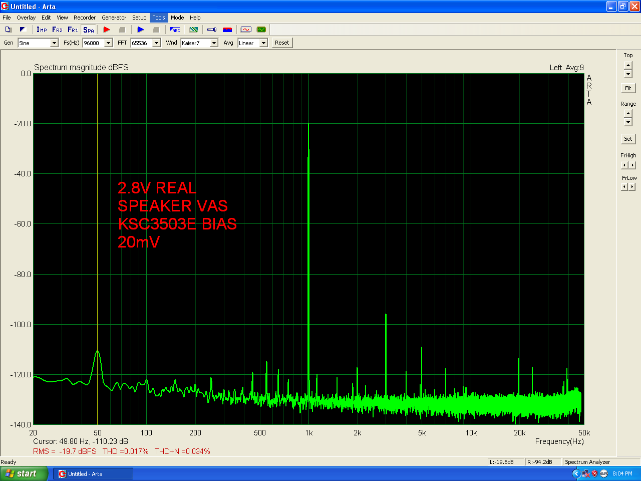

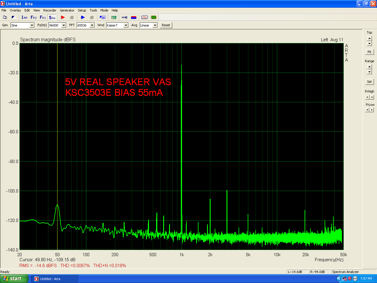

How the bias setting affect the THD.
I will ask again.
Using +/-50v power supply.
What is the max safe value for bias setting?
