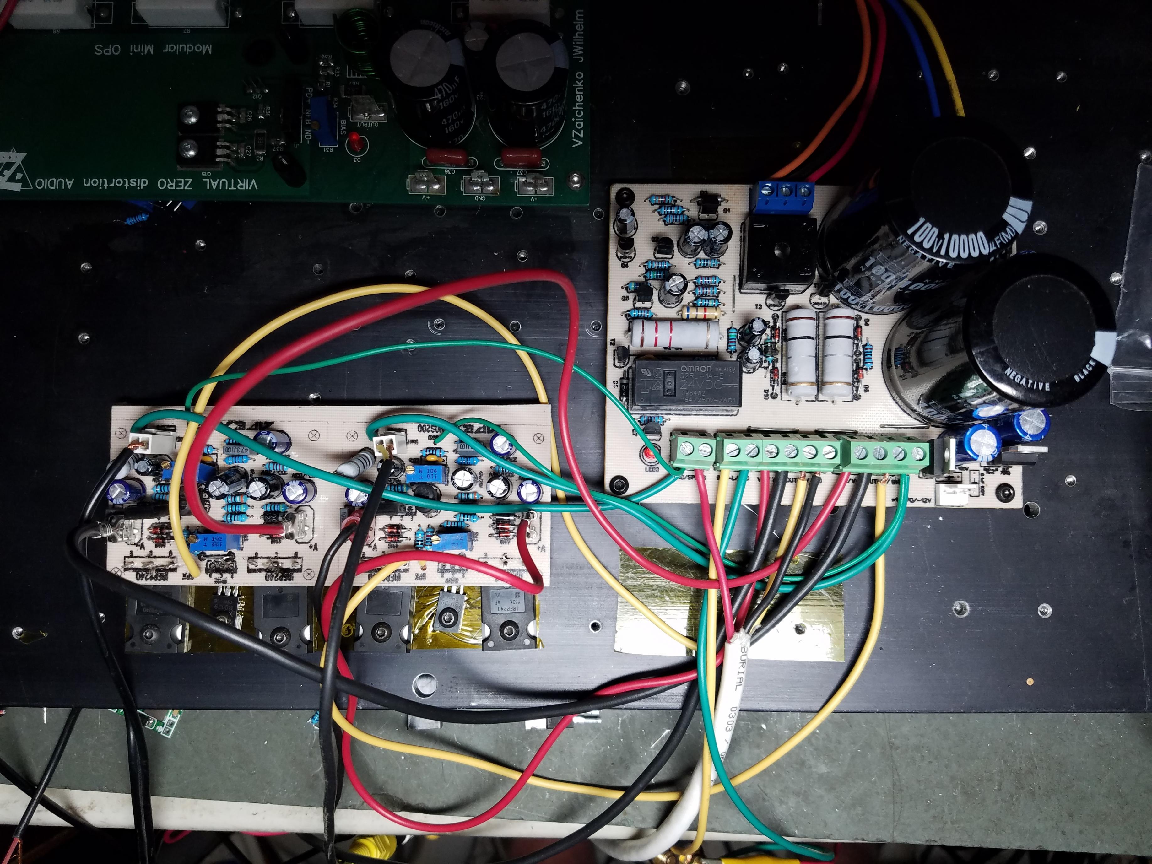

OK, I wasn't satisfied that I had everything right so I etched a new set of boards and started over with all new parts. This is what I have now. First of all, I can get it to adjust to 20mA bias and the 100k pot will adjust the offset to 0V. It will play music one channel at a time but it sounds a little distorted. It will not work with both channels hooked up to the PSU. As soon as I do that, the bias goes through the roof. Fortunately I have it hooked up via a light bulb so nothing burned up this time. The only thing I have done different that the schematic is that I used 47n rather that 56n, 4k7/4k7 rather than 6k8/6k8. I also used KSC3503 for the VAS and BD139 for the bias spreader.

I thought maybe it was the trimmer at the input. It was adjusted to about 28K to zero the offset so this morning I set it to 47k thinking that would work but no such luck. Each channel will play music alone but hooked up together they go into overload. There is something wrong but I just can't find it. I will put up a schematic with voltages today and maybe that will shed some light.

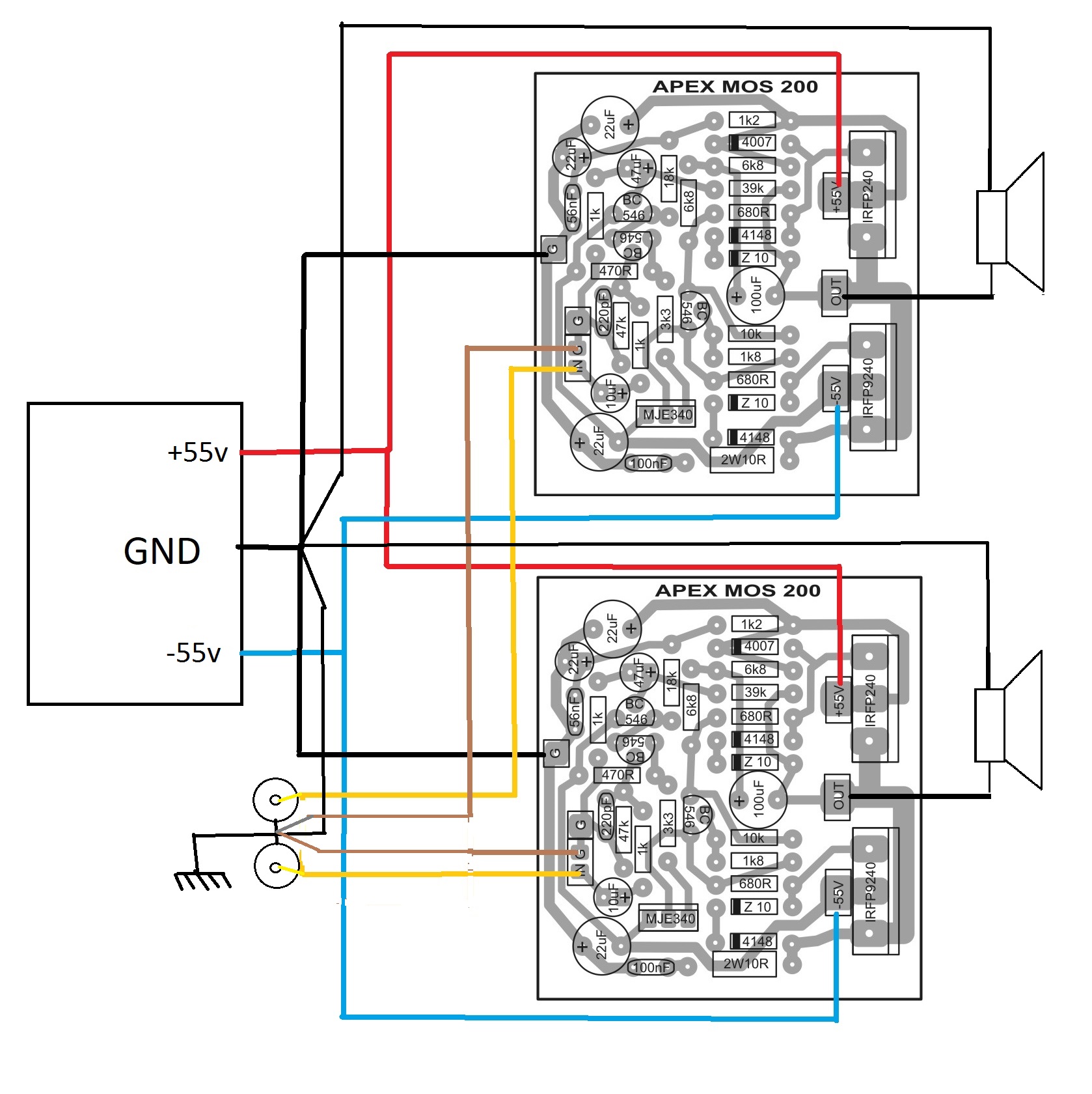

Yes, I have separate ground wires from power ground and signal ground. Here is a picture of how it is wired.
Connect gnd from R channel input rca socket to gnd L input rca socket.Yes, I have separate ground wires from power ground and signal ground. Here is a picture of how it is wired.
Use one cable to connect this common gnd to power supply 0v
Connect the rca sockets R&L using coaxial cables to the amplifiers boards as usual.
Do not use any other cable from signal gnd to power supply 0v.
Please look on the Apex schematic carefully!

Is that how you wired yours? I will try that but I don't think that should be necessary. This amp seems unstable to me even playing only one channel, it doesn't sound right.

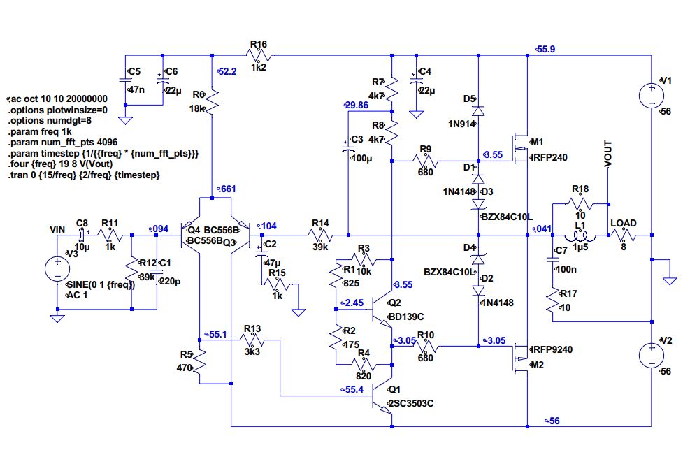

Here is a schematic with voltages.
My only criticism is no capacitor on VAS.
Q1 b-c should have 100pf across it.
