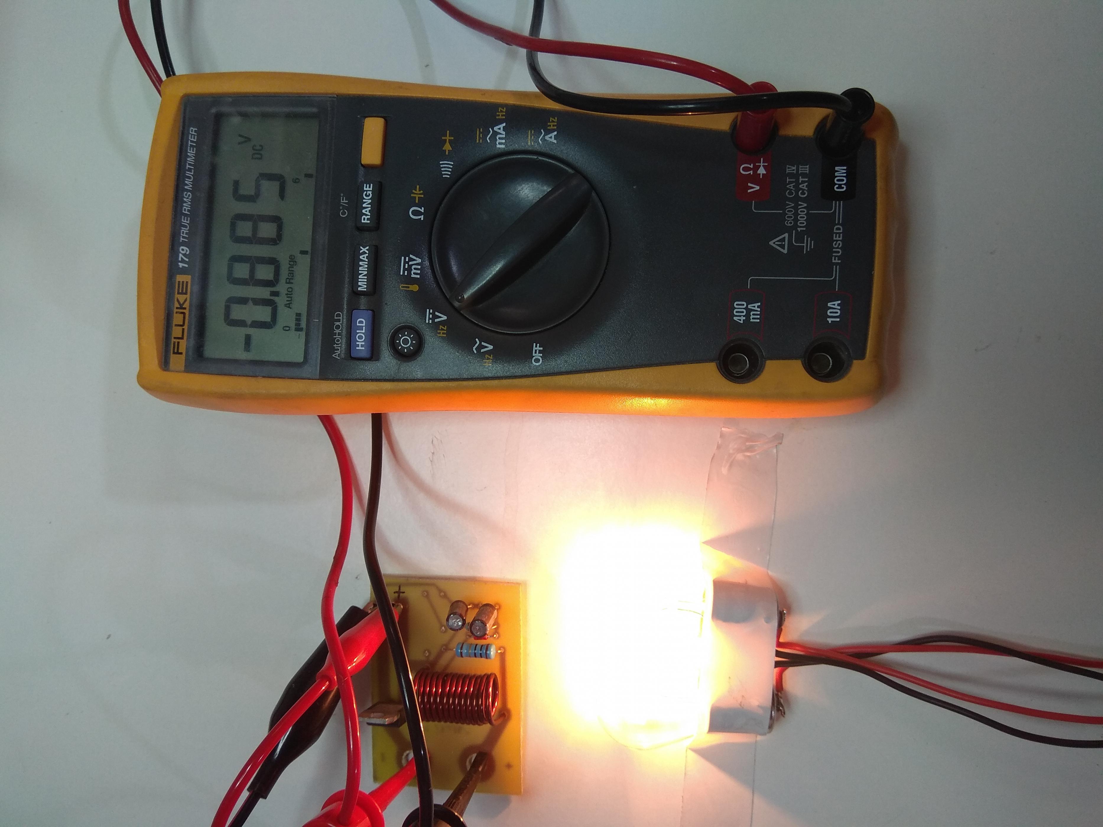

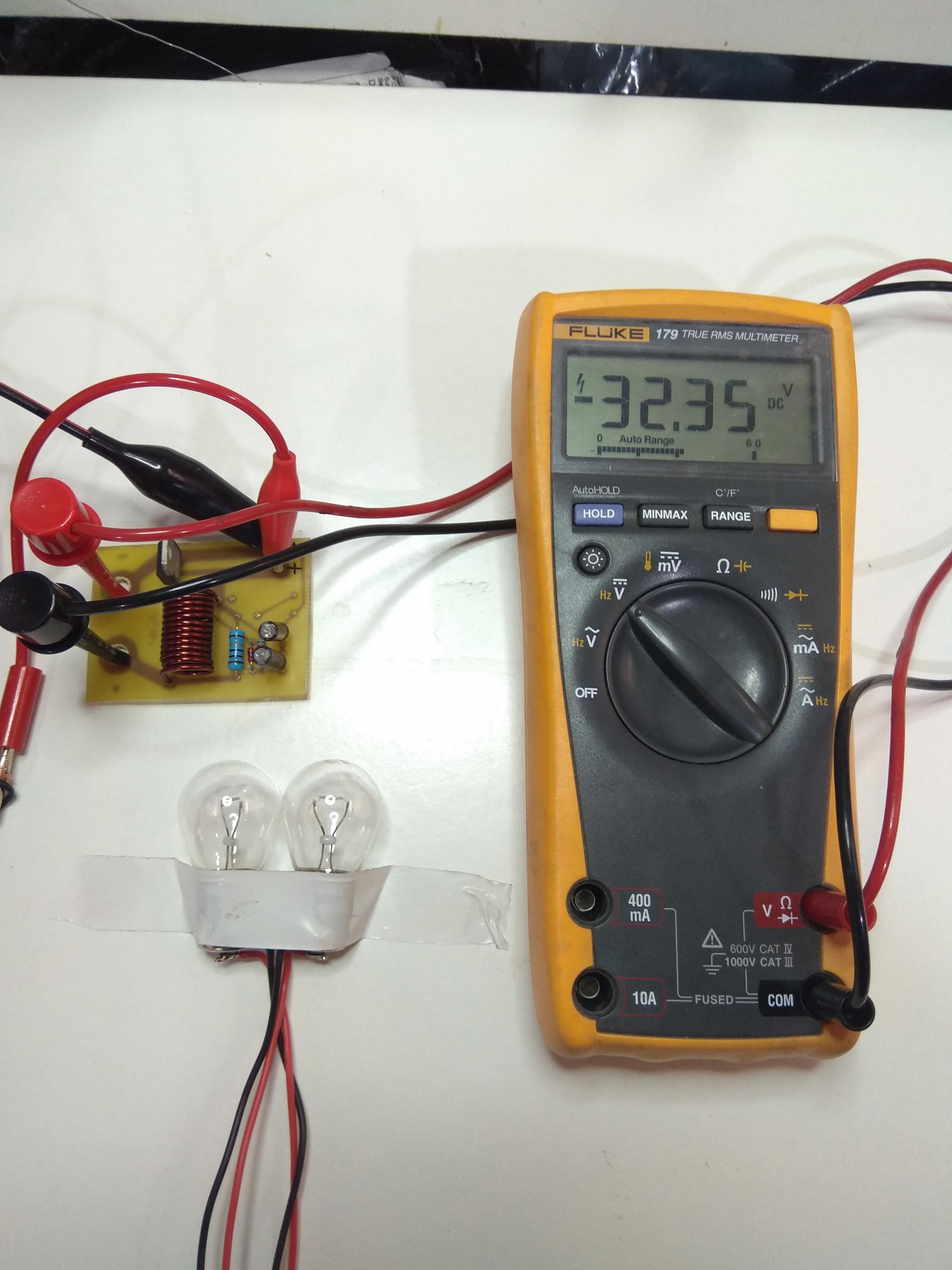

Testing Apex crowbar protection.
This will be used for cheap protection in mos 200.
You must add fuses in mos200 if you want use crowbar protection.
Yes i know, there are fuses already in the power supply.
Thimios, two back to back 100A fets will work better as they won't guarantee destruction of your amp. Valery's revisiting the 1970's 80's thread has the circuit as well as exceptional amplifiers. I am going to replace the protection relay in my amp with this.
