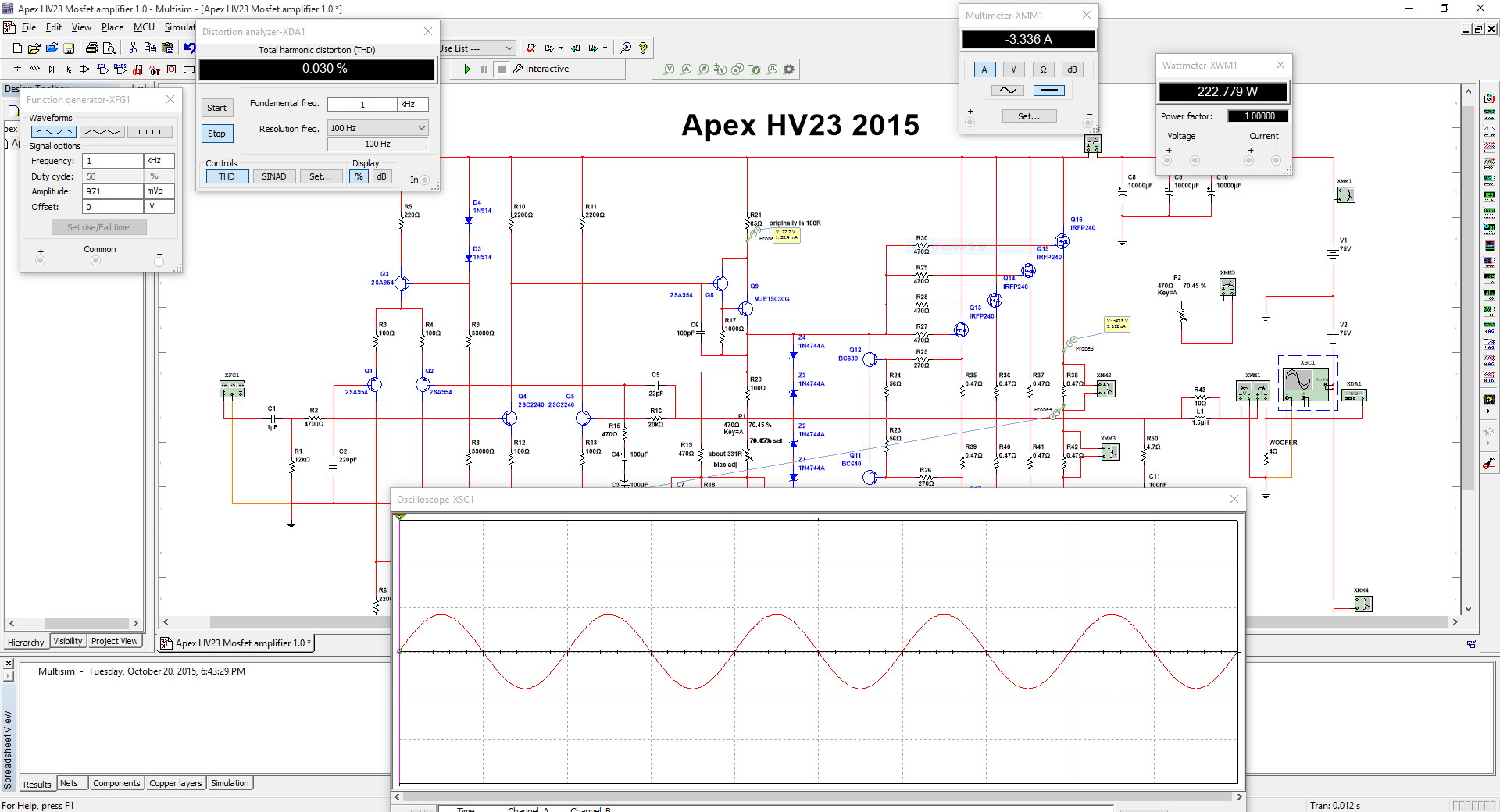

Hi Sir Mile,
on a thread i started, AndrewT helped me estimate va rating for an old transformer that was just gathering dust. they are:
Primary:220vac-240vac 2020VA
secondary:+/-35vac 1970VA
+/-18vac 148VA.
with these figures, i would like to make another HV23 amplifier. what changes can i make if any and if this amplifier is not a good choice, which circuit would you recommend?

No changes,
Regards
Hello Shelah
I think is not need it to add an extra pair, build it as it is as mister Mile post, just fallow his design, you will get more than enough power my man 🙂

the 35+35Vac secondary will give you ~ ±50Vdc
That allows a BJT output stage to give ~100W into 8ohms, or 200W into 4ohms.
With 1970VA available you could run ten 200W channels for domestic style (non PA) amplification. For PA duty you may have to reduce this to 5channels of 200W into 4ohms.
You could bridge these, or build balanced power amplifiers and get upto 5 channels of 400W into 8ohms.
Alternatively you could make some, or all, of your amp channels ClassA.
Using 6times to 10times as the VA required for each ClassA output watt, you could have 200W to 300W of total ClassA power amplification, i.e. two or three channels of 100W into 8ohms ClassA
The Krell KSA100 uses a 1kVA transformer for 100W into 8ohms in full ClassA and it transitions into ClassAB to do 200W into 4ohms or 400W into 2ohms. I power tested my Krell Klone at 411W into 2r0 test load.
