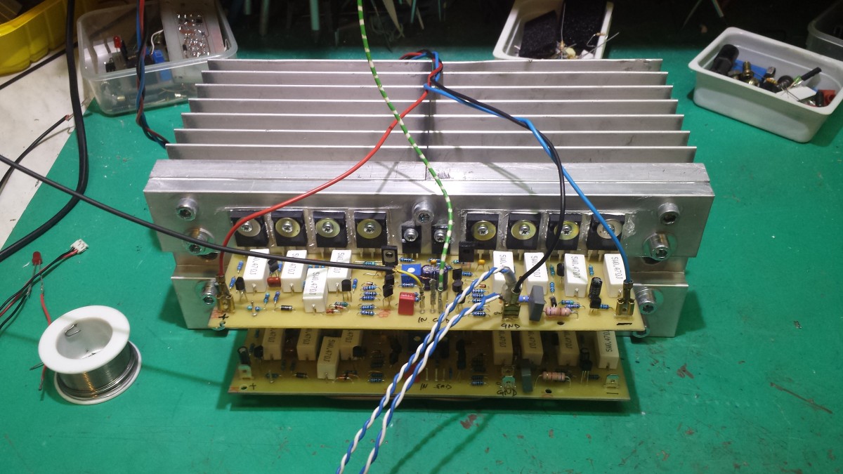

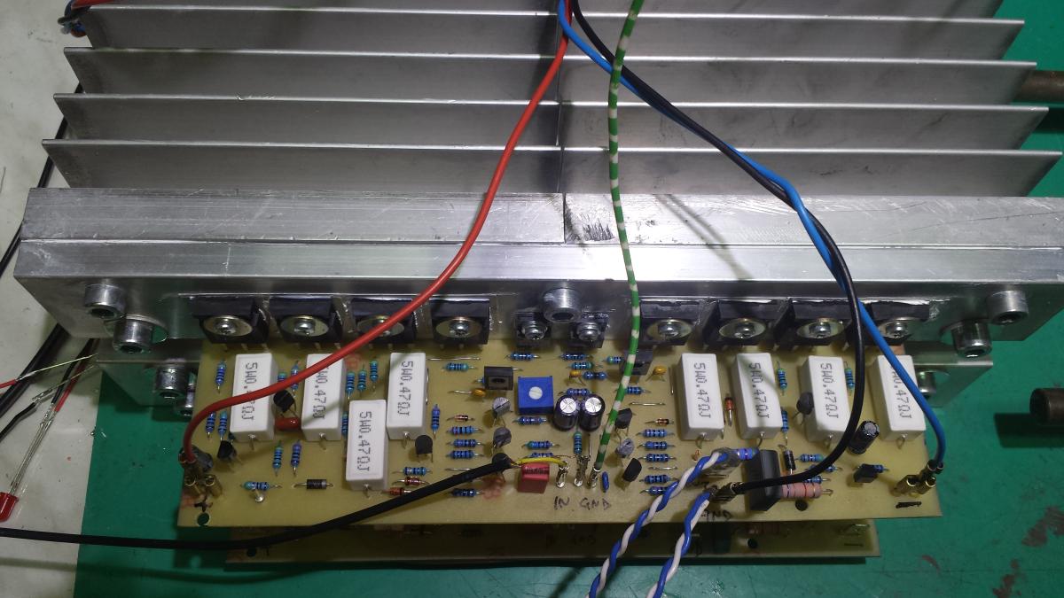

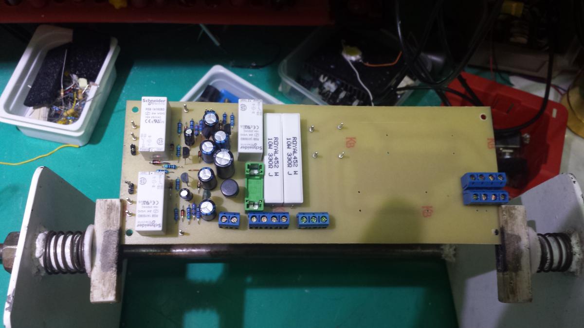

Hay, this is my HV23 amp in stereo. The amp is tested at +-30VDC only because i don t have any 100v capacitor yet. It play very good ,the bias is set at 20mA for transistor. Also made PSU-7 for amp, it work but with minor problem.If I connect LED for DC protection indication ,the relay don t disconnect speaker. Without LED everything is OK.
Any sugestion how to fix that?
Regards
zoky2

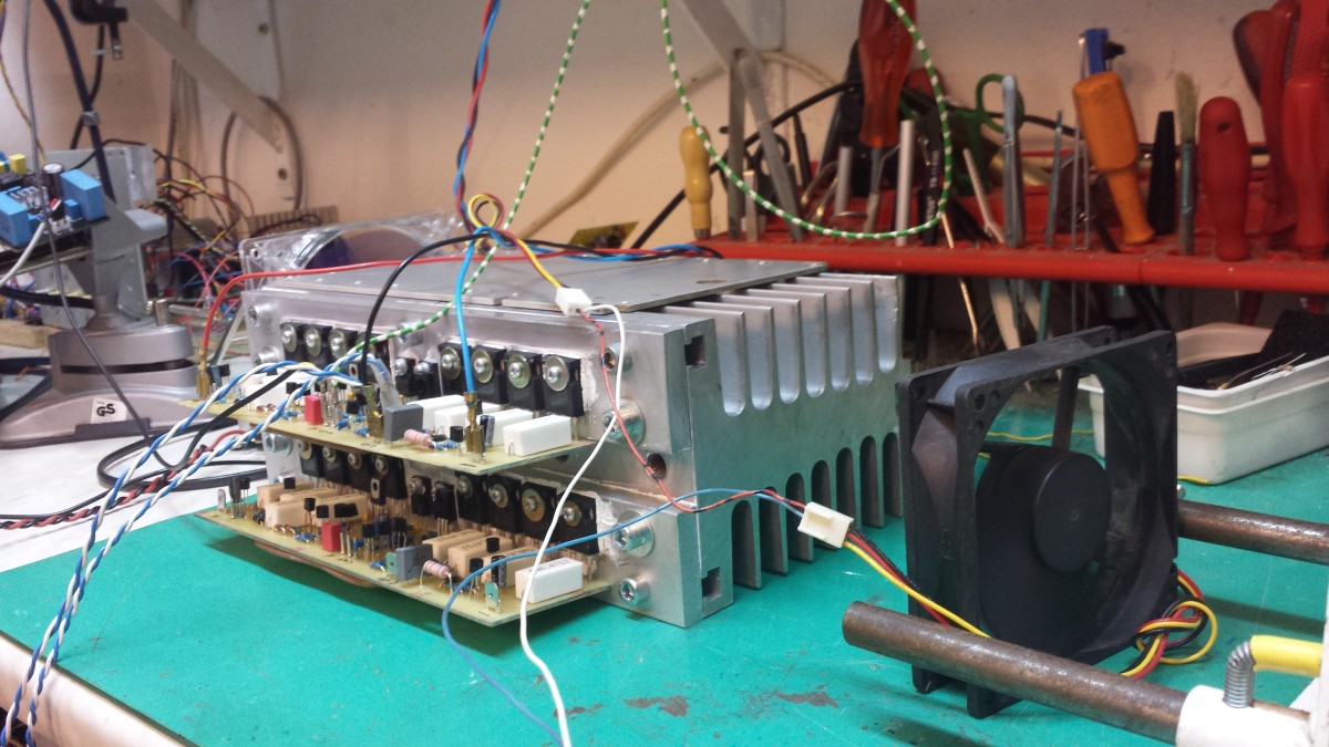

Apex, I replace 4k7 resistor with 6k8 resistor and now protection work. With 10k resistor the LED barely gloves so I use smaler resistor.
One picture from side to see backplate of heatsink.
zoky2
