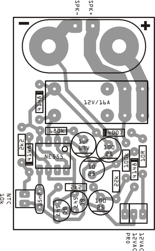

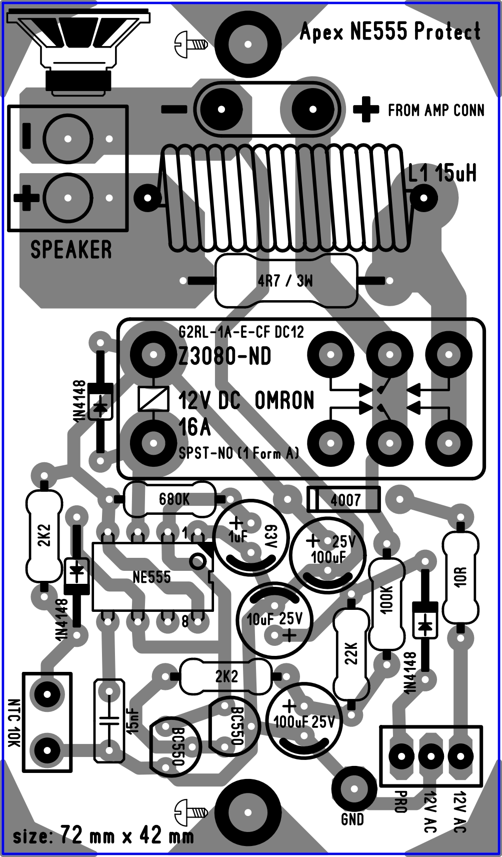

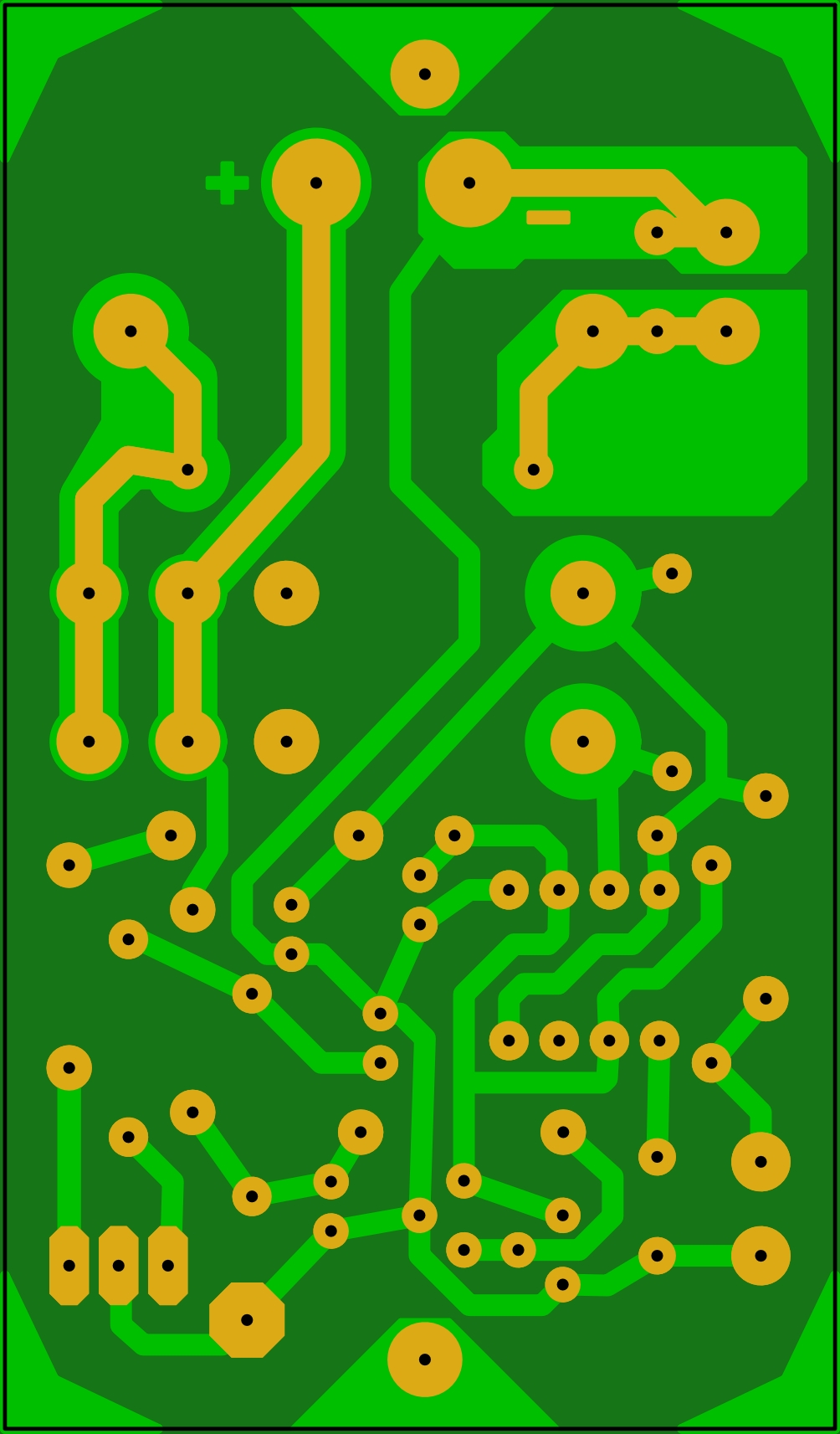

the relay is a common 12V 16A contact manufacturer part number is G2RL-1A-E-CF DC12 or DigiKey search engine part number Z3080-ND
the terminal contact where you see the letter "woofer" part number is 609-3927-ND
at the moment of this writing, for what I read in this section of the Apex HV23 the coils is 15uH ?

Nice pcb, coil is not 15uH but 15 turns on 10mm dia with 1,5mm wire.

got it thanks 🙂

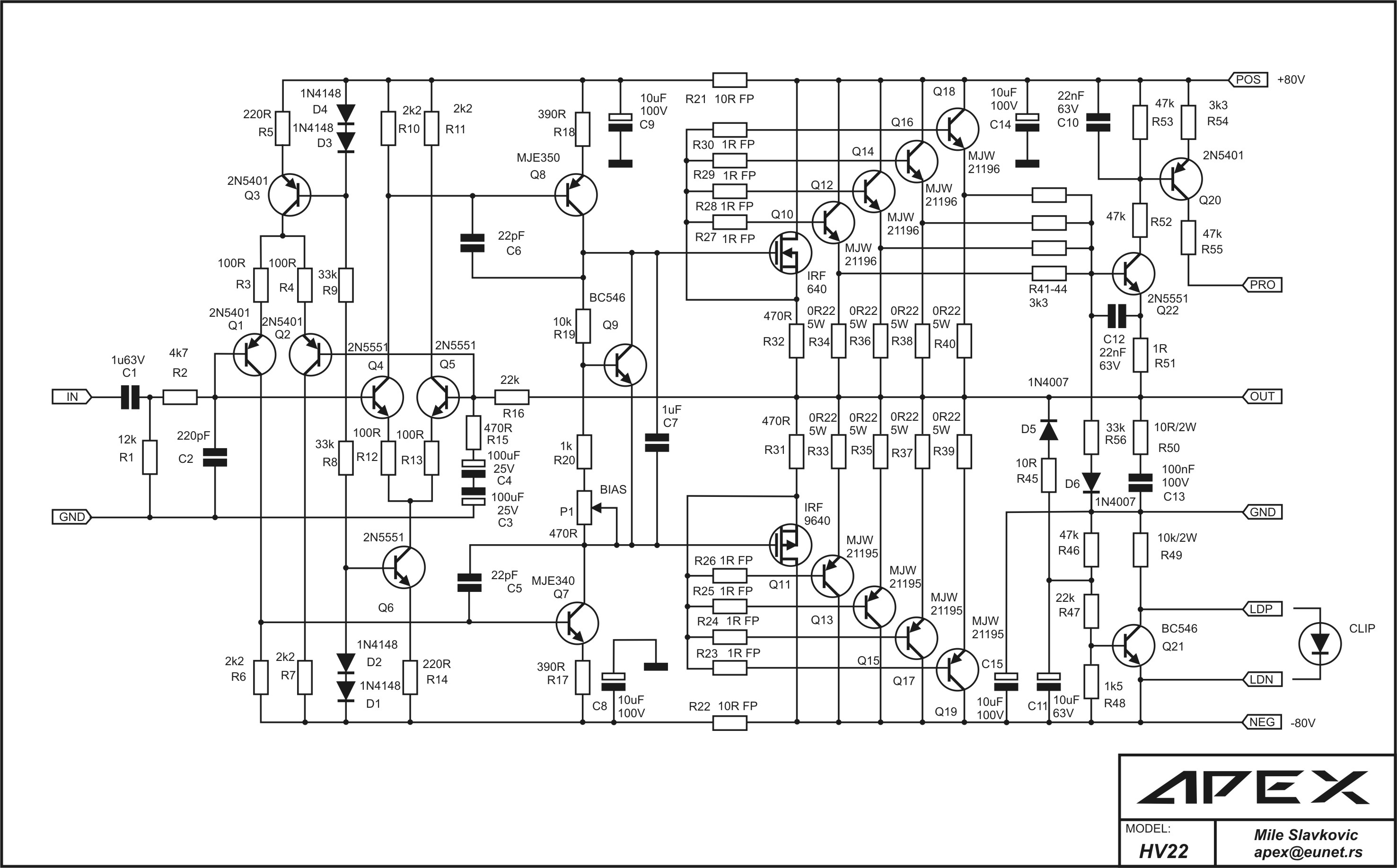

2SA1837 hot
I made a pair of this project, and it sounds great. I´m in the process in adjusting the bias, and secceded I think. Hit around 14mV 5 minutes after startup. Without input, actually while adjusting the bias (or waiting for it to stabilize), I put a finger to the output devices IRPF9240/240, and the temp were OK - i guess around 40-50 degrees celsius - but the 2SA1837 is a lot hotter than the others - but not hotter than I could hold my finger on it. I guess around 60-70.
Is this critical/a problem, or am I just being paranoid? 🙂

VAS transistors 2SA1837/2SC4793 work in class A with 30mA bias and must be hot.

In ither words, I was being paranoid. Thanks for clarifying 🙂VAS transistors 2SA1837/2SC4793 work in class A with 30mA bias and must be hot.

Simple Full Complementary Simetry +/-80V. Voltage amplifier/driver biased with 30mA. This driver circuit stabilized BIAS in output stage. Exelent stability without oscilation, hum and noise, sound great.
RMS Power: 240W 8ohm, 350W 4ohm

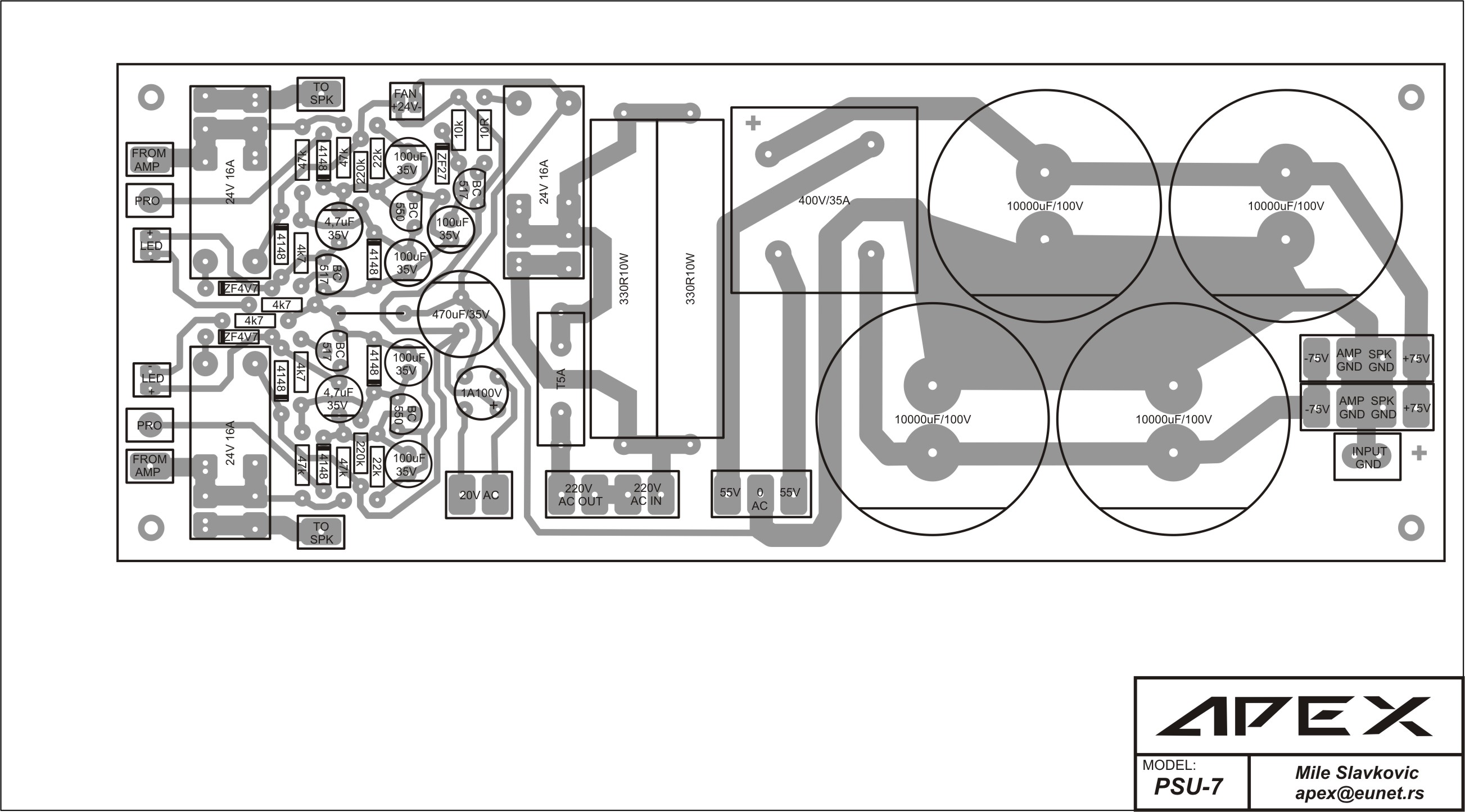

BC517 equation
1. is there any equation BC517 .. I is difficult to find in this area.
2. if I replace Relay with 24V / 5A, what should I change.
please help sir,,
Mr. Mile, there are some questions about this psu7,You can draw schematic from pcb layout, it's simple circuit.

Boedy,
1) Try two BC547 (or BC548) in a darlington configuration;
2) Replacing a relay for 16A with another for only 5A will reduce the maximum power your system will withstand. Hence, maybe it won't last such a long time.
