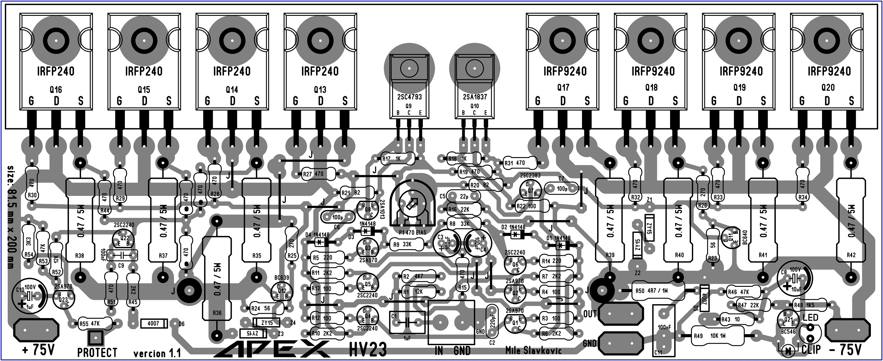

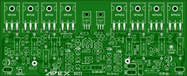

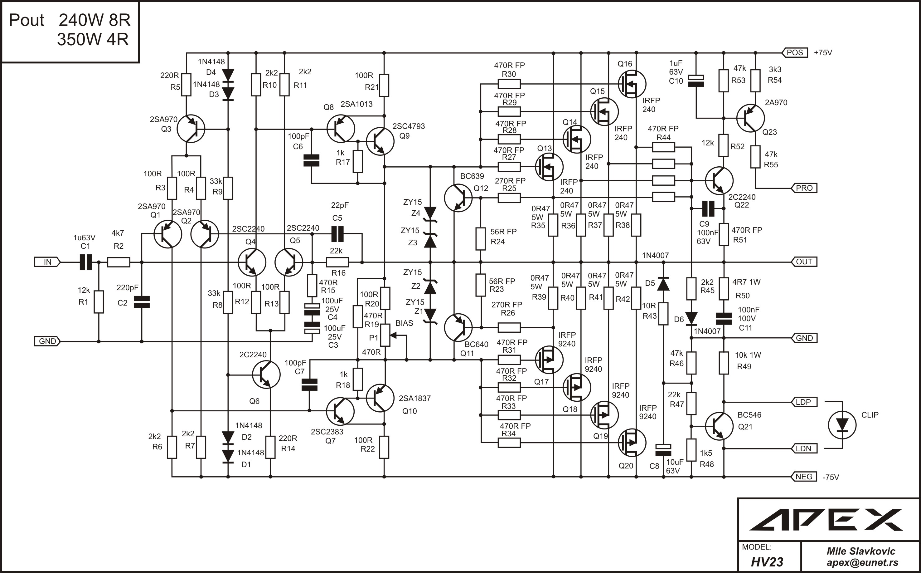

I will try one last time of explaining the problem, I hope I succeed this time. I KNOW how to find out the pinout of the devices, I also know how to read a schematic in general - what I dont know is which leg is the Drain and which is the Source (in the schematic!) posted by Apex in post #374, page 38.
I believe that the source terminals are all the ones closest to their channel's 22uF output capacitors.
Thank you - can someone else confirm this?
This was made confusing by the nonstandard representation. The gate should be drawn closer to the source terminal than the drain on the diagram.
Yes, exactly, thank you so much🙂
I will draw PCB with the source terminals closest to the 22µf capacitors - hope it works. Guess I will find out the hard way 😀

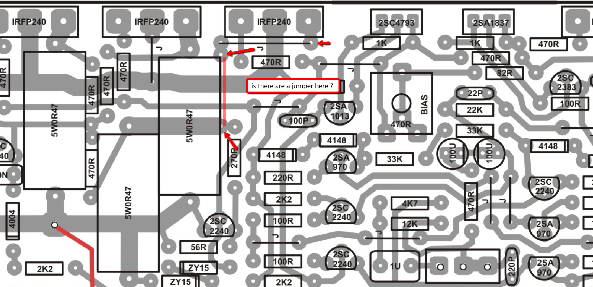

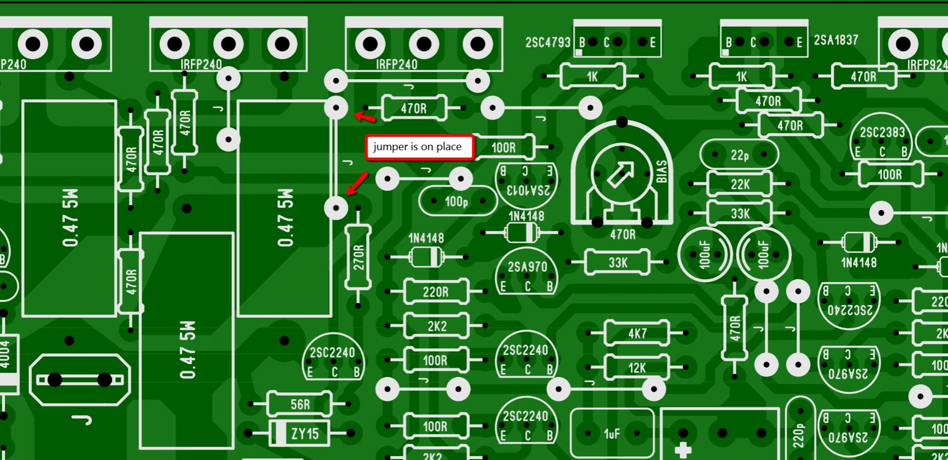

Hello mister Miles quick question, is there a jumper close to one of the 5W resistors ? I'm re-drawing and I stop right there where you see the red arrows 😕
Regards
Juan
Regards
Juan
Regards
Juan
Yes. there is a jumper.

No, you aren't being stupid at all but there is a characteristic of these and many small-signal JFETs that removes the problem.....Sorry if im just stupid - but look at the picture and tell me you are not confused 🙂
Despite the fact that specific pins must be assigned to Drain and Source, 2SK/LSK 170 are among many JFETs that are completely identical in their structure and can be used either way around with impunity. I have this on the authority of wiser heads here (even John Curl now agrees) but of course, some people always become frustrated when things are not placed in a specific order, regardless of whether it matters or not. 😉

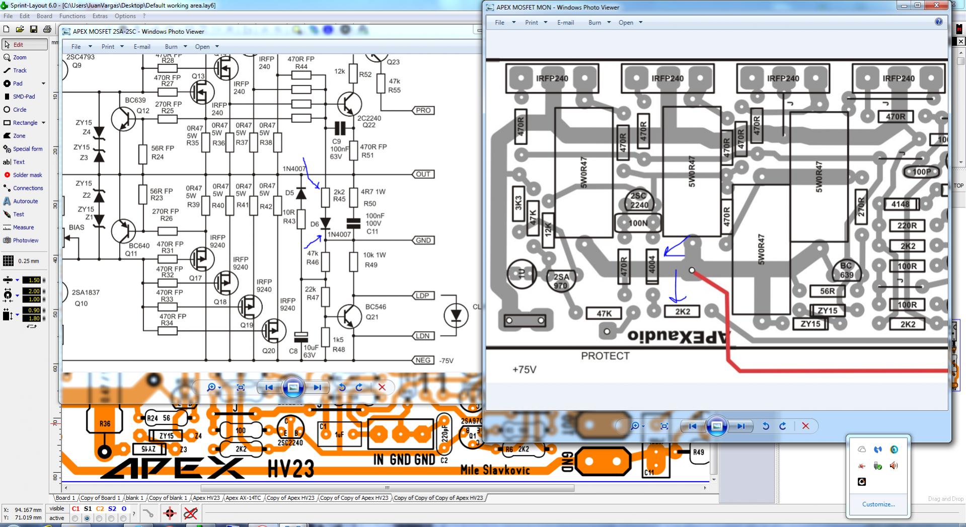

Hello guys
I was coping again the Apex HV23 and it came out that one of the diodes D6 and R45 2K2 is not placed in the same way as the schematic is illustrated ? does some one have a problem it will work the same ? I'm trying to make it as accurate as possible 🙂
Reagards
Juan
Reagards
Juan
Hello guys
Reagards
Juan
Parts place in series connection is irelevant.
sorry mister Miles in other words it will not matter ? I mean just to be sure
Regards
Juan
Place is no metter,

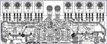

Hello mister Mile
I completed the layout what you think how is it look 🙂 I have it in my collection of Apex amps but one of my USB driver crash and the file was there so I have to remake a new one 😀 is spend more time on this one 😛
Regards
Juan
Regards
Juan
Hello mister Mile
Regards
Juan
Nice pcb,

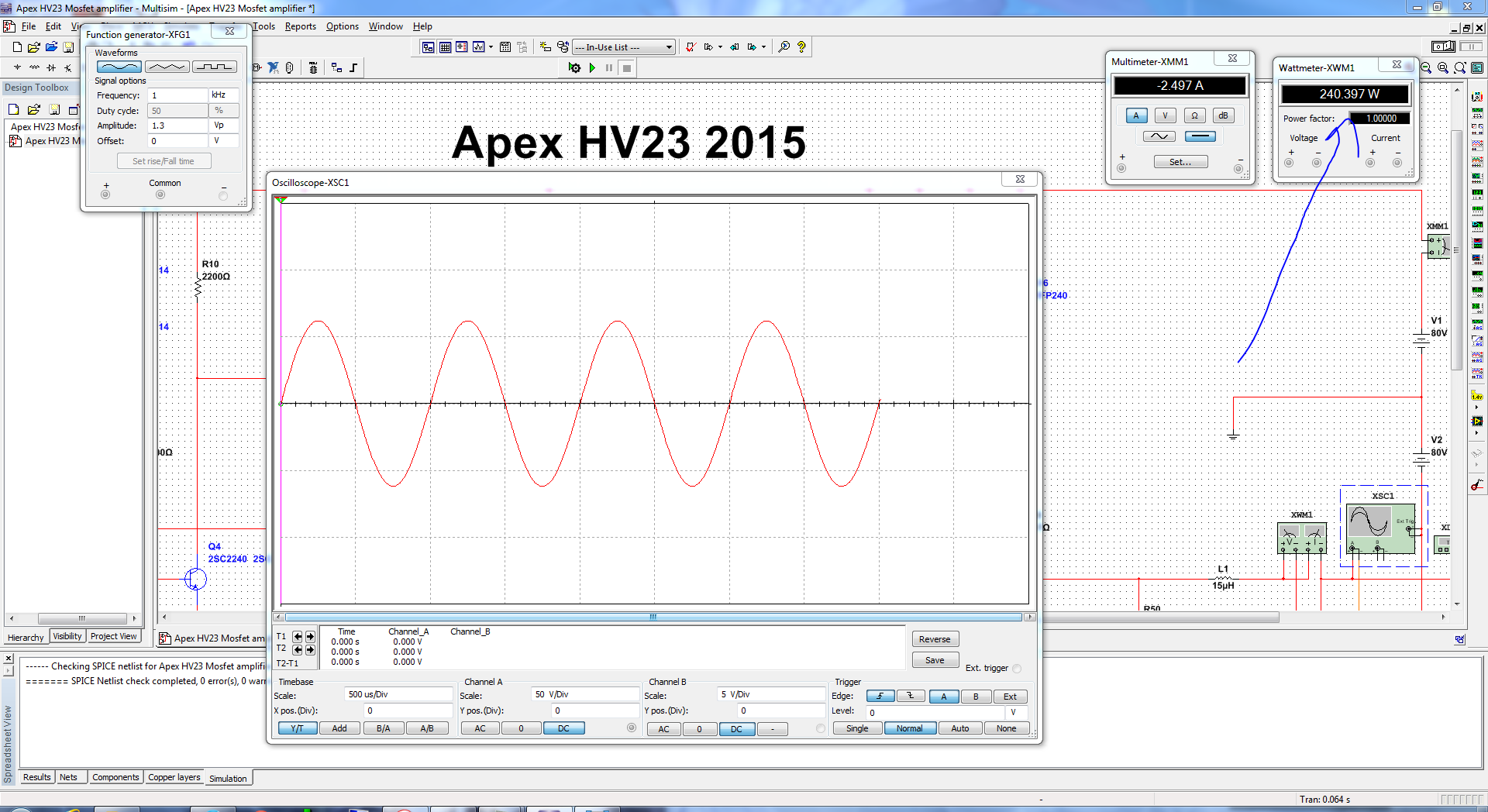

hey I also simulated today and I think I have good results not bad at all, on the software I have it does not have the transistor 2SA1033 I just place a generic one and still behave good I mean I know there are better software to simulate but at least I have an approximation sort like a percentage ok here are the files please if you notice something let me know I'm attaching the schematic I use to remake this layout I bet in real time most be sound really good 🙂
Regards
Juan
