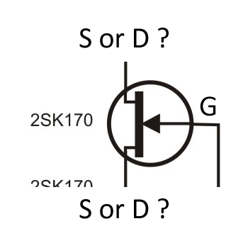

How do I know which leg is drain and which is source on the FET devices? It seems the same - and I cant know for sure if you mirrored some of them.
All vertical mosFETs have Drain in the middle.
Source is on the right and gate is on the left, GDS
All Lateral mosFETs have Source in the middle, GSD
That's with the tab pointing UP, and the markings toward you.

Thanks, but I am aware of the physical layout of the transistors - I was talking about the logical layout in the schematic - sorry if I was'nt clear.
Are you familiar with the difference between the symbols for NPN and PNP transistors?
Are you familiar with any of the many different symbols for all the different types of FET transistors.
It takes 20 secs to find a reference on the net. Just posting a link is surely quicker than discussing what is out there. https://learn.sparkfun.com/tutorials/how-to-read-a-schematic/schematic-symbols-part-2

Thanks Ian, but if you look at the schematic posted by apex (link in my first post), you see that both n and p-channel fets legs D & S are the same - you cant tell the difference - that is what is getting me confused. Please look at my attached picture.
The link you posted shows different kinds of p/n mosfets - you can tell which legs is which because they look different or are positioned different than the others.
Sorry if im just stupid - but look at the picture and tell me you are not confused 🙂
