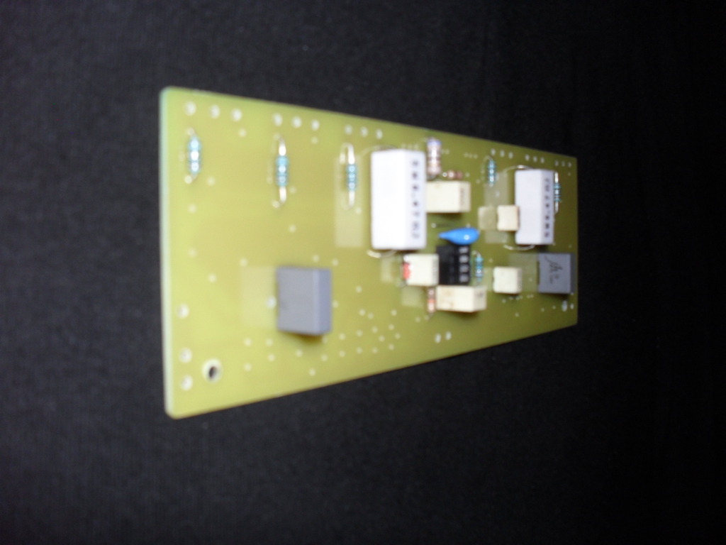

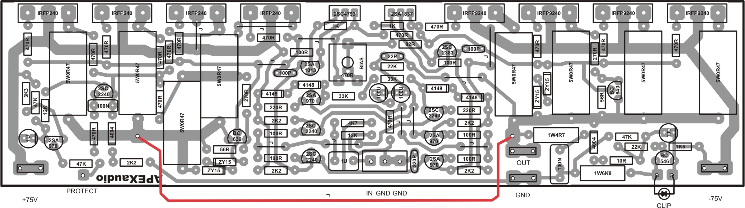

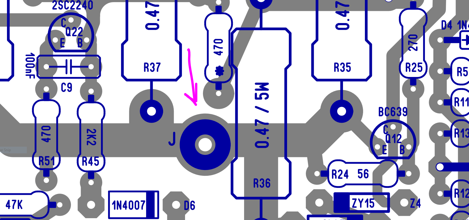

I made errata on me redrawing
I made a mistake on the redrawing of the Apex HV23 I think will be appropriated to mention that I place that 460 ohms resistor close to the J jumper I just fixed 🙄 fieuuu ! that will be really sad if I order some and that mistake is there catastrophic failure to me lol 😛

Dear vargasmongo,
Can you kindly post the circuit diagram of the Apex HV 23, which corresponds to your layout ?

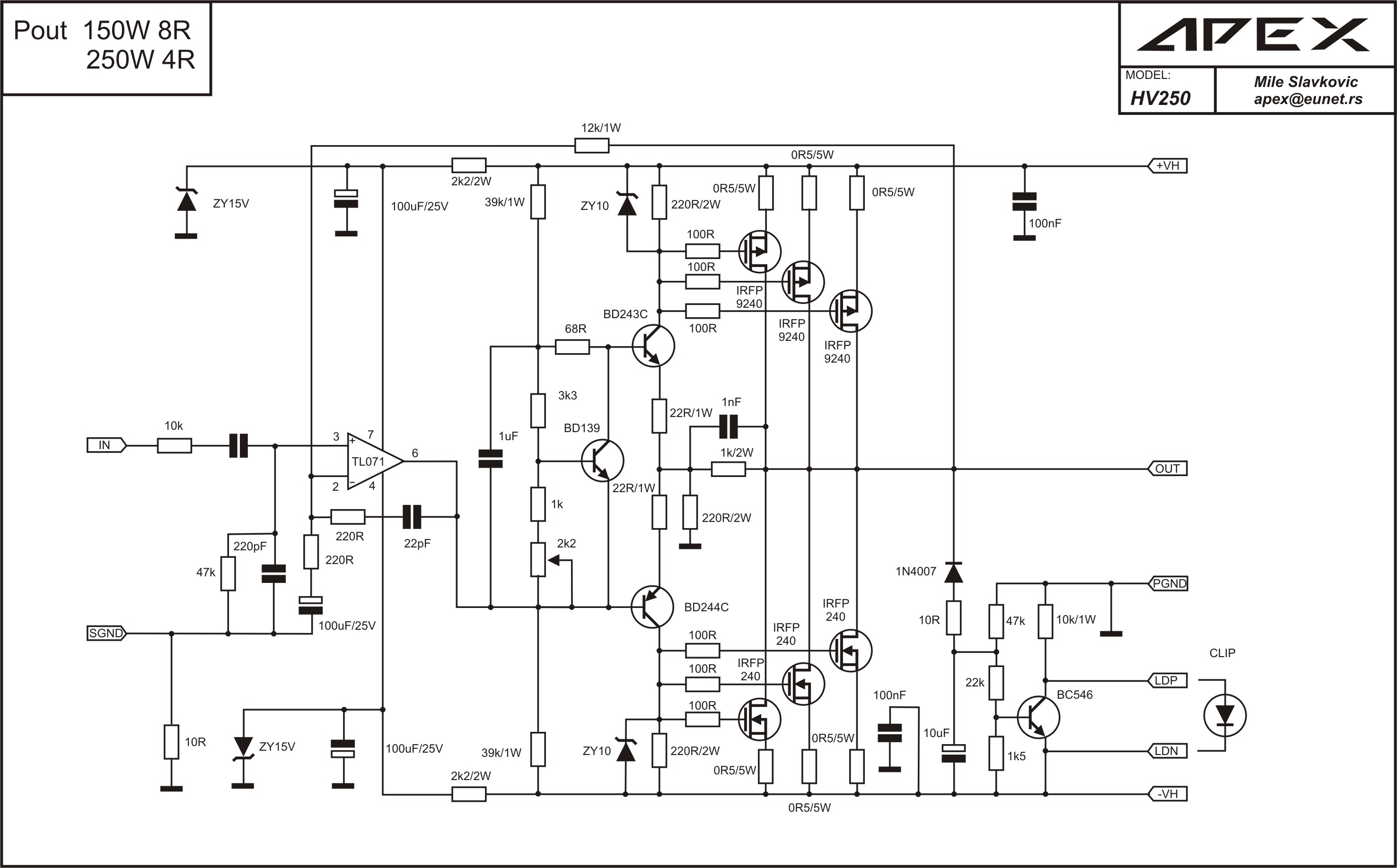

Hi Mister Mile, meanwhile I redraw your HV250, because I intend to do it. I would like to hear your opinion. Which is the maximum DC+/- voltage to run 4R, +/- 70VDC? Which value should I put on zener resistor.
Thanks in advance

Hi Mister Mile, your HV250 goes slowly... I have 2 question: 1º Can I replace on positive rail NPN BD243C (65W) to 2SC4793 (20W) or MJE15032 (50W) and the same on negative rail with PNP transistors. 2º To match IRF'S I intend to use your topologi, can I use 15V insted 12V.
Thanks In advance

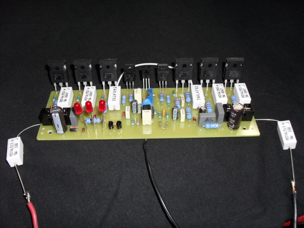

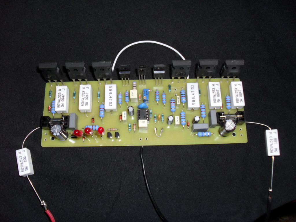

Hi Mr. Mile ! Here I am again with your HV250. At a first glance it is OK, but how many volts should a get on 10R/5W (that I put on rail +/-), in order to get a good bias. Thanks in advance.
Pozdrav

Do not set your bias with the voltage dropping resistors in the supply lines.
Remove them after you have proved the circuit works correctly.
Use the source resistors in the output stage as your indicators of output stage bias.

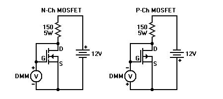

OK AndrewT, thanks for your advice. I matched the powers and how many volts should I get on source resistors. Maybe 0,023V it means 48 mA per mosfet, is it good ? I know you love calculations 🙂
3pair output stage equals 6 source resistors.
Set the bias voltage low to start with, maybe 10.0mVdc across Rs1 and measuure all 6 after they have reached equilibrium.
Then increase in 10.0mV increments allowing time to resettle and re-measure.
By the time you get to 50mV (100mA) you have a table of measurements for all 6 Rs
You will see if they all remain very similar, or some wander off a little, or a lot. This will really show how well you selected for Vgs.
