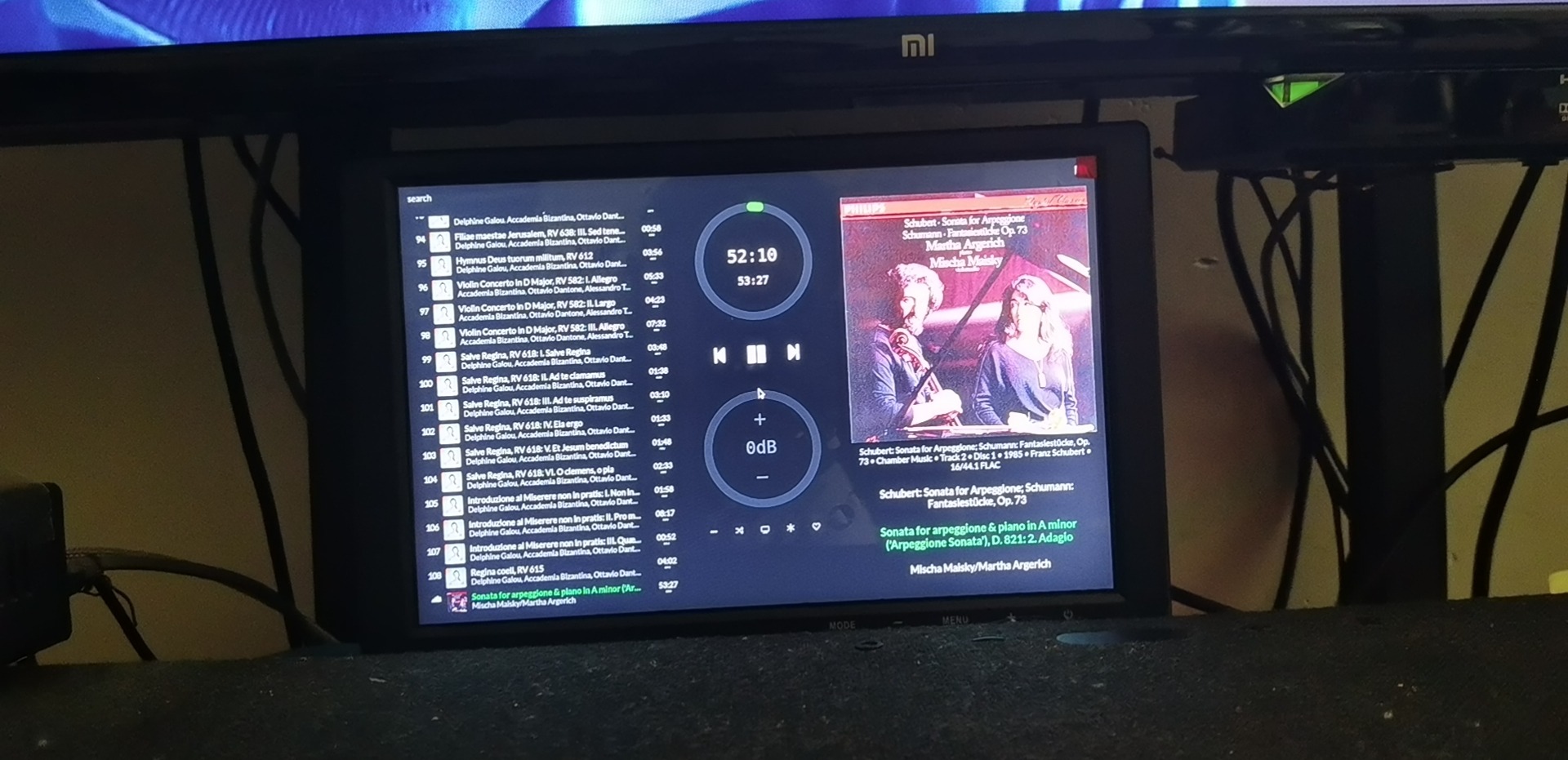

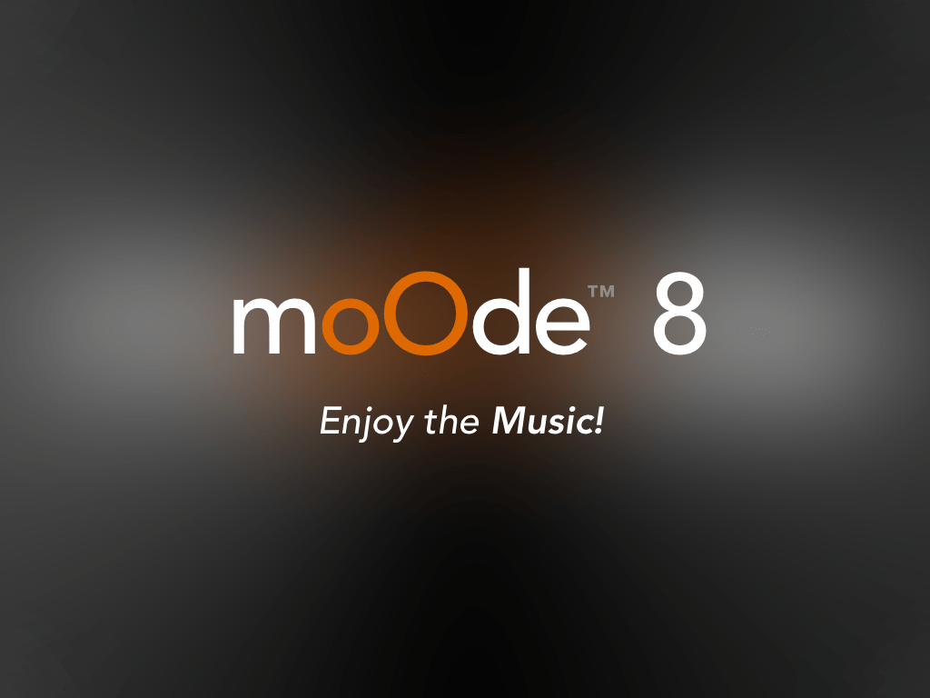

great that the moode 8 is out and just try it out in my Pi4 1.1 version.
all is very good except that i found the display function does not show up to my 10inch monitor connecting with a HDMI plug. when i play music .
i had the screen showing during playing music as below picture but now, with the new version of moode 8, it just a black screen and nothing show.
but when i reboot or power on the pi4, the monitor still shows all the scripts and programes reading .
i am not sure if it is relate to the ratio or anything else. my hdmi input monitor is 1280x800
please advice how to fix it.
thanks.

thank you . it worksMenu, Configure, System
Scroll down and turn on Local UI display
but i have another question, why i have another moode 6.4--or 7.01 version of the moode and can not use the same method to display on the HDMI monitor? not the DSI connect.
will there be any reason that the moode file lack of the driver or scrips?
how can i try to add this if i am not sure if it is lack of the scrips to run for dhmi display?
thanks
