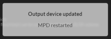

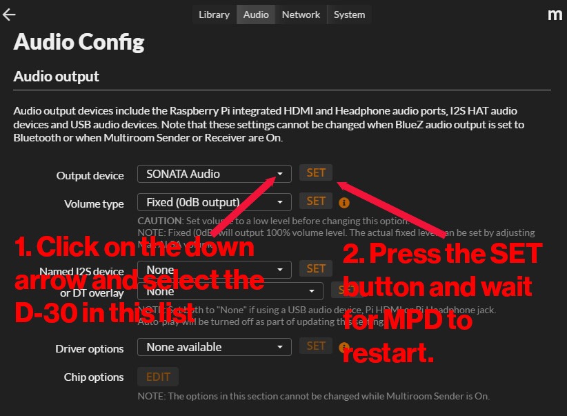

First, set the DAC as output:
Then wait for MPD to restart:
You should now be able to play the Stereo test file located on the sd card and hear it coming from your DAC.

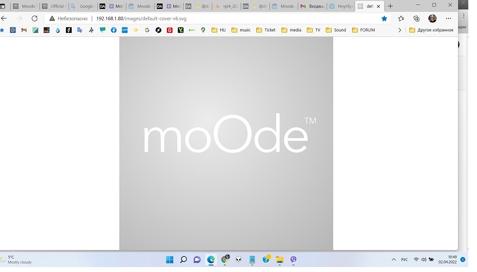

The player worked for 2 hours and passed out. Then I uploaded the MoOde 802 image to a completely new 32GB SD card. It reboots normally on RESTART, but falls asleep on SHUTDOWN but turns on RECONNECT and the player does not turn on. Connection timed out. repeat and the same. Loading only by pulling the cable. I did not change anything with the system, only the time zone. Another question: after various manipulations with the player settings on the old SD card, Chrome and EDGE do not open the player interface (the connection is not secure). Only Firefox opens the web interface. Tom doesn't recommend using Firefox.

I suggest you have network issues, or browser issues (latest browser updates? stale cache?), or both.
