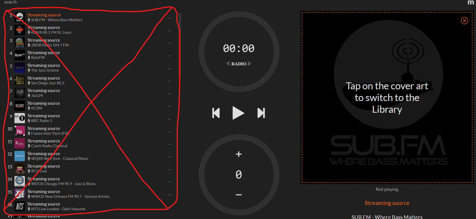

I have 2 other questions.
1, how can I change the home UI screen? I want to replace the list of streaming sources (red box with X) with sources I will actually use (Spotify, USB phono preamp, Bluetooth)
2. Is there an on screen Spotify interface? Whenever I do Spotify Connect I get an overlay that says something like "Spotify Connect" with nothing but a "disconnect" button. I guess if there's nothing I will replace that with a Peppy Meter UI.
On the right of the area you marked there are 3 dots per source (column of) click/tap on any and the move/remove option will open.
To replace sources...and note these are Music sources not hardware sources...tap/click on the big area far right that will send you to the library screen where you can select music/radio streams to add to the playlist.
On first start the playlist..far left..is populated with all the MoOde included radio streams.
OK, I was able to clear the default music sources.
Is there any way to get hardware sources on the front page?

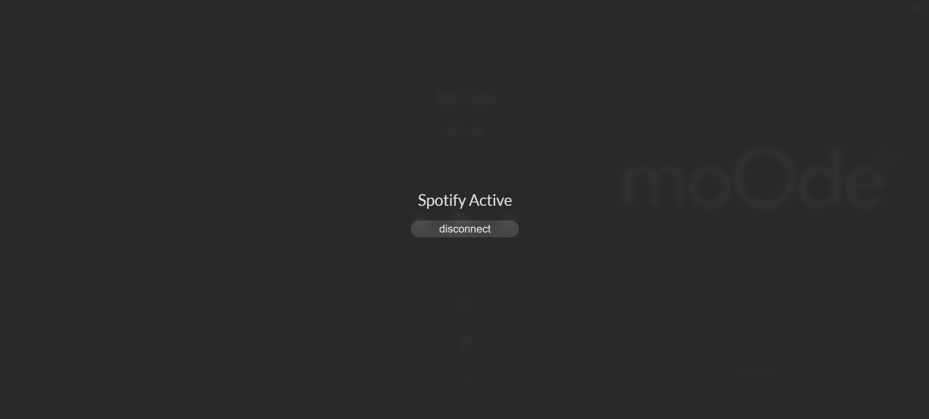

Also, when I activate Spotify Connect I get this screen........... is there any way to get another screen with controls?
Not that I am aware of but you might be better asking over at the MoOde forums..Is there any way to get hardware sources on the front page?
https://moodeaudio.org/forum/index.php
I don't use spotify so again try the forums...although I believe this is the expected result. MoOde acts as a spotify renderer and you control it from the the device you run your spotify account from..Phone ?
