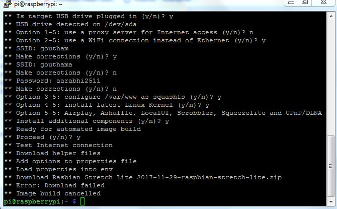

Download error
Hi I am facing problem while creating image through automated image builder. Anyone else facing the same issue? Please find the attached screen capture for details.
Regards
