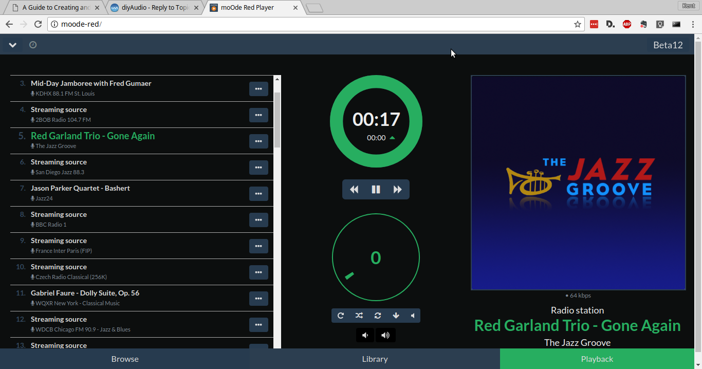

Now forget ssh and connect to moode.local via a web browser.
No avail🙁. Moode is visible through my router's dhcp client and showing ip address and Mac address. I am using same ip address to access moode through browser (tried both Mozilla and and Chrome) but not able to connect. However, using same ip addres I can acces moode through putty but it shows only cmd prompt. Tried mood. local as well

I'm not certain what you want to do here.
If you can access moOde through browser using the IP address then you *are* connected to the moOde GUI; it's the page you see in your browser. I've attached a screen capture from one of my players showing the Playback panel.
At this point, any moOde configuration and customization can be done through a pull-down menu you expose by clicking on the label "Beta12" in the upper-right hand corner of the page [note that the text of this label will change in the final moOde 4.0 release].
Again, if you can login with the same pi/moodeaudio credentials, and are now at the cmd prompt, then you *are* connected but this time to a Linux terminal not the GUI.

I think he is saying that he can't access moOde through IP/browser, but it does connect via ssh and it shows up in his router's list of attached devices.

You have to wait to the modbuilder process end (downloading stuff, compilation mpd, etc.)
For example, you can see the Raspbery Pi as "moode" in your router list of connected users but it's doing stuff in the first reboots (for example, installing the web server, etc.). You can access via SSH but I don't recommend it (if you try to run via SSH the modbuilder.sh in Stage 3B and it fails because apt-get lock, the script gets deleted and you have to start from scratch again).
Wait a while and then try it again 🙂
