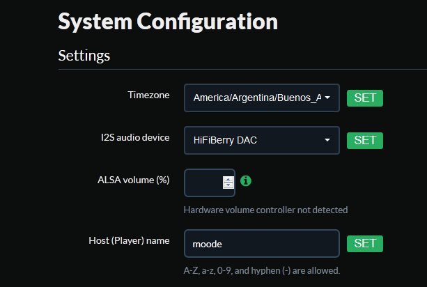

FLAC 16/44.1 with hiss and distorted, Web Radio, FLAC 24/96 and 24/192 is OK
Previously I was using my DAC (a Chinese I2S ES9018 based) with Volumio 1.5 + Raspberri 1 B and the reproduction of the FLAC and MP3 files was very good, but I could not play DSD, but when I upgrade to Raspberri 2 and Volumio 1.55 to test if I could solve the problem with DSD, I couldn´t work RaspBerry 2 + Volumio 1.55 with my DAC by I2S.
Because I found great reviews from Moode I decided to try this.

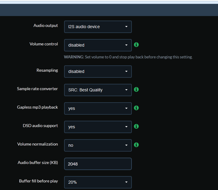

My problem is when I play FLAC 24/96, 24/88.2, 24/192 or Web Radio, Raspberri 2 + Moode 2.3 + DAC works fine, but when I play FLAC 16/44.1 sound has hiss and very distorted.
As my DAC is not listed in Moode I am using as I2S device a "HIFIBerry DAC"
My DAC (Without Amanero board): https://hifiduino.wordpress.com/2013/07/19/another-4-layer-diy-es9018-board/
I tried several I2S devices in Moode´s configuration but without success.
What could be the problem with FLAC 16 / 44.1 as with other formats the Raspberri Pi 2 + Moode 2.3 + DAC work well? I do not have any other DAC with I2S interface.
Attache System an MPD configuration.
Daniel.

Hi Daniel,
This is caused by incompatibility between hifiberry-DAC'sdriver and the ES9018 DAC.
The ES9018 expects BCLK to have fixed relationship with Sample-Rate. (x64 or x128, I cannot remember).
The Hifiberry DAC driver calculates BCLK frequency based on bit-depth. So, for 24-bit, the BCLK comes out OK. For 16-bit, it is always too slow.
The workaround:
Use SoX to resample your 16/44.1 FLAC to 24/44.1 or 24/88.2 (I like this better). The file size is only a little bigger, and it will work with ES9018. Please try it!

Hi Daniel,
The workaround:

Hi Daniel,
Workaround:
(1) select "RPi DAC" in the "I2S audio device" dropdown, then press SET. This particular DAC uses /etc/modules instead of dtoverlay. Don't reboot yet.
(2) ssh root@moode (pwd = moode)
(3) nano /etc/modules
(4) enter configuration for the 9018
(5) Ctrl-x y <return> to save file
(6) reboot
If successful, post back contents of /etc/modules along with the name for this DAC and I'll code the i2s config and audio device description for it in release 2.4 🙂

Hi Tim,
I can confirm that the ES9018 in normal modes requires BCLK to be set at 64×Fs for all sampling rates.
I think the problem is that the Hifiberry driver sets it to 2× sample_bits:
FloriansHifiberryDriver said:
return snd_soc_dai_set_bclk_ratio(cpu_dai, sample_bits * 2);
For example in Line 40 of:
https://github.com/raspberrypi/linu...df91358e1eca56b/sound/soc/bcm/hifiberry_dac.c
Where:
return snd_soc_dai_set_bclk_ratio(cpu_dai, 64);
would be appropriate for ES9018.
Haven't had a chance to try changing it though, so I can't be sure that it would be enough.
What I did test though:
- Using Hifiberry DAC driver and I2S, I measured the BCLK for a FLAC file 16/44.1.
This gave a ×32 BCLK (1.4112MHz).
Using SoX to convert to 24bit gave BCLK 2.8224MHz (×64, as desired). I assume then that the channel is either 16 or 32 bits.
