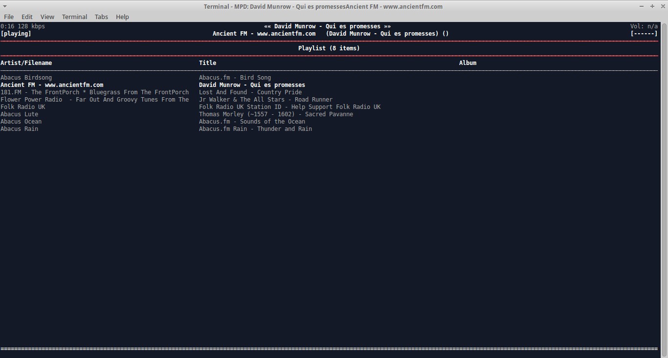

So I installed ncmpcpp on the Pi as a local client and connected a monitor. Problem solved !
It's not pretty but it does most of the basics, and then some, including creating playlists, database updates, file searches and if you only want to run from local attached drives without any network it will do that too. Additionally single keystrokes do most navigation and control tasks.
Installation is pretty simple (and, as I know less than zip about programming and code, is reasonably well documented.)
I have put together a very simple guide, for anyone as ignorant about computing as I am, to get the local display running.

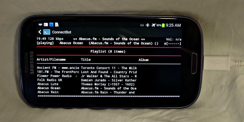

Along the way I did find out how to get a reliable connection to an Android device to use as a local Pi-screen substitute.That was a lot trickier but may have uses, perhaps to ssh in or for a screen in an appliance.
Tested Local Display options for MoOde using ncmpcpp for music playback and file navigation.
Download and setup MoOde ….
Set preferences for time zone, audio device and driver, volume control, and configuration for NAS, sources, radios. Then expand the filesystem.
Option A) Monitor connected to the Pi Hdmi port and a usb keyboard.
Option B) Usb tethered Android Phone or Tablet with on-screen keyboard.(and/or bluetooth keyboard)

Here is an example of mine you can copy and paste to get the idea of the sorts of changes that work. Give it a try and observe what is different from the default. Then modify it to suit.
save and exit (Ctrl+o...enter...Ctrl+x)
This config is useful if you use playlists with several radio streams. It displays each station name as well as song title and artist. It also displays bitrate, volume setting, elapsed time, and a progress bar.
(it doesn't display lyrics, bouncing balls, music visualisers or fresh-fried fruit salad.. things I can happily live without.)
Some items are duplicated in the headers but that, so far, is the only way I could get Radio stations and tracks from usb drives to all display consistent information. Feel free to tidy it up and if you do let me know what you did.

Meanwhile on your Android device go to the Google Play Store and download and install ConnectBot
https://play.google.com/store/apps/details?id=org.connectbot&hl=en
(there is a fork called VX Connectbot some users prefer but Connectbot works fine for me and seems to be more recently updated)
then install Hackers keyboard..
https://play.google.com/store/apps/details?id=org.pocketworkstation.pckeyboard&hl=en
On the Android device go to settings=> language and input and enable the Hackers keyboard then go to it's settings where you want to enable 5 row keyboard (for portrait and landscape modes to give access to the scroll arrow keys) .
Open Connectbot and go to settings
Select 'on' for 'Volume keys change font size' , 'Remember keys in memory','Rotation mode Automatic', and 'Persist connections'
Think about whether you want the display to be always on or for it to sleep, and select your preference.
Connect a powered USB hub to your Pi..
Without this your Android device will draw too much current causing the Pi to randomly drop connection and other odd behaviours. This was the case with my PiB.
I haven't tried a Pi2 but if your experience is other than totally smooth then suspect the power supply and use a powered hub.
Connect the Android phone/tablet via a usb cable to the usb hub.
You might want to turn off wifi, Bluetooth, and phone services too.
Perhaps even activate airplane mode, particularly if you don't want to be disturbed while listening..
(I have an old Galaxy S3 with no sim so it is permanently in airplane mode and kept for tasks just like this)
If you want to use a Bluetooth keyboard to control ncmpcpp instead of the onscreen one reactivate Bluetooth and pair it now.
Now power the Pi and on and wait until it has booted.
On the Android device go to settings=>networks=>more networks and activate usb tethering.
Open Connectbot on your android device and type...
pi@192.168.42.42
then hit enter.....
Wait for the password prompt and enter..
raspberry
Once connected run....
ncmpcpp
and there it is...

Code:
sudo /etc/init.d/networking restart
Now open Connectbot and reconnect using the stored login.
Type your password at the prompt and when you're connected run ncmpcpp to return to the player. Done.
Because ncmpcpp is just another client for MoOde it can be run in conjunction with, and mirroring to, other clients.
If your Pi is network connected and you run ncmpcpp on it locally you can, at the same time, be running the full MoOde interface somewhere else, on your smart-phone, and on a laptop, and on a desktop, and be running ncmpcc from an ssh session on other laptops/desktops and any selections/changes made in any instance will be mirrored in all other instances.
Or you just might be out in the workshop with no network whatsoever, a usb flashdrive full of your favourite tunes, and controlling MoOde with ncmpcpp and a keyboard. Enjoy.
- PC Based
