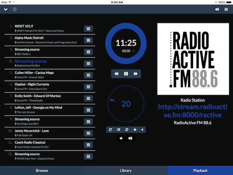

Can you include this one? it is the oldest independent, listener-run radio station in NZ - going 38 years now.
Undertheradar » Music News » Radio Active in Wellington 30 years on and still kicking
RADIOACTIVE FM | FCKN@
It was one of the first stations in the world to get on the Net, being housed in part of Victoria University at the time and 'owned' by the students association.
It was integral to NZs fledgling alternative music scene, especially during punk/new wave, when they would play what the mainstream sites wouldn't.
It's still going strong - my good friend Pete has been a DJ there almost since its inception (and despite his law practice taking up so much valuable spinning time).
If you need anything technical, just ask. If you want a higher quality feed, I'm sure I can arrange it 🙂
So awesome.
So it shall be written. So it shall be done.
