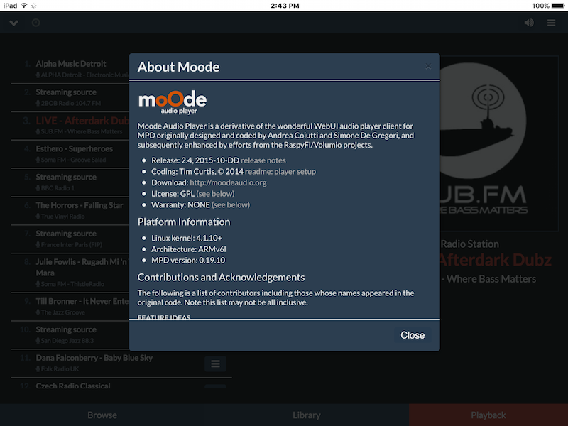

Just a brief update on release 2.4 🙂
Testing with Linux kernel 4.1.10+ and MPD 0.19.10 going good so far. This is exciting because:
(1) Linux kernel 4.1.10+ has overlay driver for the new HifiBerry DAC+ Pro Dual Clock board. This implementation operates PCM5122 DAC chip in master mode thus allowing for more precise clocking and lower jitter. Could be really nice.
(2) MPD 0.19.10 has a lot of bug fixes and improvements. I've compiled it with some additional options which may be useful in future. I'll post the full options list in a few days for review.
