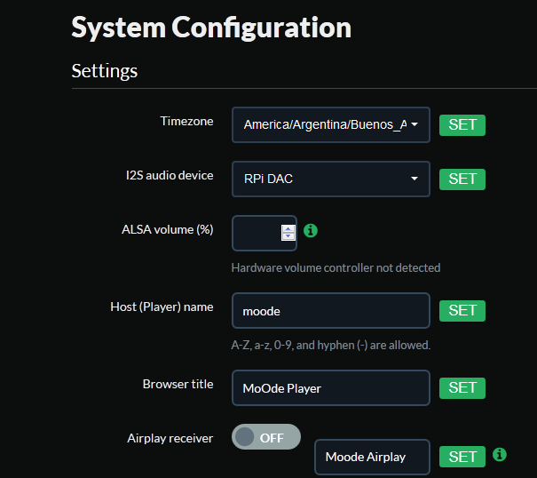

Hi Daniel,
Workaround:
(1) select "RPi DAC" in the "I2S audio device" dropdown, then press SET. This particular DAC uses /etc/modules instead of dtoverlay. Don't reboot yet.
(2) ssh root@moode (pwd = moode)
(3) nano /etc/modules
(4) enter configuration for the 9018
(5) Ctrl-x y <return> to save file
(6) reboot
If successful, post back contents of /etc/modules along with the name for this DAC and I'll code the i2s config and audio device description for it in release 2.4 🙂
Tim
P.S. @Rod Coleman, thanks for the info on 9018 🙂
Hi Tim,
I did the following tests:
select "RPi DAC" in the "I2S audio device" dropdown, then press SET, change "/ etc / modules":

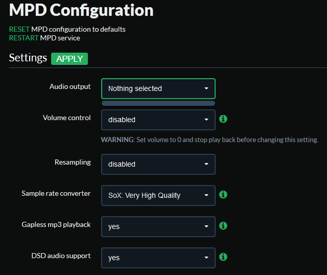

After reboot in MPD Configuration, under Audio output: "nothing selected" (attached picture).

Hi Daniel,
I did a quick search "snd_soc_bcm2708 missing" and ran across posts indicating that the module "is no longer needed" which would explain why it is not in the newer kernels, but why its not needed anymore, I don't know.
The only i2s dac coded in Moode that does not have or work with an existing i2s dtoverlay driver is the RPi-DAC, it requires /etc/modules according the maker as I recall.
What happens if u remove snd_soc_bcm2708 from /etc/modules ?
Its looking like a dtoverlay i2s driver is needed for ES9018 chip.
