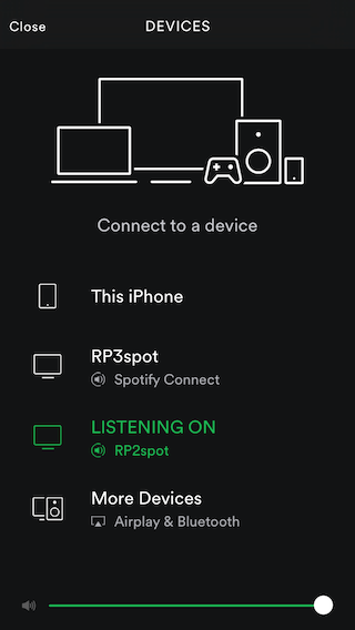

This was easy to try since its just a single binary but I'd ADVISE CAUTION because when I tested it, the Spotify IOS client set volume to 100% on first connect! See attached image.
Fortunately I've learned from experience to only test these types of apps using an audio system that has its own physical volume control (set to 0).
Some issues I encountered:
- Volume stepping used by Spotify IOS client is very corse, only 10 steps to full volume using the physical iPhone buttons.
- The slider volume control within the Spotify app behaves similarly in that it raises volume too much within the first half of the slider.
- No support for hardware volume yet in librespot
The good things with this fork of librespot are:
- It doesn't require a spotify app_key
- It has before/after playback hooks which like shairport-sync, allows it to more easily coexist with MPD
- Its a single binary (compiled from Rust sources)
- It has good debug logging in general but human-readable logging for volume commands should be added
This looks promising once the volume issues are resolved.
-Tim
