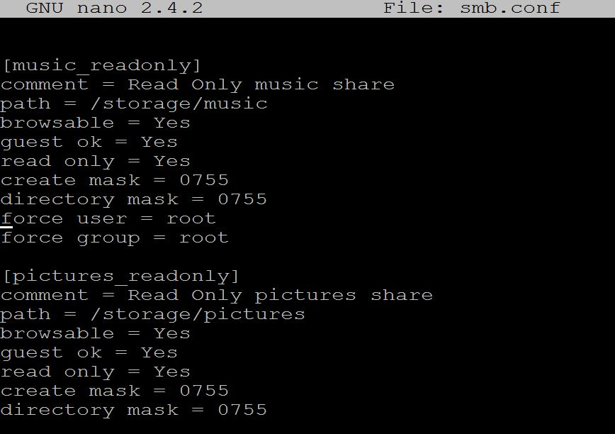

OK, well I had this working via nfs but I then updated Vortexbox to V2.4 and now I cannot connect at all.
My understanding is that Vortexbox makes the music folder available via both nfs and a samba share. I'm going to focus on the samba share...
In windows I can use windows explorer, browse network, see the vortexbox machine, and when clicking on it see the samba shares. The one I'm interested in is called music_readonly
I can click on that and browse the files. I can also map it to a drive letter on Windows just with a couple of clicks. No user, no password required.
In Moode no matter how I try to configure the source I cannot make a connection, and now after a few attempts if I try to access the configure source screen in Moode it just hangs... Even after restarting Moode I get this hanging..
BTW when upgrading Vortexbox to 2.4 it was reassigned a new IP address by the router and moved from 192.168.0.8 to 192.168.0.59. I can't see that this should make any difference though.
I have attached the relevant part of the smb.conf file from Vortexbox...

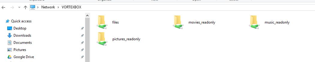

And here are the Vortexbox shares as viewed in Windows Explorer.
