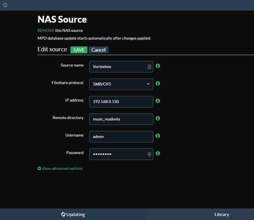

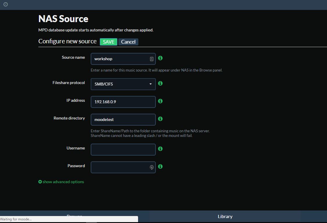

OK, so I created a shared folder on one of my windows machines, shared with "everyone". The share name was moodetest.
I can't even connect to this from moode sources screen (entry as in attached image)....
What gives?

Try it with a dummy userid and password for example 'admin', 'password', or with your Windows logon id and password.
-TIm
Thanks Tim but no luck with that either. Any attempt at entering details for an SMB/CIFS share connection results in a neverending hang with Moode. Each time to recover I need to connect to Moode via terminal and clear out the entry from the sql database using the procedure you had posted.
I think I should reformat the SD Card and install a fresh copy of Moode and then try from there.
OK, a lesson here for anyone following. I formatted the SD card and installed a fresh copy of Moode. Bingo... all is working.
Note that for the SMB/CIFS share connection to work I needed to put in a dummy username and password... I used admin and password. This was for both connecting to the Windows share I created for testing, and also the samba share on Vortexbox.
Picture attached for reference.
