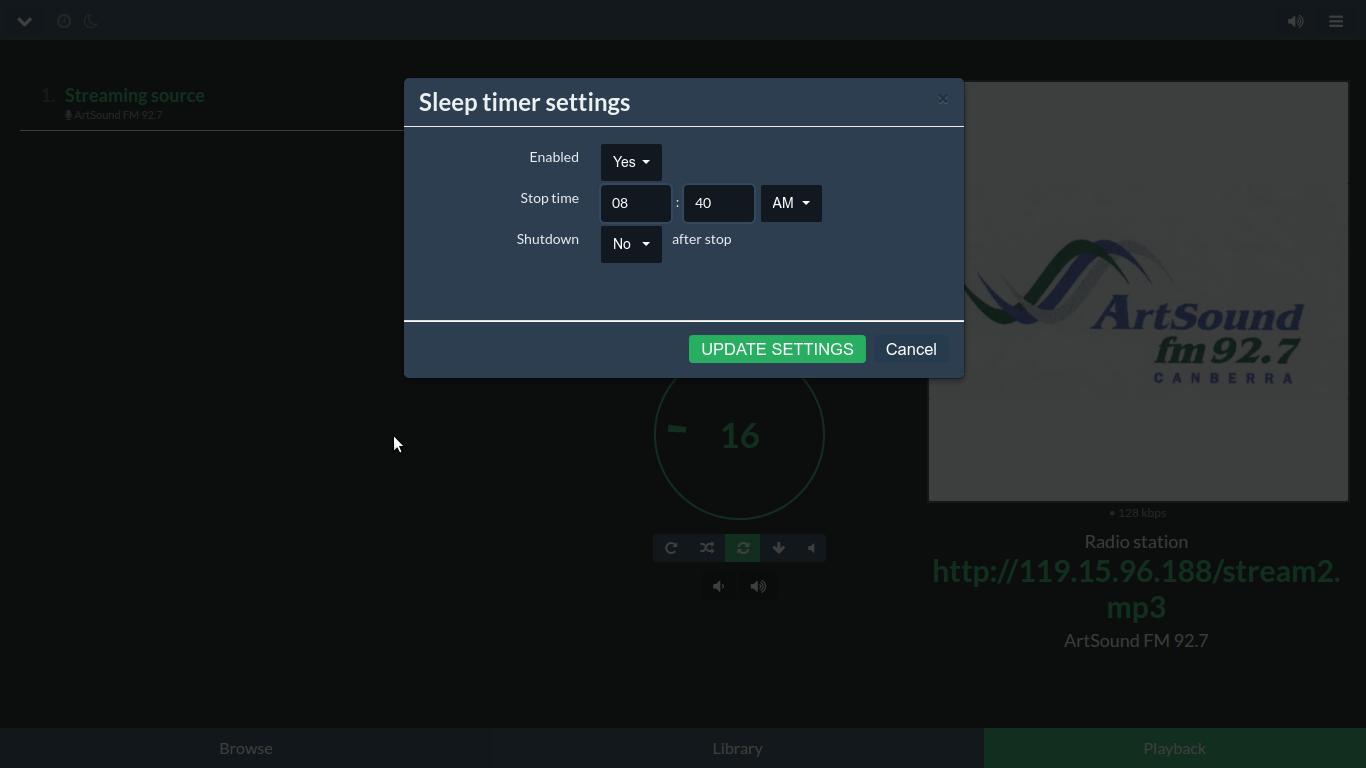

Progress report on Sleep Timer:
Only a little progress, thanks to my coming down with a wicked head cold/sinus infection last weekend.
My V.0 Sleep Timer works more or less as I described a week ago. (#5973) It's based on copying and modifying the existing Clock Radio code. I had only to modify 9 php/js/css/db files to get here.
In this version, one enables the Sleep Timer and chooses a wallclock time, see the attachment.
I have some work to do to get to V.1 by changing the stop time from a wallclock time to a time interval (e.g., stop in 30 minutes instead of stop at 10:30AM). Now the code gets interesting.
