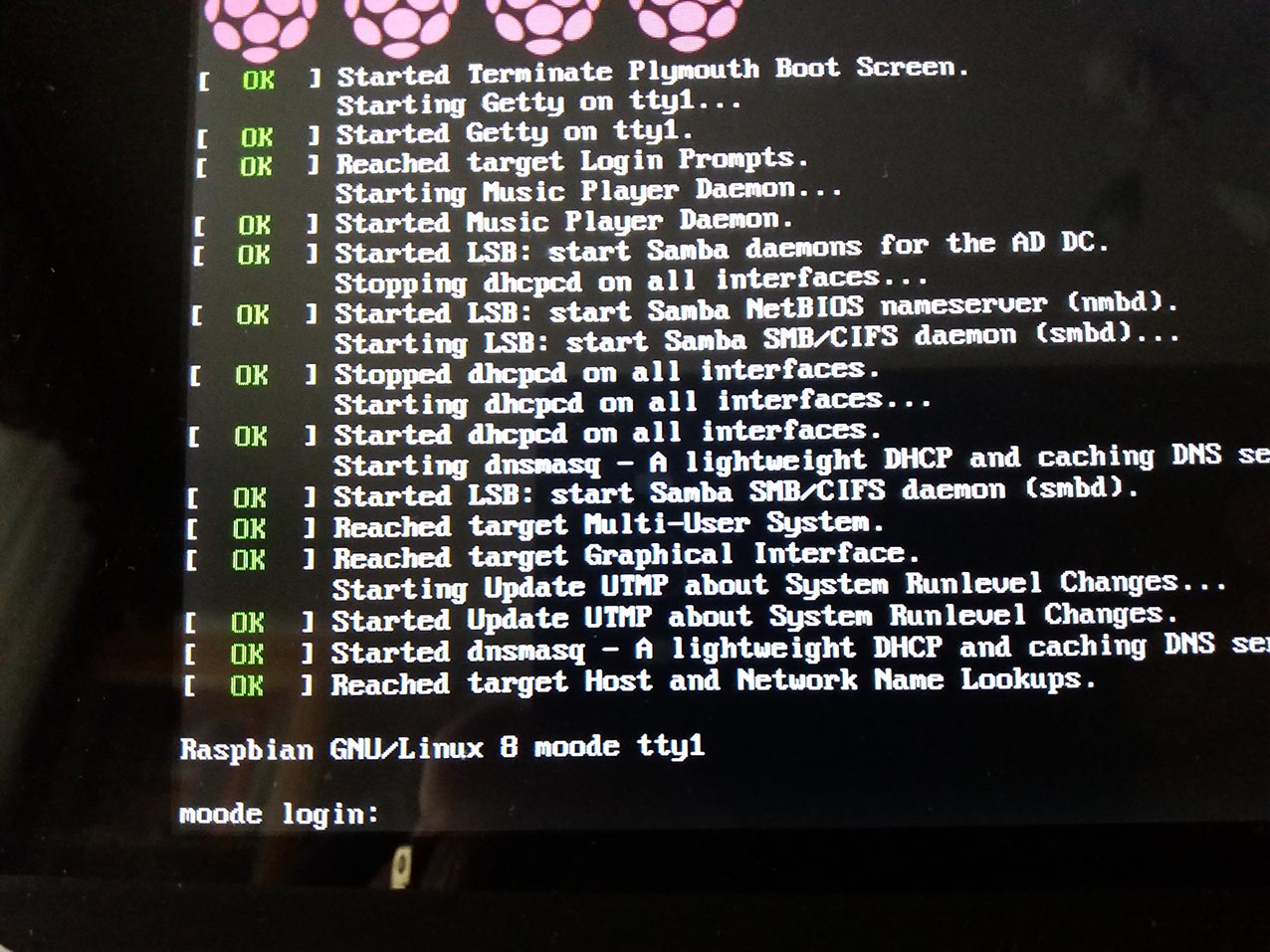

Hello Guys,
Sorry for my English.
I'm tried to connect Official Pi 7 Touchscreen to Moodeaudio 3.1 on my Raspbery 3. I was found the guide from rataks.com and done it step by step. But finally when I boot moodeaudio, at the end of bootscreen on touchscreen, the line "moode login" appears and booting stoped. At this time I can play music and manage it from my smartphone or other devices. What is wrong? The Linux is not my friendly system.

Nothing is wrong. Manage/configure Moode via your browsers. You should not have to login to Moode via the command line.
Enjoy

I undersand this. But why the moodeaudio player screen doesn't appears on my touchscreen?
Moode audio player is a so-called "headless" player. You control it from another browser. It's by design.
Presumably another Raspberry Pi with touchscreen display could be dedicated as a moode controller, though I haven't done this myself.
I think it would be interesting if the moode player with integrated touchscreen could boot into a browser, controlling its player. Having said that, my main argument for an integrated controller had been that my android phone's browser could not find "moode" or "moode.local" and required an IP address instead. But now I've discovered the 'Pi Music' android app (thanks to another post on this thread), which solves that problem for me. Now that my android phone is a convenient controller, an integrated controller is less important.
Also, I think you'll have trouble finding a clean enclosure for Pi + Touchscreen + DAC. You'll almost certainly have to drill some holes.
