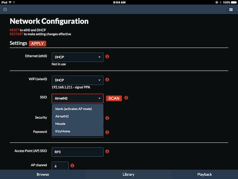

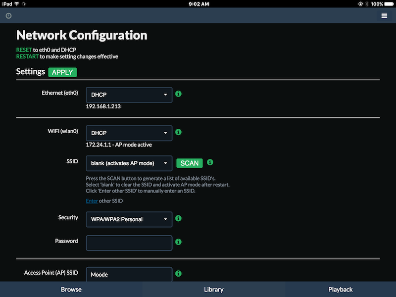

Heres a few more screen shots of the SSID scan feature.
-Tim
